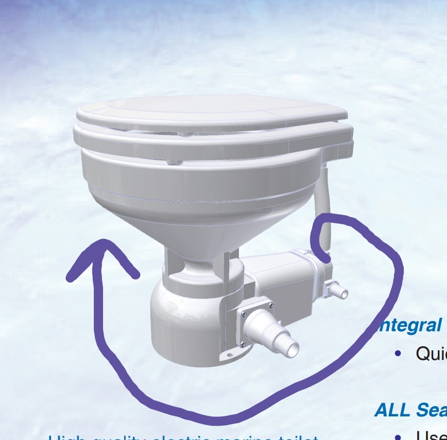

Quick question for folks with the Sea Era in question here: can the bowl be rotated 180 so it faces "backwards" over the pump assembly? That's the only way it'll fit in my space without requiring the hoses to stick out as a tripping (and mess) hazard.
The manual says 90 degrees of rotation but I'm not sure if that's meant as increments or a limit on positioning.
Also, since I'm here (and sorry if this is hijacking - thought to keep on topic in the same thread) am I correct in understanding that the Sea Era's integral pump replaces the external pump necessary on the Jabsco quiet flush? And if so, that the vented loop will have to go between seacock and unit (ignoring strainer for now)? And finally, to confirm Peggie's previous point, that I'll need to pick up a three way switch if using raw water intake, but that it will wire acceptably to the Sea Era control harness?

May 24, 2024
9
Jeanneau 39 Port Dalhousie
Hmmm maybe answering my own question here, but a 180 degree swivel would result in the water inlet being routed around from between my legs to behind the toilet eh? Somewhat awkward...

You may not be aware that the pump/motor assembly doesn't have to come out the back...it can be installed to come out either side of the bowl. The intake vented loop can be installed between the pump and the bowl. It needs to be at least 6-8" above the bowl at max heel, not just when the boat is at rest, which on most sailboats puts it 2-3 feet above the bowl.

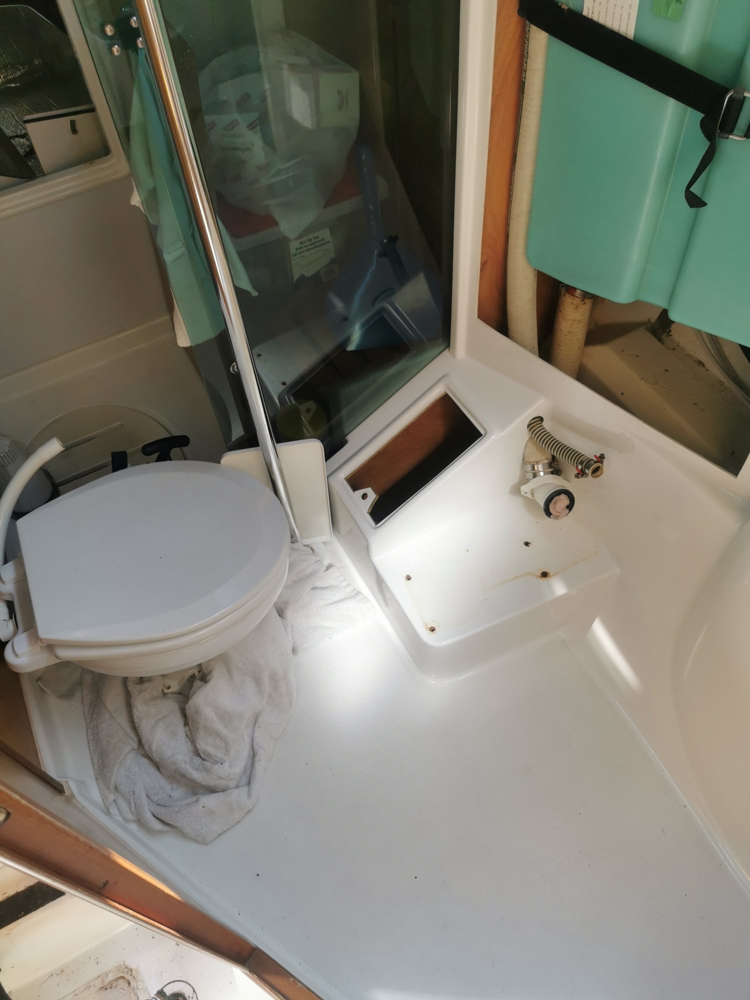

As a follow-up, I ended up going with the Jabsco Quiet Flush E2 Regular Bowl. Big advantage to this model is being able to position the macerator motor in any direction in relation to the bowl and switch discharge to either side. Outlet for the macerator is 1" and the toilet came with an adapter to go from 1" to 1 1/2" which was installed for the manual pump toilet.
I also installed the separate water intake pump ( also included as an option ) for sea water flush. I'm in the Great Lakes so water is actually fresh water anyways.
Toilet fit perfectly into the existing space with only one bolt hole left unused which is the lone bolt in front of the toilet. As usual the boat is turned upside down doing the install accessing areas to run hoses, wiring etc. Vented loop is located in the aft cabin cabinet behind the cedar panels, so had to be taken apart to access.
Toilet works well. Has 3 flushing options, 1 fill & flush for liquid waste, 2 fills & flush for solids and leaves water in the bowl between uses. It also has an option to flush and leave the bowl empty if out sailing. Not sure what the "quiet" option is about, the macerator is fairly loud, but not as annoying as someone hand pumping solids in the middle of the night.
