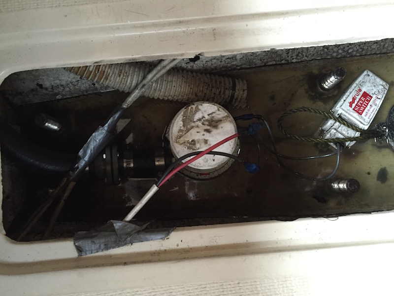

Does anyone have problems with their sump pump priming in the bilge? Mine seems to sometimes get air stuck in it until I push the float switch down a few times to stop the motor running, then it bibles a little bit, then primes after one of the pushes on the float switch and emptied the bilge well. It can run an entire day without noticing, which I'm sure is awful for the longevity of the motor. I discovered this after finding bilge water leaking into the cabin...

You either have an in-line check valve, and should not, or you have a low spot in the hose acting as a p-trap...

That's right, I do have an inline check valve, and it is also frustrating that it doesn't pump out the last inch of water. Although I thought that was because the float switch turns off before it reaches bottom.
So remove the check valve, huh? The pump has its own check valve?

Tradeoffs:
A check valve can prevent the water from coming back in during a big heel.
It also can cause the symptoms you just described.
I'd be looking at the location of the through hull where the water goes out. If you aren't likely to submerge ti much and not for long, just remove the check valve. If it's too low on the hull I'd install a through hull in a better location. Somewhere I even read about a through hull mounted on the transom where heeling wouldn't put it under water. I'm wondering if you could also consider a vented loop.

It's the stock Catalina 30 through hull near the bottom of the transom, never fills with water. The PO definitely made some liberal plumbing decisions in other areas, not always using marine hosing and valves. I suppose I should confirm in the Catalina 30 forum, and maybe just remove it....thanks for the info.

You do not say what kind of bilge pump technology you have, but if it is a cheap Rule centrifugal pump they can "air lock" very easily. Their actual pumping capacity is also below their advertised laboratory-test-derived figure, as well. :( I learned this thru first hand experience.
I suggest changing to a Jabsco chamber type pump. One example:
http://www.jamestowndistributors.com/userportal/show_product.do?pid=9872&familyName=Jabsco+Direct-Drive+Bilge/Shower+Drain+Pump
Our boat came with two of these great pumps, and their internal valve operation acts as a "check valve".
Note B: the Rule pump can also allow back-flooding by allowing syphoning in big seas when the boat is moving fast.
Next, "service" that Rule pump by taking it up on deck and, facing open water, throw it at least 50 feet straight outward. It will do your boat almost as much good there as it does where it is located now.

Every boat over 24 +/- feet with a bilge & cabin should ideally have a dual pump configuration. I have been harping on this for years but folks rarely go for it.
Pump #1 for a 30 footer would be a 2000GPH+ centrifugal style "oh $hit" pump with the bilge switch mounted slightly higher than the primary nuisance water pump.
The nuisance water pump should be a diaphragm style pump for dealing with nuisance level water. Diaphragm pumps can use check valves but don't normally need them as they tend to self-check.
Premium bilge switches like the Ultra Pump Switch Jr. or Sr. should be used with both pumps.
These problems are generally related to a number of issues:
#1 Poor bilge switch chosen for the task - Ever since the removal of mercury from the Rule etc. float switches the reliability has been about as good as a Yugo and they tend to last about as long as a bag of Doritos at a Grateful Dead concert.. How to Rx? Don't buy unreliable products. The switches from Ultra Safety Systems are about as reliable as they get.
#2 Inadequate bilge pump system design - A good bilge pump system makes use of a "nuisance pump" which is a diaphragm style and a second emergency pump or oh $hit pump which is a high capacity centrifugal type. The nuisance pump does all the routine work and the oh $hit pump is used only in emergency situations and the switch is mounted slightly higher in the bilge. As a bonus a manual "gusher" style pump should be installed with a cockpit handle..
#3 Improper system design and install - Centrifugal Rule type pumps should not have check valves installed in the outlet hose. Check valves are a band-aid at best and owners and even builders often choose them over a proper installation but should not. They are flat out dangerous at best, and battery killers at the very least. It's one of the number one causes of destroyed battery banks other than cheap bilge switches I see. Centrifugal pumps should also use smooth walled hose, utilize a siphon break and have as few bends as possible. The discharge should always be above max heeled waterline in a well designed system. Wire should be sized for the least voltage drop to maximize performance. Centrifugal pumps will never pump anywhere close to their rating "as installed" so the biggest capacity oh $hit pump you can fit is the best choice.
Best bet to avoid these issues:
Install a well designed bilge pumping system utilizing a nuisance pump (diaphragm type). Use quality bilge switches such as those by Ultra Safety Systems, use sufficient wire for minimal voltage drop, use water proof splices for all wiring terminations, make all terminations above bilge height when ever possible, fuse the pumps per manufacturers recommendations and do not use a check valve on any centrifugal type pump. Check valves are fine on a diaphragm pump but a very bad idea on a centrifugal bilge pump...
