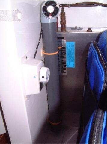

Another use for these small computer fans
This is a 2" diameter fan that I cut to fit inside of a 2" PVC elbow. Connected to a vertical tube it pulls cold air from the bottom of my refrigerator and blows it across to the opposite side.
Very effective in promoting a uniform box temperature.

Question for Rich
Rich: Interesting fan idea. I currently use one of the camper variety that uses 2 D cell batteries to do that. Eats batteries. Does yours use the 12V boat system? How did you route power to the fan?
Bruce- Yes a 12V fan. Power taken from the 12V input to the compressor unit and the very small power wires routed along the refrigerant lines. It runs 24/7 when the refrigerator is powered up.
I originally tried the camper style fan to see if it would work. My design works much better because it pulls cold air from the bottom and shoots it across the top of the box to the opposite corner.
