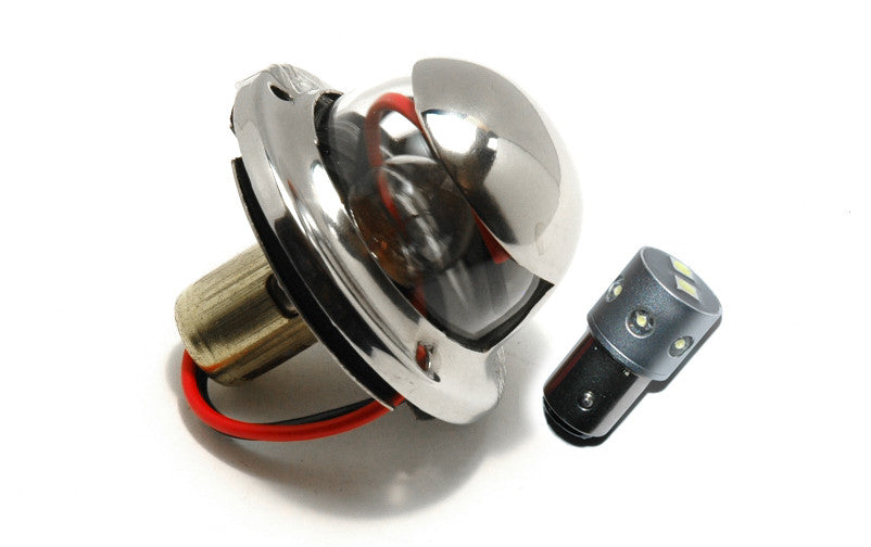

Looking at the mast photo, ids the hole about half way up the mast? If so could it be a steaming light? If so can it be turned on and check if 12 volt electrical is on?

Getting back to the original poster's questions, mostly because I find this thread so interesting.
Why do I keep finding electrical wires - positive and negative - both the same color?
Because they go to loads (devices) for which polarity doesn't matter, like incandescent light fixtures.
I’m trying to contact a new mid-mast nav light but can’t connect it to electricity until the mast is up, any suggestions?
If it's an LED fixture for which polarity matters, just connect it to the two blacks arbitrarily, and if it doesn't light up when the mast is in and wires connected, just swap the two wires going to that fixture.
If you don't know the correspondence of wires from the device to the base of the mast, then you need determine continuity as others have suggested. But, that should already be marked or use keyed connectors, as it is really not related to replacing the device.

OK... Let me reflect on what I think you are telling us.
Your MAST in laying down across your boat so you can work on it.
You removed an old fixture that was in the middle of the mast. Most likely a light that looks something like this...
You want to replace it with the same to fill the hole but the wiring is confusing.
Ok. Builders (also Previous Owners) on some boat electrical projects took short cuts. They ran a single hot wire up the mast connecting the various loads (light bulbs) in series to the hot lead. They did not concern themselves with wire color. They used was readily available. Black worked the same as red or green. This also saved them on the cost of switches. One switch all lights on the mast come on.
If you want a different setup that works better on "your" boat (a good idea), then follow the suggestion to use the existing wires to pull new properly colored wires up the mast. Be sure that you plan the whole system. You only need a single ground wire (now usually yellow - or old school black) if you are planning to use LED lights or lightbulbs for a multi light fixture on the mast head. You will need a ground wire for the mid mast lights (ie steaming or deck). You will need separate load wires (red wire) to match the number of switched circuits you want. ie: Spreader Lights, Steaming Light, Anchor light, Nav lights...
