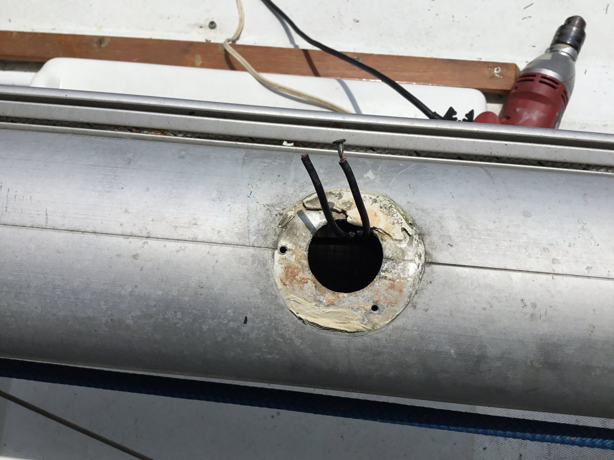

Dear Sailors,
Why do I keep finding electrical wires - positive and negative - both the same color? Is someone trying to spoof me? It’s easy one red, one black but no, that’s too easy! I’m trying to contact a new mid-mast nav light but can’t connect it to electricity until the mast is up, any suggestions?

That looks like it may be the pigtails from a fixture. They are both regularly black because in an older incandescent fixture it didn’t matter what polarity the fixture had. If there is slack in the wires you could try and pull them up a bit to see if where they connect to the main wiring giving an indication of polarity. Of course if a PO re did the mast wiring all bets would be off as to colors. You could try checking wire color at the base of the mast as well to see what you have.

if You have some wire, you can connect it to one of the 2 wires at the base of the mast, then lay it along the mast to the mid-mast wires…the use a DVM to check continuity on the 2 mid-mast wires…put some tape on both ends of the one that shows continuity.
Just need enough wire (almost any old stuff will work…thermostat, speaker, doorbell,) To get from the bast of the mast to the midpoint.
Otherwise, if the wire looks old, brittle, etc…do as @capta suggested, and run new, using the old wire to pull the new stuff through the mast.

Interesting replies. If it's for a mid-mast nav light, as you say, it doesn't matter - there is not polarity, it's just both sides of a resistive load. If you go to LED bulbs it will probably matter. But, in that case, you can just reverse the connections.
So, one wire will run to the switch or breaker that provides the positive potential, and the other will run to the ground - hopefully a bus bar. And that's all there is to it! No need to pull new wires, pull these out, etc., etc.

Greg, what would he be checking for? If both wires are to either side of an incandescent bulb, there is no polarity!

If it's an incandescent bulb, there is no polarity. One wire goes to ground, the other to +12V, and that's it. It will matter if you go to and LED bulb, but then you just reverse the connection.

Connect the mast to ground. Use the mast as the ground on your multi-meter setup for a continuity test. Your meter should indicate no continuity if both ends of the wires are clear of the mast, and there are no exposed contacts inside the mast. The meter shouldn't do anything, just as if the two leads were not touching anything.
Next, connect one end of one wire to ground, the mast, in this case. Now test each wire at the other end for continuity to ground again. Only the wire touching the mast should show continuity to ground. Mark both ends of the wire you tested. Then disconnect the wire and repeat with the other wire to be sure it also has continuity.
This should give you the information you need and tell you if either wire has a break or shorts to the mast somewhere inside. No power supply needed.

And, why does that matter?
All it's telling you that you have the DMV's positive lead on the side of the load that's connected to the plus side of the feed. It's neither correct nor incorrect. If you just swap the DVM leads it will change the negative reading to positive, and - it doesn't matter!

Common, accepted practice for wiring devices on a mast is that each resistive load (device) has two wires, one connected to ground, usually at the base of the mast, preferably a ground bus bar, and the other connected to the supply for that load, via a switch or breaker. Unless the load is sensitive to polarity as some (not all!) LED replacement bulbs are, it doesn't make a difference. And, if one doesn't come on, just swap the wires. Or swap the orientation of the bulb if it's a festoon type.

Just continuity, so he can pick both ends of the same wire…which he seemed concerned about.
