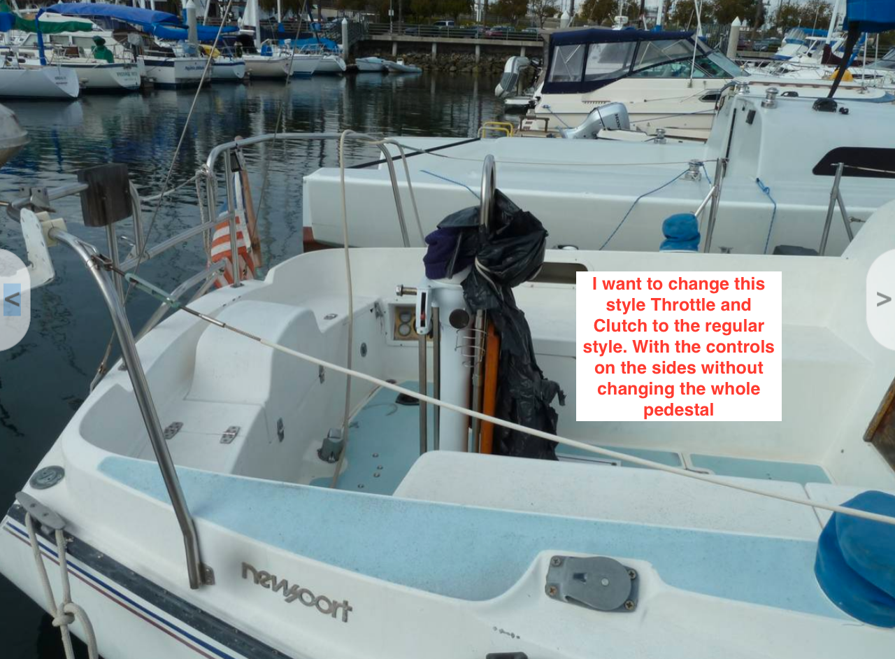

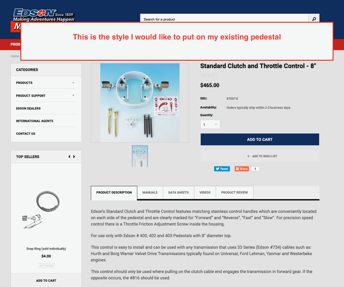

I have a 1983 Newport 33 with an odd style Edson pedestal. Odd being the controls are on port and starboard but they move up and down. Ive attached a picture of a similar boat with the same pedestal. I'd like to change the throttle and clutch to the standard chrome handles on port and starboard that move for and aft. (see pictures) Does anyone have any idea if this will work or what kind of can of worms Im opening? Thank you! -Jeff

First, check the engine manual to see if there is any reason the change can't be done. Some engines, like the Yanmar 3jh2e can not use the separate controls because there is not enough leverage. Next check to see if the top of the pedestal comes apart. Aluminum, SS bolts, and saltwater often make this difficult to impossible.
If the change is possible, then longer cables will be needed and new holes may be necessary cockpit sole for the cables. And then there are the 2 holes in the cockpit sole that will need repairing.
That's a lot of work and expense for not much gain.

Also check if your transmission and motor throttle connections are oriented the same way the levers are labeled. You may want to look at a single lever dual function assembly instead. Lewmar makes one that attaches to the side of the pedestal guard tube and it may adapt to your pedestal.

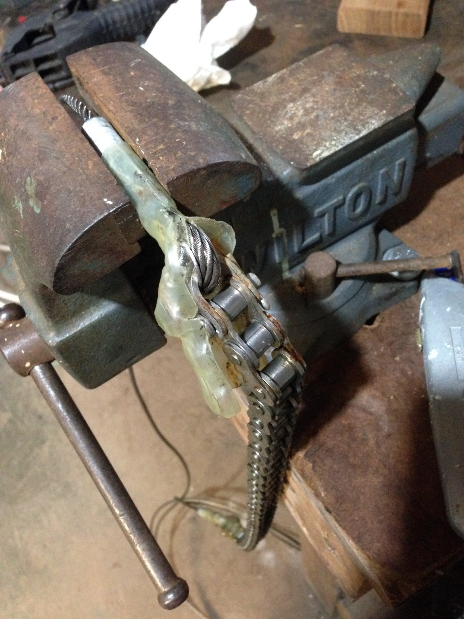

Once you dive into the steering cable rebuild, it is pretty obvious. The cable has an eye swaged into one end that is connected to the chain. The other end is run through an eyebolt on the steering quadrant and secured with 2 or 3 bulldog clamps. The swaged end is covered with some heat shrink to protect the coupling to the chain and to make it harder for things to snag on the swage. See the photos. If the chain is in good shape, it can be reused, if not, measure it and buy some new chain from McMaster Carr.

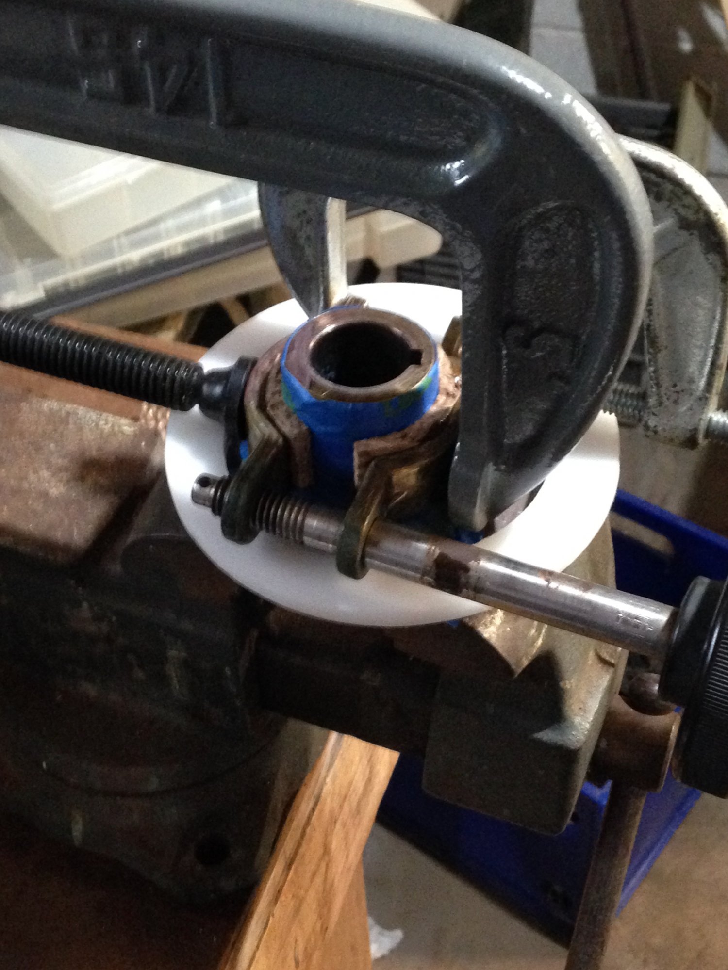

While you have things apart, replace the pads on the wheel brake. You can buy the whole unit from Edson or you can buy some brake lining from McMaster-Carr or an auto parts store and make your own. I used Gorilla glue to secure the pads to the clamps. The only tricky part was getting the pads to conform to the curve. My solution is in the photo. After the glue cures, trim the pads with a band saw. I used steering wheel axle as a mold for the brake pads. It was covered in tape to prevent any squeeze out from getting on the axle.

So I spoke to Ken at Edson, the upgrade to control head is possible but the controls will be backwards. I’m thinking I can rotate or flip the control head to correct that. If I can’t I’ll need to make two bell cranks to reverse the throw.
