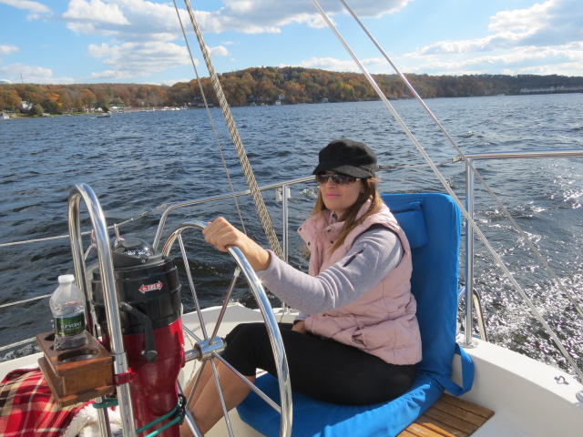

Thanks, but no; the pod I'm talking about replacing is huge, like this:
As I stated, my 5'2" wife can't see over it. It just completely blocks her view. I want to go to a standard guard, and use Edson arm-mount pods on both sides, one larger one for a 7" chart plotter, and a a single instrument one for the autopilot controller, or something like that.

Why not just cut the one you have to a lower height and add the side arms?

The one I have is bent forward, to give the right viewing angle with a pod. See the pic, above.

I cut them to an owners desired height all the time. Sadly too few installers ever do this. The viewing angle does not change just cut 3-5" off each leg bottom and bring the bottom of the pod closer to the compass..

Bend it more to lay flatter then make wedges to correct the viewing angle to the pod.
