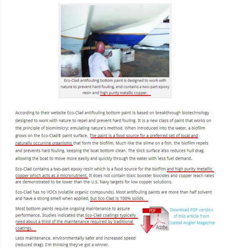

After recovering from the sticker shock, I decided to look up the operating principle of this latest bottom paint miracle. Without wanting to appear too harsh IMHO ........ "ABSOLUTE SNAKE OIL".
I took just one page out of their fact filled write-up and almost every other line is a complete contradiction of what we know about anti-fouling paint. We've got everything from bugs who love to eat the epoxy resin in Ecoclad to high purity copper which is a nutrient for the bugs. Boy, I'll bet that tastes good :D.
I think we can put this in the same bucket with Coppercoat bottom paint which we ultimately learned (from the fine print) has to be "burnished" four times per year to remain effective.
I wonder if the guys who dream up this stuff used to be hedge fund salesmen :confused:.
