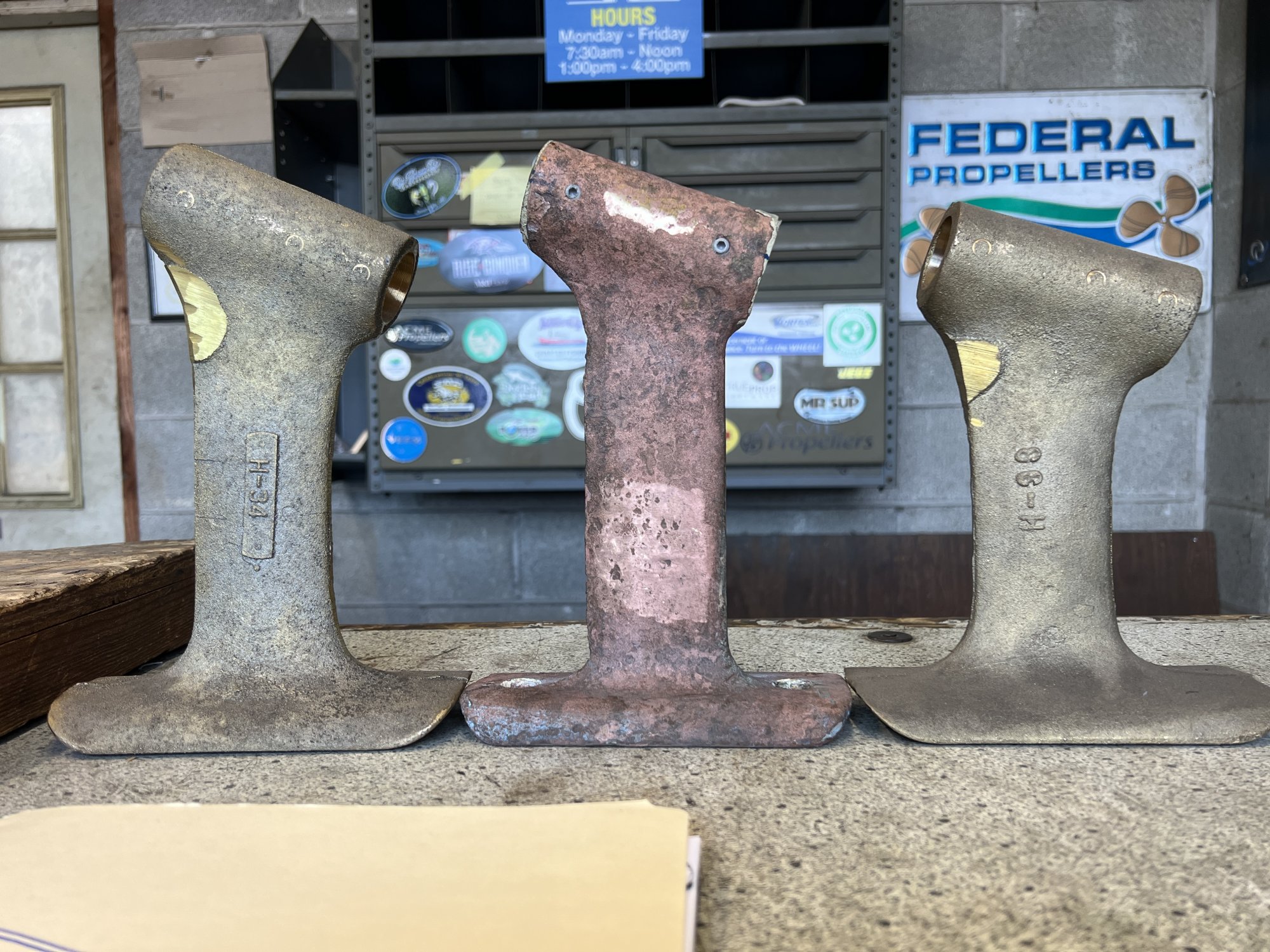

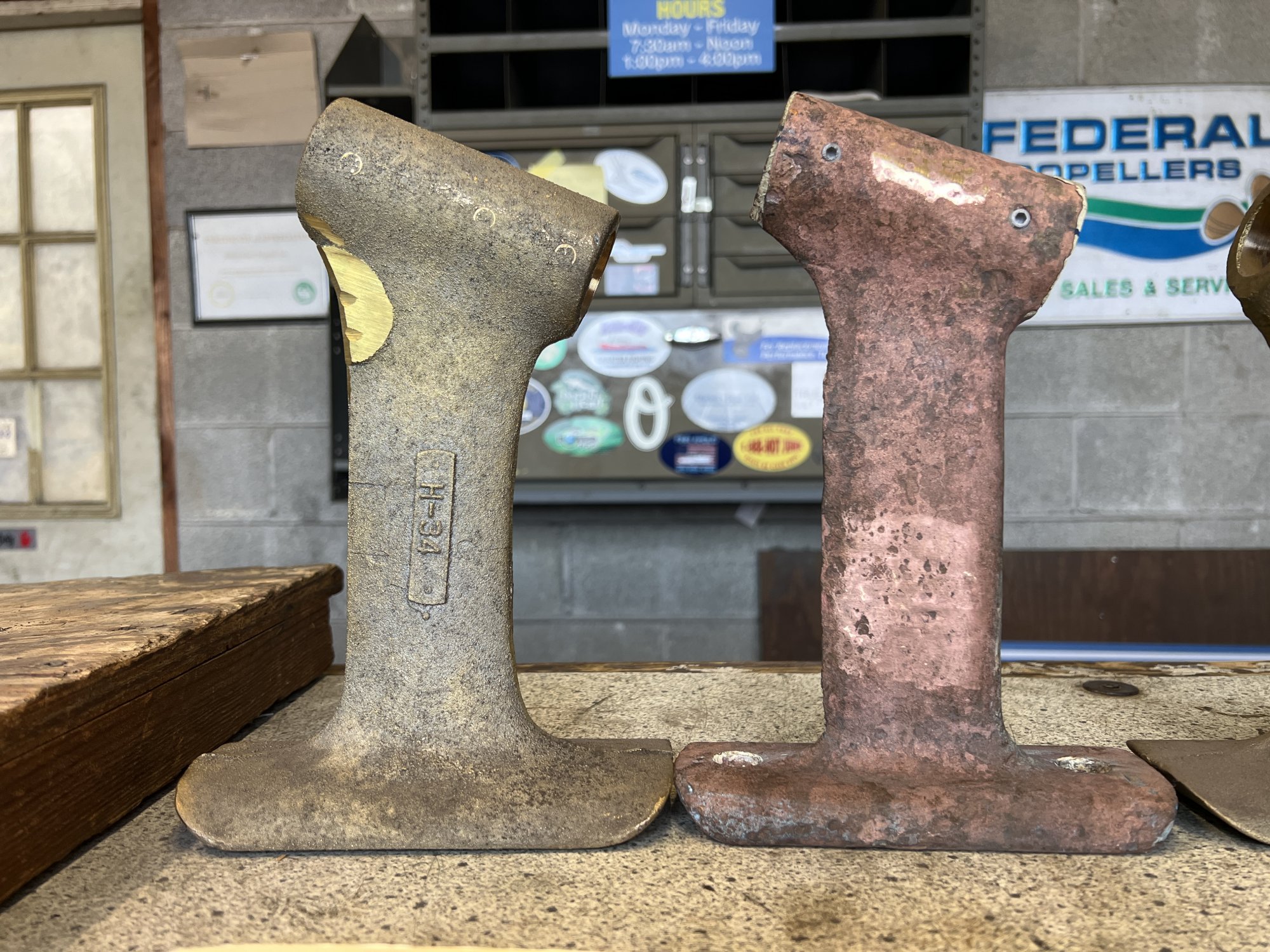

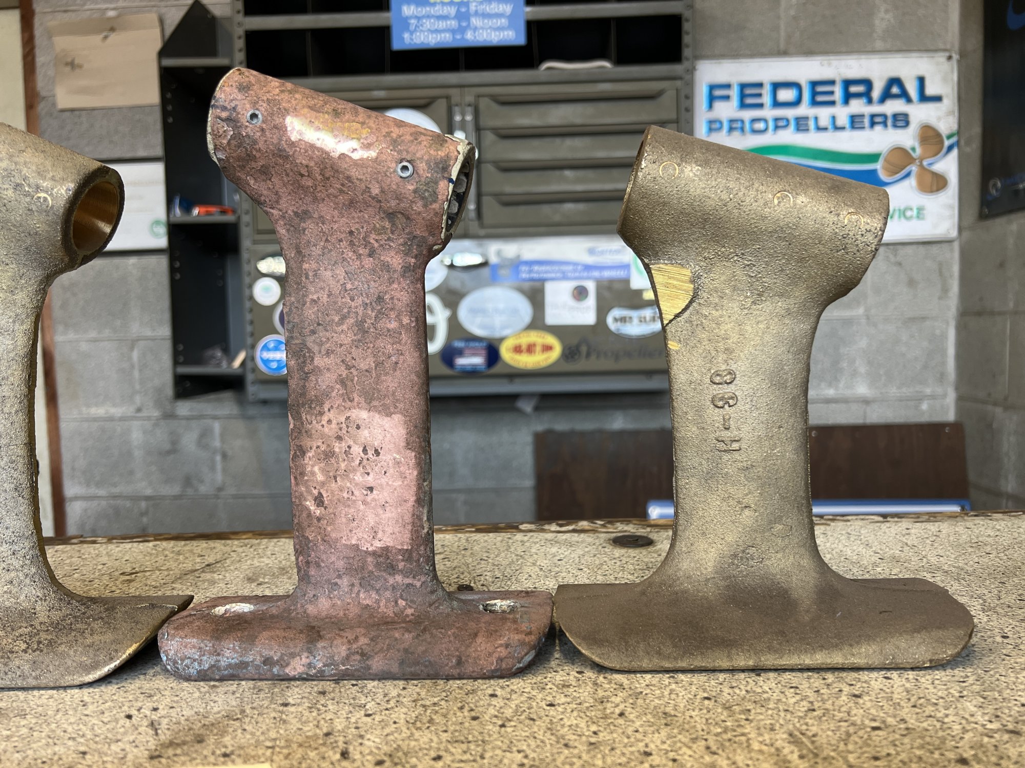

We're in the midst of some winter projects, one of which is replacing the now 42+ year old prop shaft strut. Living in Maryland we are lucky in that Miller's Island Propellor shop in Baltimore still carries the struts. In case anyone has done research and found the information on SBO's website to be confusing, fear not, it is confusing and incorrect.
I went to the shop today in Baltimore and the foreman concluded that model H-34 (to the left of my pink strut) is the proper model number (not H-33 which is to the right) to be used to replace the stock version (at least that is the case for an early 80's H36 sailboat, ours is an '82). The dimensions on the website (including those from Dahler Marine which was the OEM supplier) are incorrect. Here is a snap shot of my old and completely galvanically compromised strut compared to the H-33 and H-34 models. Note the new versions are in an "un-processed" condition, they still need to be cleaned up quite a bit. Hope this helps.

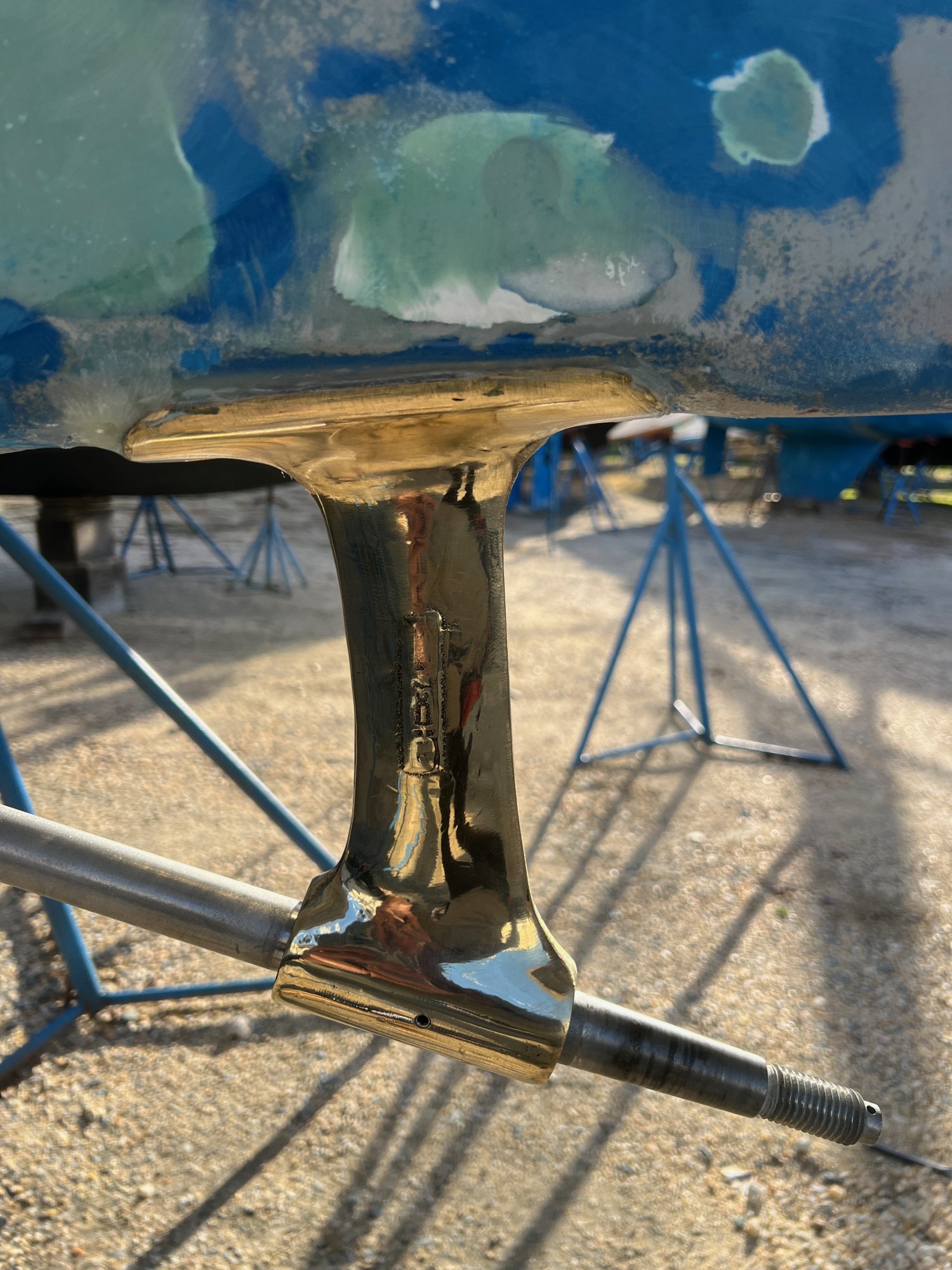

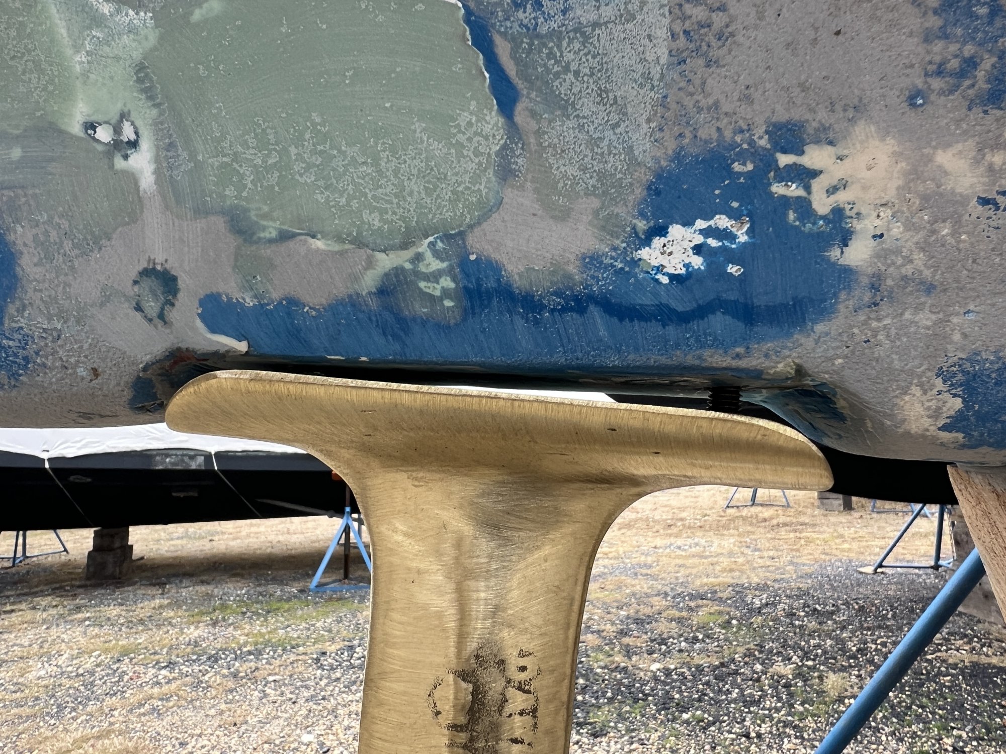

It doesn't look too healthy.
Any chance you could scrape the surface of your old strut to a few 0.001" and show us what it looks like under the pink skin ? It would be interesting to see how deep the dezincification goes.
Thanks if you would.

Good information. You might want to do what I did and fit a small mushroom zinc on your new strut.

I can certainly grind down some of the strut when I get it back, but the pink is pretty deep. You can kind of see it on the picture, I sanded a small area on the flat part....but I'll inquire about attaching a small zinc to the strut.

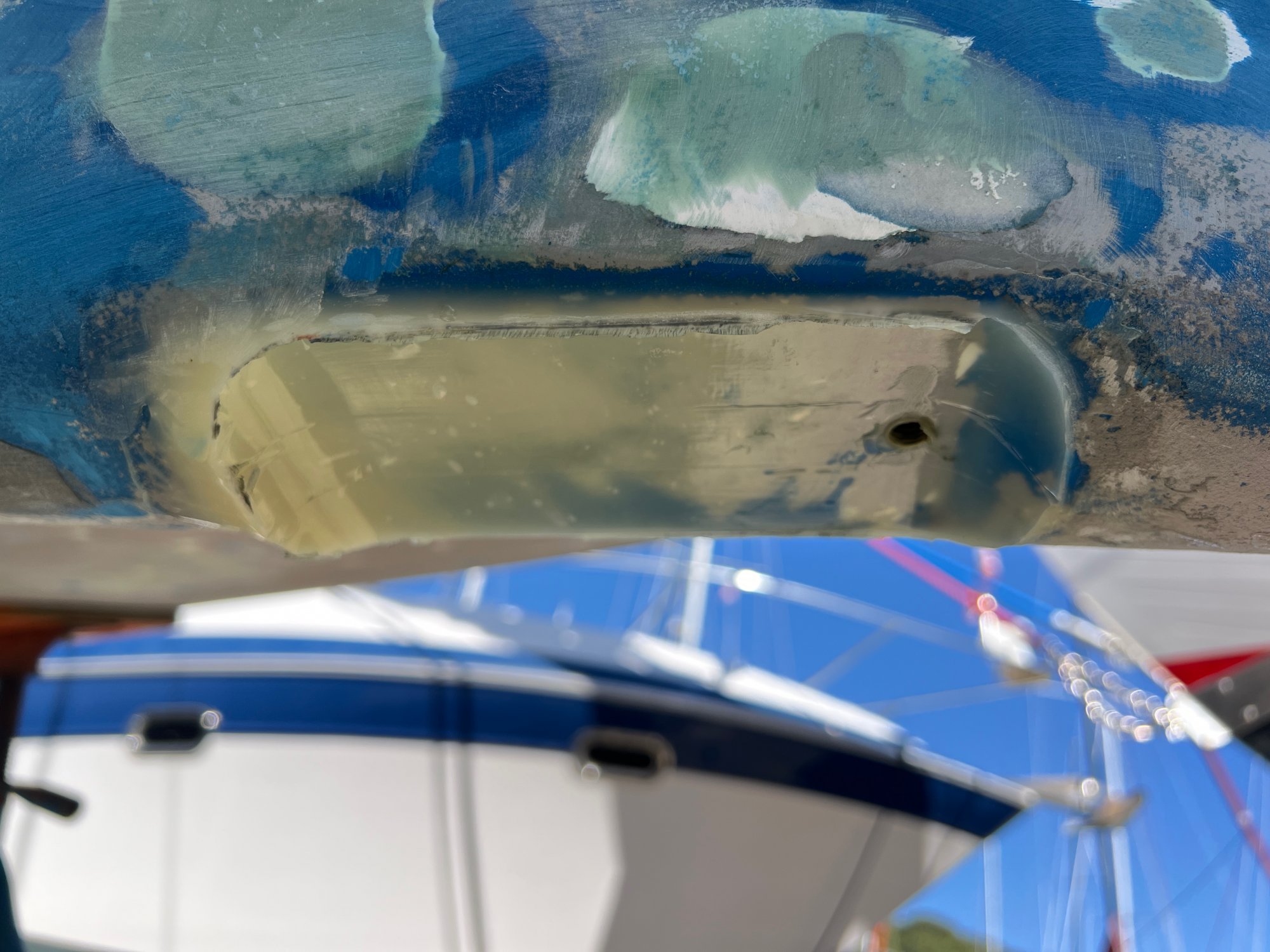

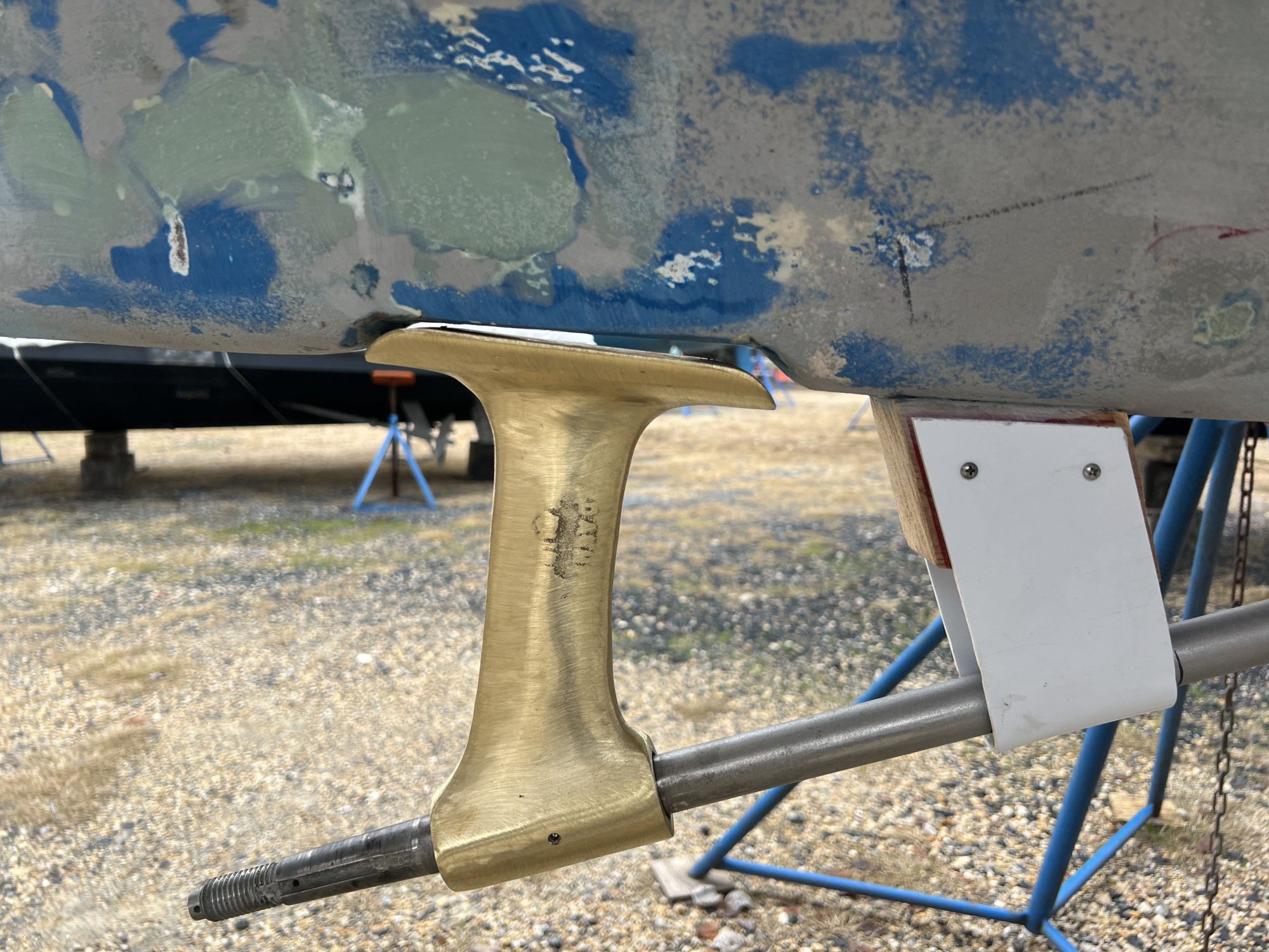

Whelp. This continues to be a saga. Received the H34 strut today. It’s not a perfect fit. Seems as if the angle is off. So it looks like I’ll need to fill in the gap with dynaglass as well. Although my new strut angle is different than Rardi’s in the opposite way. I’ll need to fill in the gap towards the front of the strut base. I don’t think I’ll want to adjust the engine that much. Fun times these old boats. Oh, did I mention after blasting off all the old bottom paint I also have a huge blister project to contend with? It’s been a great start to 2025.

Just to recall a few of the specifics of my strut replacement that I posted about many years ago:
- Before applying the Dyna glass, first put the packing tape on the mating surface of the strut. By doing so, the Dyna glass will adhere to the hull. But not to the strut. So the strut can be disassembled later.
- During the process, the Dyna glass will squeeze out. Wait until it begins to set up but it is still a little bit flexible. At that point use a utility knife to cut away the excess. Will save a lot of time having to grind away later!
- If the hull/strut bolt holes have not yet been drilled in the strut, after the steps up above are done, align the strut, then from above through the existing holes in the hull, drill down just enough to mark their location on the strut plate. Remove the strut to say a vice. Then you can complete the drilling.

Looking back at my picture of the three struts next to each other, the H34 sits at about 23 degrees, the stock strut I had is at about 19 degrees and the H33 is about 15-16 degrees. Not sure why your model had the H33 and mine had the H34 - those two are about a few inches different in length as well. The Dammer catalog specs are not very close....I had holes drilled in my new strut so will need to address that when I lay up the Dyna Glas.
One more note of interest, I weighed the new/old struts, new one is about 1.3 lbs heavier than the old one, so it lost quite a bit of weight over the years of slowly corroding away!

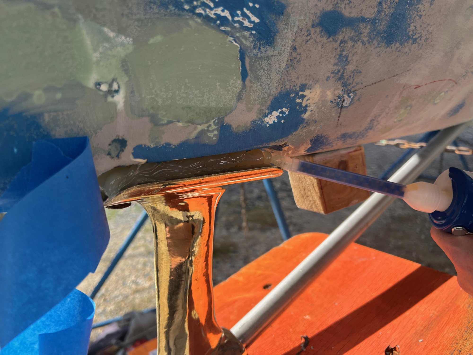

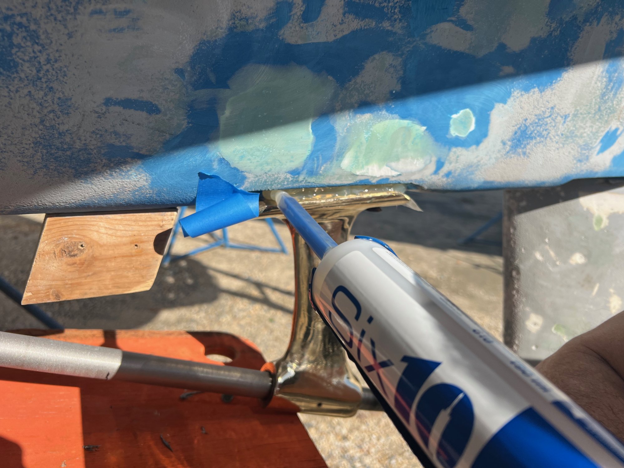

Finally had time to finish this project...mostly. Because we already had the holes drilled in the strut I needed to use at lease one bolt to line up the strut to the boat....and I needed to use the bolt that would get the strut the closest to the boat in order to squeeze out the most of the gap filling putty - in my case it is the aft bolt hole. This made using the Duraglass a little bit more challenging as a gap filler. Plus I clearly used too much hardener because the mixture kicked off way too quickly before I could line everything up and get inside to tighten the one bolt in order to squeeze out the excess....so round one was a bust. Luckily I was able to remove all the Duraglass material and start over.
My wife suggested we use something that we could inject into the void once the strut was lined up and mostly attached with the single, aft bolt. I had used Thixo and SixTen Epoxy before with much success, so that was our decision....off to West Marine for a tube.
We attached the strut and I tightened the bolt almost all the way....then injected the epoxy into the void, ensuring I had plenty of coverage. Once that was done I simply crawled in the engine bay and tightened the aft bolt/nut of the strut and all the excess squeezed out. Of course this had to sit overnight to cure.....now this is where I made an almost egregious error. While I did use smooth packing tape on the top of the strut base, I should have also used some wax or other release agent....because the next day after it cured the strut was VERY well attached to the boat! Even though it was smooth, epoxy is still able to adhere pretty well to the tape....so I had to break out the torch again and gently heat up the strut; after a few minutes I was able to remove the strut from the boat, leaving behind a nice custom form/mold at the correct angle. Close call for my stupidity. I just need to drill out the forward hole in the boat and then bed the strut in place.
So it would appear Duraglass or Thickened/Injectable epoxy will work. Plenty of working time with the epoxy and you can really smooth it out once it is set in place. Just be sure to use a proper release agent!
