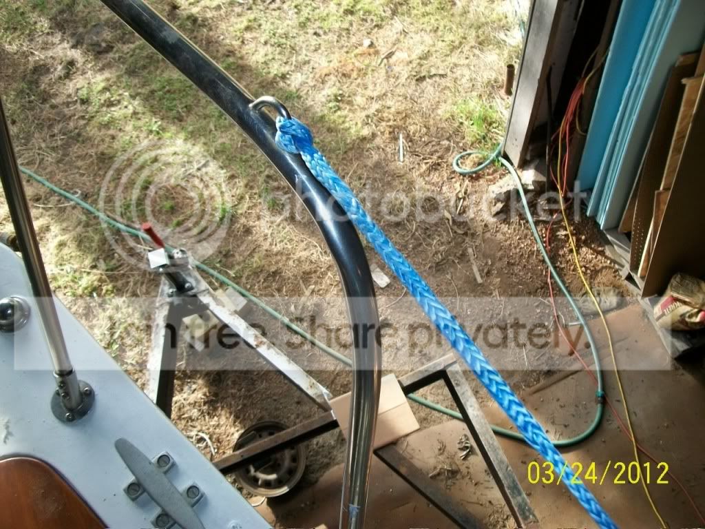

On the Bow Pulpit I made a Brummel Splice and luggage tagged it to the loop...

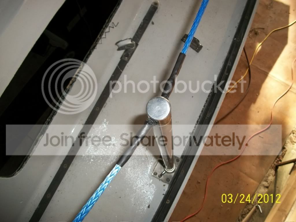

Strung it thru the stancions and put on a layer of "tubular webbing" chafe guard and secured loose ends with a piece of shrink tubing...Keeps the webbing from unraveling and helps it slip thru the stancion when I un clip the line...

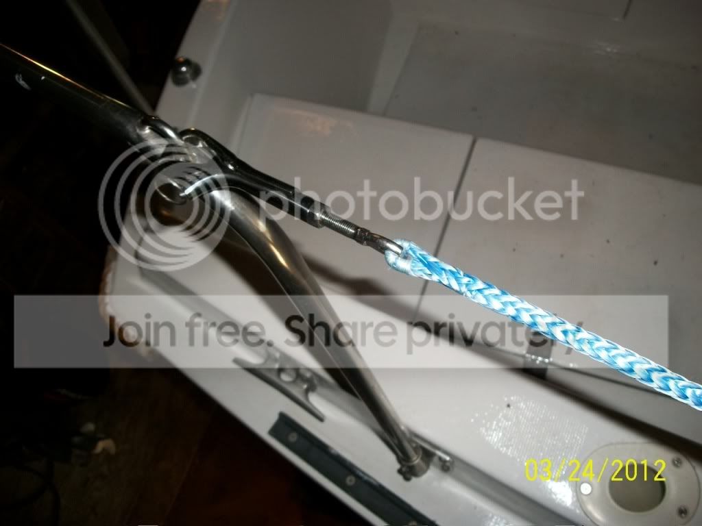

On the stern pulpit I used a pelican clip, ordered in an SS eyebolt of correct thread... I double whipped the loop of the eye with Dacron to cushion bend and attached with a regular push splice cross sewing to keep it from pulling out...
Pulled tight when I marked the loops and still have a few inchs of threads to adjust tension on Pelican Hooks...
