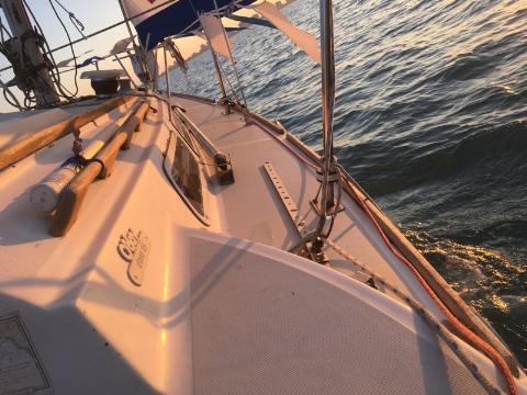

I have an old Hood furler. It looks the same as this Hood Seafurl 800 Bearing Replacement. I'll get some pictures posted early next week

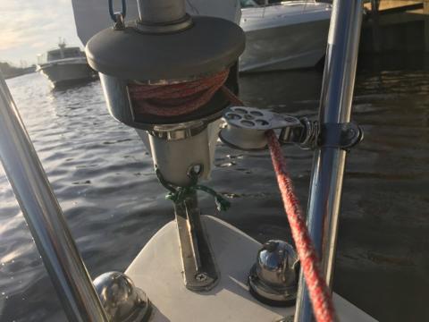

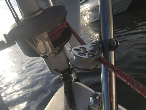

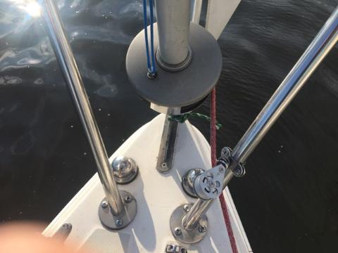

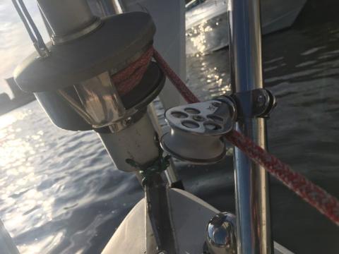

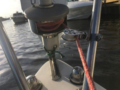

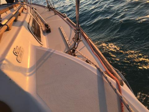

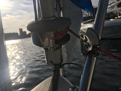

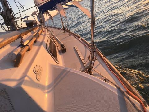

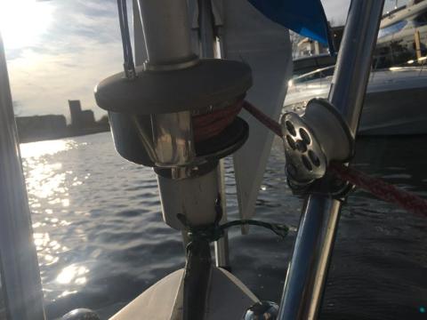

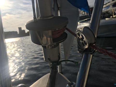

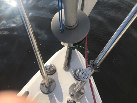

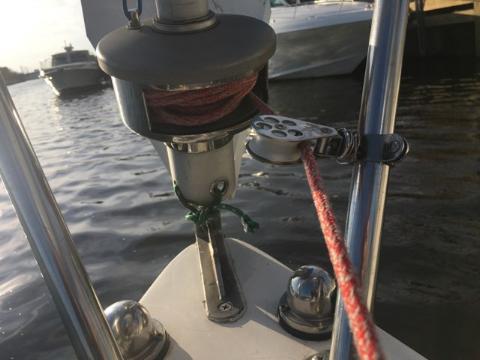

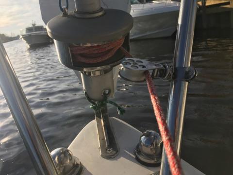

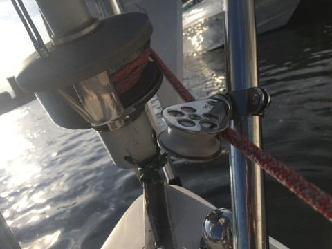

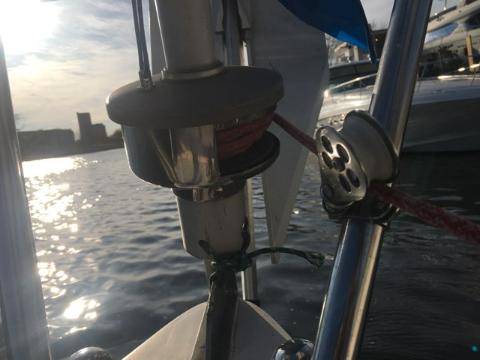

A picture of the drum filled with line would be helpful. Include the lead block in the picture so we can see the angle.
13,547

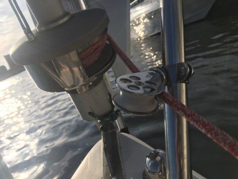

Image_6015 shows the start of the over wrap. That is likely the cause of your issue. The block also keeps twisting, not sure what the cause is, it might be related to the over wrap. Lowering the block an inch or so may help the feed.
A new spring, if one can be installed might help prevent the block from twisting.
Replacing the line with dyneema, won't improve things.
  • Helpful
23,848
Watching those images in sequence, I agree with @dlochner observations. The spring block is not helping you. Perhaps it is too close and a little low to the furler drum.

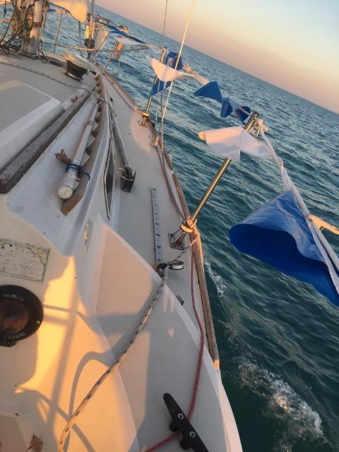

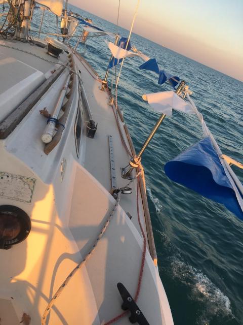

The spring in the spring block is broken in multiple places so there's zero springiness left. You may or may not be able to see the marks on the pulpit from various positions I've tried. this block seems almost pointless since it has very little restriction. The line pretty much goes where it wants on the drum. @rgranger's suggestion for hardware might also work. I can try that in the spring

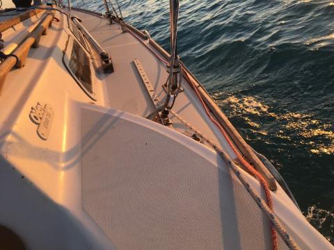

As for the distance, I have the option that you see in the pic and about 14-16" away from the drum. If needed I can probably fabricate something to get the block in between those distances. What is a recommended distance?

It looks like the pulpit stanchion would interfear with that furling line no matter what. Is this true? I might say that if the furler wound the other direction, or the if furling line were on the port side of the boat, with the same wind direction on the furler, it would work better; the forward block would have tension and orientation provided by the furling line the spring would not be relevant.
Also it looks like the furler is outside the lifeline stanchions. If so, why is the last block inside the stanchions? You could replace the last block with a fairlead, however, I think that it would still have a winding problem as it is too close to the spool.
I'm not sure what you mean by interfere. When the furling line is pulled (to furl the sail) the block stands up. I honestly don't know how much benefit the spring will provide if replaced. The issues occur regardless of which way the wind is blowing.
The stanchion blocks wrap around the stanchion. They are ran on the outside because of the curve of the boat. If I ran them on the inside, the line would rub against the "fairlead"/retainer on the block. If the spring block was ran on the outside, the line would push against the metal of the block and try to "collapse" or bend the spring. What is an acceptable distance between the spring block and spool?
Do you furl into the wind or off the wind? Try on a beam-broad reach with very light back tension on the sheets.
The last guide is too close. No chance for the line to fan out. Can you move it back to the next rail and still maintain 90 degrees? If not, mount a fair lead to the toe rail or deck. It does NOT need to be a pulley type, just at the right place. Low friction rings work.
Also, the line is too large. Looks like 5/16, not 1/4 (easy to confuse). I use decored 1/4-inch stayset on my F-24 (overlapping jib). I used decored 3/8 Samson XLS on my PDQ 34 (large genoa). Decore the front 15 feet of so. The blog you mentioned showes decored line. Your line is way too fat. Finally, forget "fuzzy" line and get something smooth, like Stayset. Fuzzy line loves to tangle like that and the friction is too high. Wear gloves. You do not need Dyneema for a boat this small--the load is not that high.
Is it possible that it was set up to furl the other rotation? Remember, furlers can go either way, based on which side the UV cover is on. There is nothing sacred about CW vs. CCW. Maybe this is not the first jib.
Sounds like it was set up wrong from seller. Not unusual. The cure to many running rigging problems is smaller line and simpler blocks (fewer swivels--the shackles are usually enough). "Fat ropes" is a common rigger's curse.
(The blog with the Hood instructions is mine. The lead is higher--it is slack in this image because I am loading new line. The hitch is not required, but it helps take some load off the knot, and the decored line makes a tiny knot. You really do not want to run all the line off the drum anyway.)
I believe I can. I will definitely try in the spring. The next rail is around 14-16" away from the one it's on now. It was originally on this one when I got the boat
