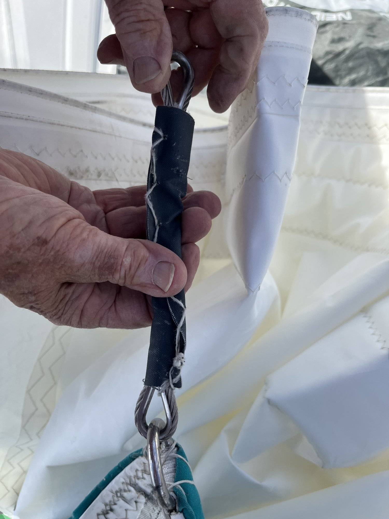

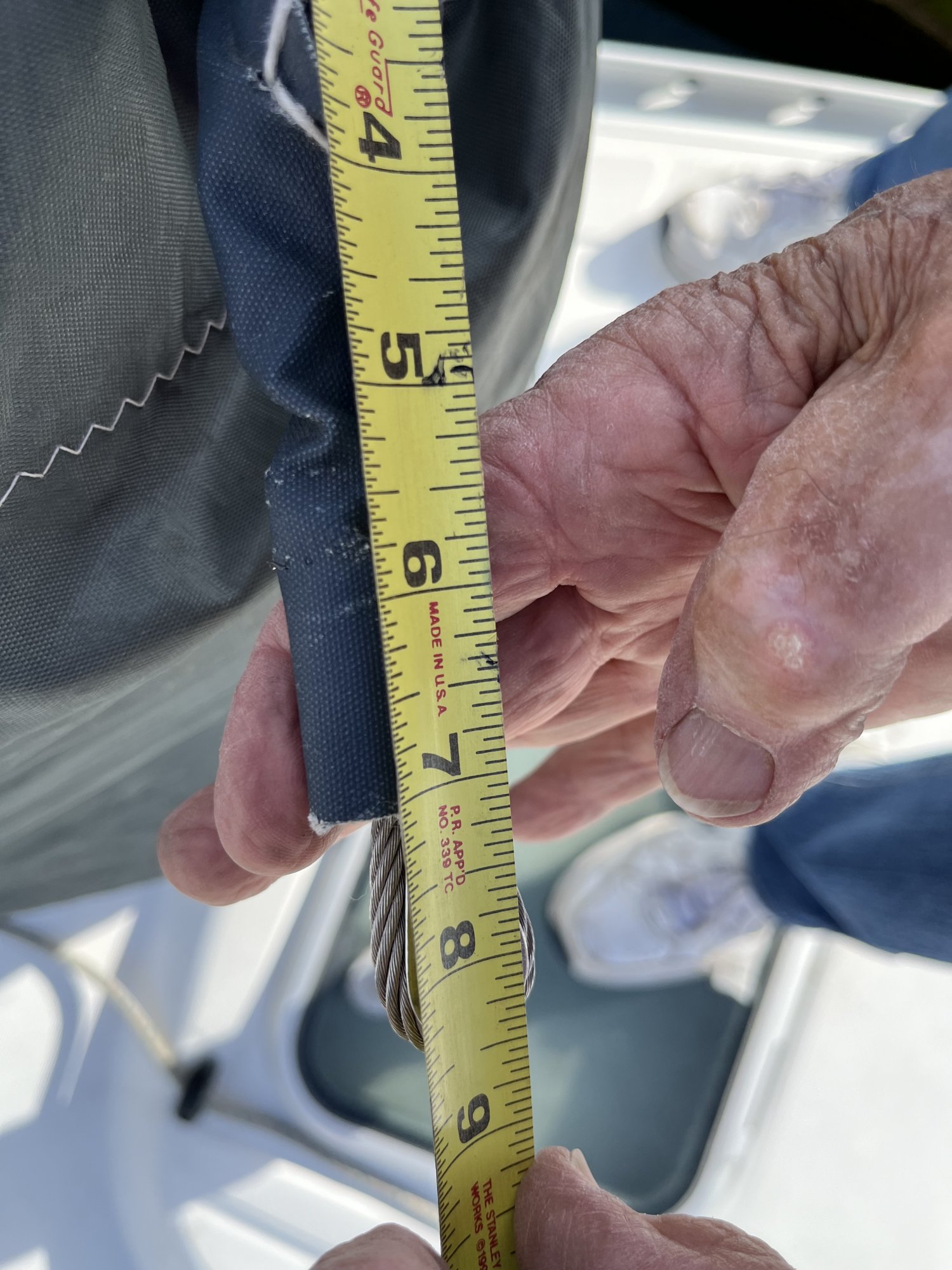

Any suggestions on how to replace this with Dyneema? It’s 8 3/4” with an eye on each end.

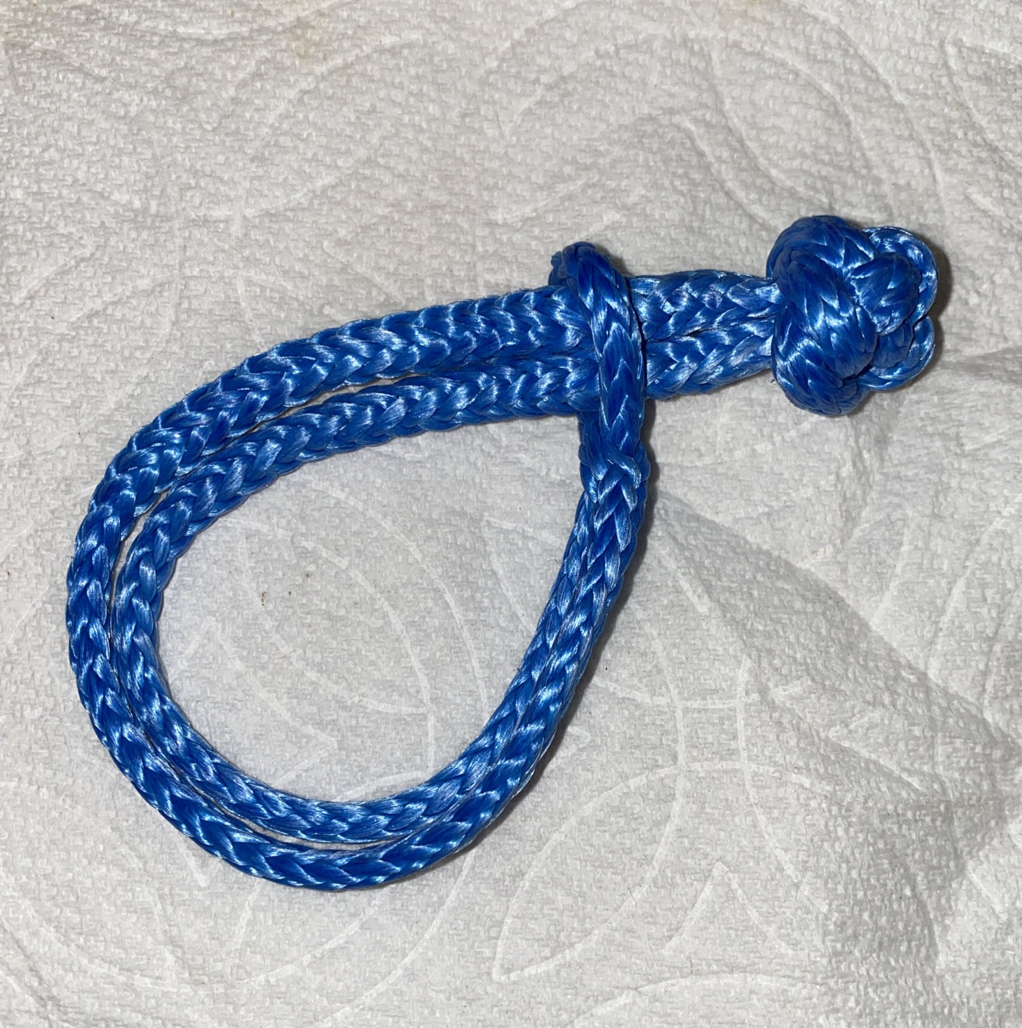

The loop spliced dyneema line is certainly a consideration. For the specific application I would have the loop tested to establish the strength of the splice. I have used buried dyneema line on my gates safety gates. They are going on 6 years of exposure. No whipping was used, just the Chinese finger torture grip of a line inside another line. Line shows no deterioration. I'll take a photo next week when I am on the boat. For the application one could use a soft shackle. I have tested these. 1/4" SK62 Amsteel line when tied into a soft shackle has a breaking strength of 10K pounds. This would exceed the force requirement for a sail attachment. I suspect the force for the application on FlimFlam might be about 300-500lbs. In such a case you could use a 1/8" or 3/16" line and have 300% plus safety factor.
From my soft shackle test reports.
DescriptionMin StrengthAvg StrengthTESTED
Break Strength
SS Wgt
7/64" (2.5 mm) Amsteel Blue1,400 lb1,600 lb2,800 lb0.0105 lb
1/8" (3.0 mm) Amsteel Blue2,300 lb2,500 lb4,600 lb0.0175 lb

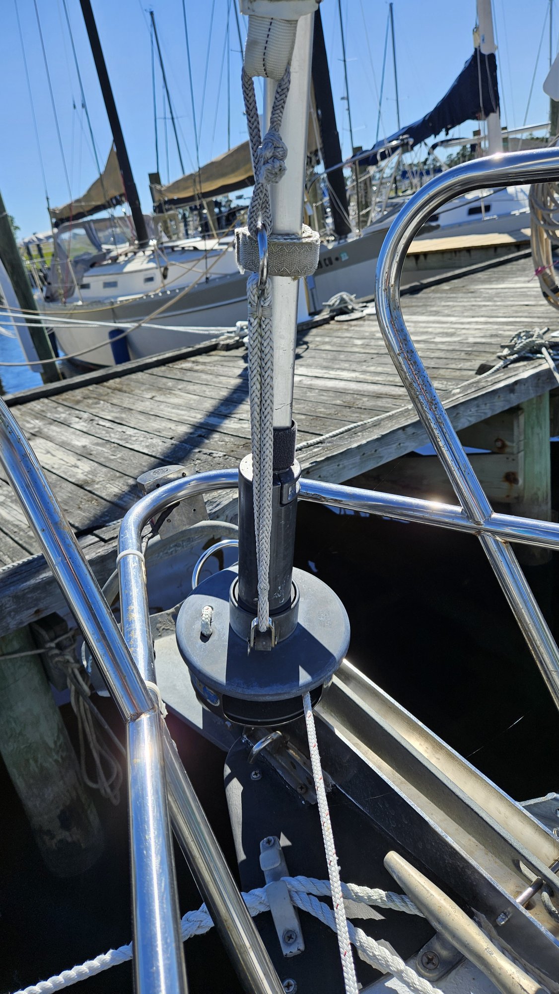

My boat has a dyneema continuous loop with a metal ring at one end and an eye with thimble on lower end. Works well. The picture also shows a soft shackle used to attach the ring to the sail.
24,926
This is a soft shackle made using 1/4” Samson Amsteel. They can be made and length desired. For the task on the boat in the picture I think the 1/8” dyneema would be more than adequate with a 300%safety factor. There is no risk that the buried line will slip when using the soft shackle knot system when compared to the buried loop design.
A 12” loop soft shackle cost approximately $3 usd in materials.
