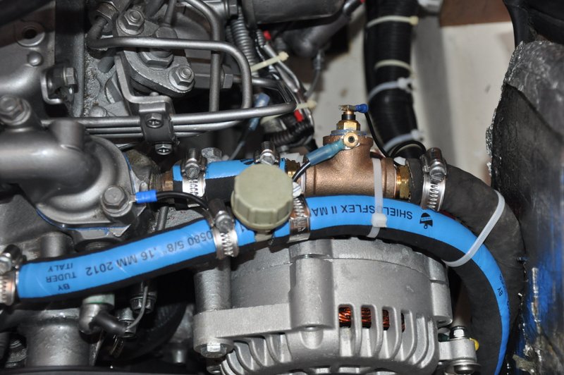

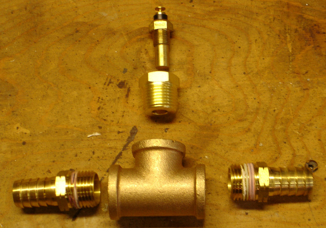

I will tell you I did the tee thing years ago and they worked great for about
a year or so until one day one of the brass tee's cracked and it was the oil
sender that cracked and good thing the oil gauge was at the helm and saw it before ruining my yanmar engine but the oil leaked all over.

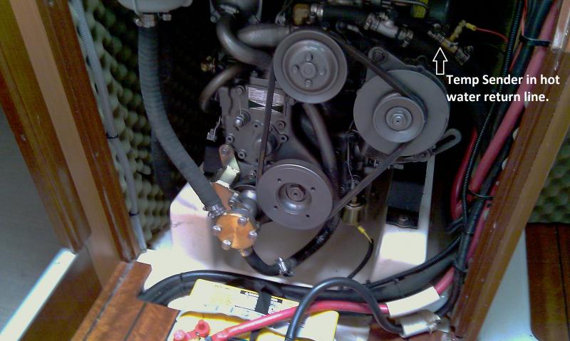

I just added a temp sender and gauge to my 3YM30,no tee.
I will look for the photo for the install or look in the search on this forum.
Nick

Great
That cruz pro sounds good but I already had the temp gauge
and got a temp sender and I added the sender in the heater hose
and had room for gauge at engine panel in cockpit.
I just look at the gauge and still have warning buzzer hooked up.
Nick
