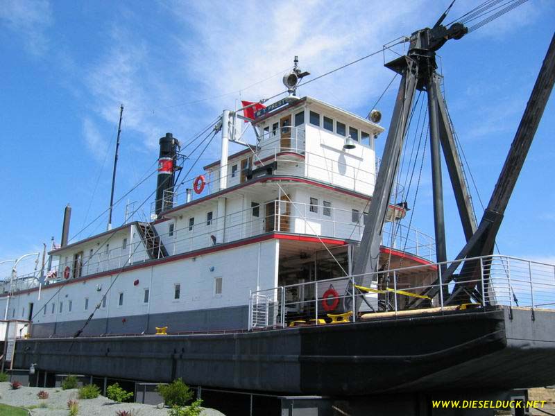

We have steam ships like the W.T. Preston in Anacortes (now a museum ) that would cruise the channels and recover logs and deadheads. Sadly that was in a time long past.

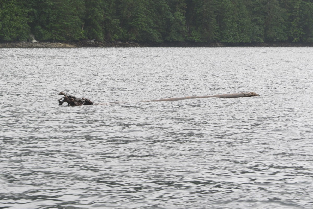

Now that's a LOG... Nice PICs! lol did you call it in?
23,261
I tried to answer but the signal was garbled.:biggrin:
:beer:
Likes: Meriachee
23,261
did you call it in?
That is just an example of what we find in the water.
I saw a line of logs about a 1/4 mile long along a tide rip. Called that one in as a Sécurité message. It got the attention of one power boat cruiser that was heading toward the logs at about 20knots. Open water.
