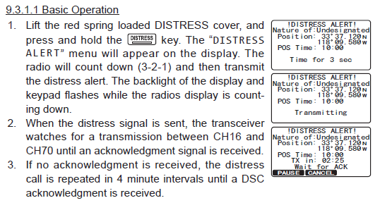

From the GX 1700 Manual:
This seems to show that when "the DCS is activated" your GPS lat/lon is displayed on the Distress Alert screen at least until you receive an "ACK" from some station. To call someone and tell them your lat/lon from your microphone you can press the PAUSE soft key shown above.

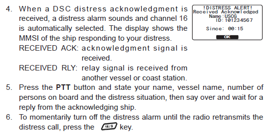

If you have gotten the "ACK", the screen shows:
Press the OK soft key or the 16/9 key to exit the distress alert. This will take you to your normal display, which also shows the lat/lon of your radio's GPS:
where you can read it and speak it.
Do any of these screens look like what you encountered when you were having trouble replying to the USCG in your ch 16 MayDay converstion with them?
