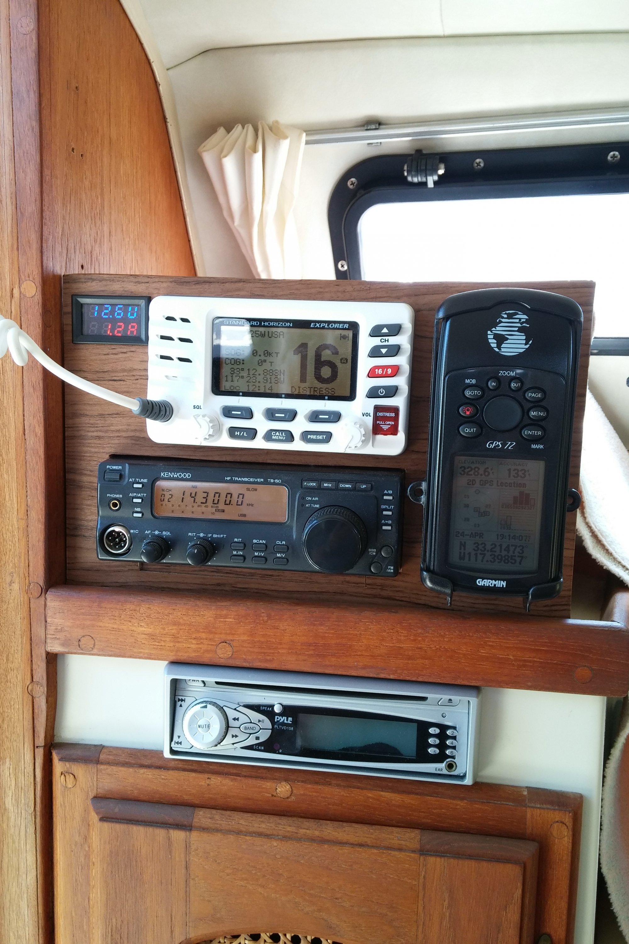

Feb 17, 2006
5,274
My radio (SH GX-1600) does not have internal GPS. I had to buy an external handheld (Garmin GPS72). It is wired to my radio. All of this is below deck. No external antenna.
