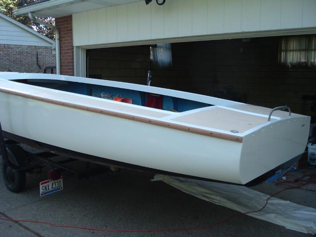

Done right with shade, right temperature, free of dust, and a properly prepared surface it should look great. It will take two people in order to keep a wet edge since you have so much surface. I think you will need to do the sides separate from the bottom. I don't know that you could keep a wet edge with that much vertical, not with 2-part.
I used a one-part, Toplac, on my cabin trunk and deck. I don't think anyone can see brushstrokes. I look forward to pictures of yours. That will have to be my next step, my topsides gelcoat is getting thin after thirty-one years.
P.S. Almost forgot that I also painted the entire hull sans bottom of my Highlander. Another cheaper one-part, Brightside, that I had left over from previous projects. And no, you cannot wet sand and buff out like gelcoat. But the paint does not mark up like gelcoat. Just clean and wax.
