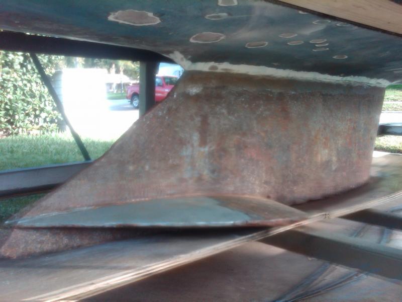

I have removed all of the growth and the first real nasty layer of rust. I ground down to not the shiny iron, but got it to black up by where it meets the hull.
I painted some POR-15 on to see how it would adhere. On humid days, I can see some moisture weeping through the POR-15 and creating little bubbles. On dry days it's good, as it was to day with 50% humidity.
Is the keel saturated?
Thanks!!!

Hmm, can't picture how the solid iron could absorb water, if you really got to bare metal. Did you use the POR cleaner and metal prep? I wonder if the POR doesn't adhere as well without that. I used it, and mine is pretty good, with only some minor rust blisters after about a summer and a half, in fresh water though.

I'm with Peter.. Can't imagine solid iron absorbing moisture, and POR-15 is non-porous so how it could 'weep' is a mystery to me. However, improper application can cause bubbling. Here is a snippit from their info sheet:
por-15 application info sheet said:
POR-15 is cured and strengthened by exposure to moisture and will dry faster under extreme humidity, but moderate to dry atmospheric conditions are most desirable when applying this product. That's because extreme humidity may cause an immediate surface cure, trapping carbon dioxide gas below the surface. When this happens, bubbling may occur. Extreme humidity at the time of application may also interfere with proper adhesion of the POR-15 coating to bare metal because it is almost impossible to keep the metal dry under such conditions.
Source: POR-15 Application Info Sheet
Could this be what you are seeing?

I would guess that there are holes in the keel and were covered with rust and they are weeping when the liquid expands.
If you would take the keel down to bare metal I would guess that you could see the imperfections.
I don't know if I would worry about it. The keel will rust off of the boat in about 2135.

lookin briefly at the poop on POR 15, it pretty much is the same as all other instructions on prepping the keel. First lets start off, the keel is metal and cannot become water logged which is a fact. The first thing that must be done is to get back to a clean metal surface getting rid of the rust, dirt, old paint and so forth. Then clean off with acetone to get rid of grease, dust residue, etc....
I then coated the metal with zinc chromate which helped to keep the metal from rusting. The next was to fill in any holes or depressions with a two part epoxy filler and then sanded smooth. Then I applied 4 to 5 layers of Interprotect 2000 series barrier coat epoxy paint. When dry, I lightly sanded the epoxy paint and then applied anti fouling paint if that was reqired. This process worked every time.
Like I said, everything is in the prep work and that may have been the problem. Yes I did screw up once in a blue moon and it was my prep work. Once, I had an employee to bottom paint over non priming paint which called for the first coat of anti fouling paint within a certain specific time on a 29 footer. I left specfic instructions with the employee as I had gone to a meeting at Hunter. Several months later, the paint was flaking off. I found out my instructions were not followed to include other things that had gone on to include drinking while driving with a company vehicle. Needless to say, I pulled the boat out of the water and redid the job correctly.. I fired the employee over many things but DWI in my vehicle was the last straw.

I used to use, and recommend, the use of POR-15 on the iron keel of my H28.5. While I had some success with this product for a few seasons, it began to deteriorate and I have since removed all of it. In some long conversations with techs at Interlux, they convinced me that POR-15 was not the right product to protect a submerged iron keel for very long (and my experience bears this out). They recommend 3-4 coats of Interlux Primocon on a properly prepared and sanded iron keel before applying bottom paint.

What did you use to get the keel down to shiny iron? I have been using 29 or 36 grit discs on my angle grinder, but am having a hard time getting past the black layer just before getting to shiny iron. Is getting to the black enough?

The black layer might be the remains of a previous owner using phosphoric acid to de-rust the keel in a past life. Can be some tough stuff to remove. I have had success in the past using one of these things in my angle grinder. Much more aggressive than sanding discs.

Thanks!!! I saw these in the store last weekend but thought they looked weaker than discs. Something new learned today. Cool. I bought a gallon of Fozz, phosphoric acid, a few months ago and have been looking at alternatives. I wonder if the previous owner used something like this and if I can use it, then do the interlux primocon. I'll have to check.
