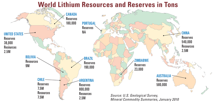

Guess what is the major source of Lithium?
Ocean Water that was/is Solar Dried in Salt beds.
Go Chile Go!!

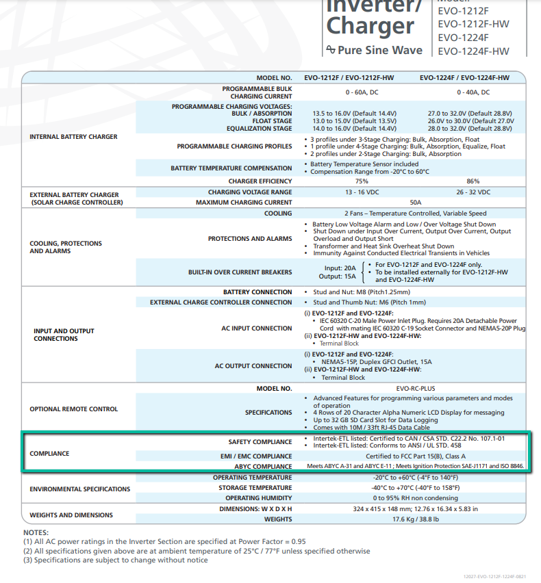

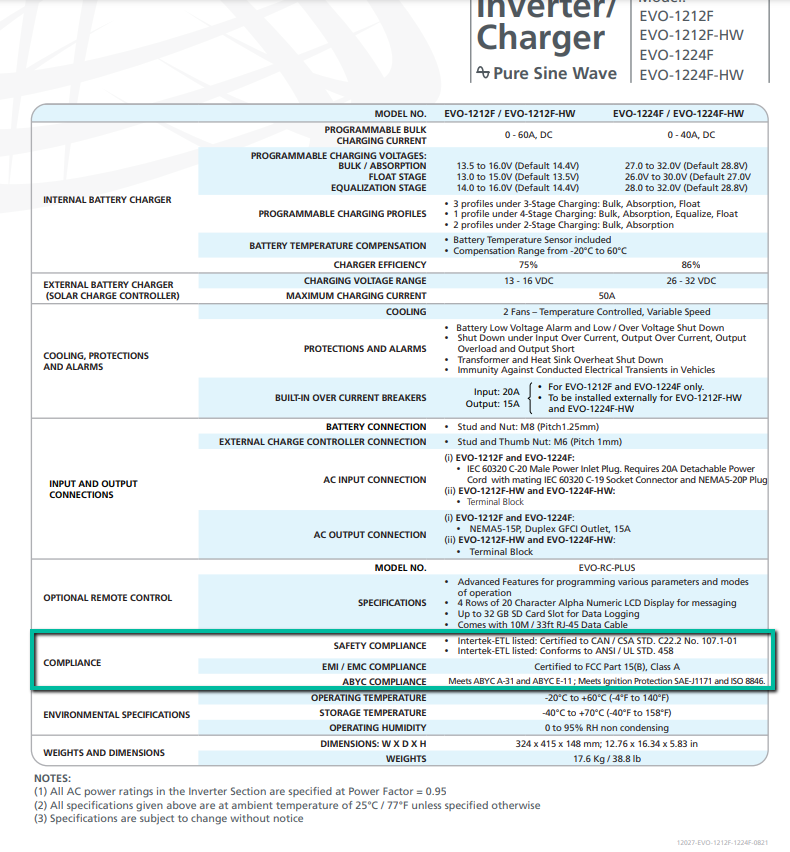

I have been looking into the Samlex Evo series of inverter / chargers and while it does not work from an app, it does have the most controllability of any charger that I am aware of. One of the programable charge settings allows you to go to whatever voltage you want and then off, no absorb, no float, just off. It does not restart until the bank drops down to an restart voltage. This would cover the 80% while in storage on shore power. Another nice feature is that it also has a DC passthrough input which will allow it to control the charge current from other sources so you can get the same bulk/off/restart from your solar.
According to the spec sheet it is ABYC A31 & E11 compliant. surprisingly, I could not find a similar statement about ABYC compliance anywhere on the Victron site or spec sheets. I am looking at the EVO-1212HW because I don't have any high demand AC stuff but the 60A charger (+50A pass-through) would be nice on the charging side.
