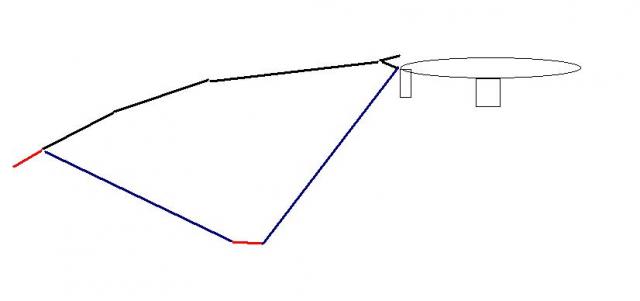

JSD retrival
The black and red line at the end of it represents kind of what the drogue is to look like under medium load. I wonder if you replaced the 15lb chain (the red tail) with a retrival line with the 15 lb chain in the middle of it, if that would produce the same weight on the end of it. From a previous thread I realize that the angle determines the tension and an angle of about 130 produces the same tension on both ends as the weight applied.
Maybe make the retrival line a lightweight 1/4" with a 5 lb weight in the middle and 10 lb chain on the end of the drogue.
If this could be done, then you could put a retrival line at the end of the drogue ona a swival shackle. It shouldn't drift under the boat. It shouldn't get tangled in the drogue. It shouldn't cause any troubles for the system.
I know Mr. Jordan makes it clear not to use a retrival line but maybe he didn't think of this setup. I bet there is a way to use a retrival line safetly that doesn't hinder the effectiveness of the drogue but makes retrival a breeze.
Thoughts?

Or.....there is another idea. You can tie a line to one end of the bridal, around the bow and back to the cockpit. Then release the bridal so now you are bow to. Then turn the engine on and motor towards it as you pull in the line from the cockpit. I used to do this all the time with my anchor rode but after getting the deck all dirty from the mud on the line, I gave it up.

I bet there is a way to use a retrival line safetly that doesn't hinder the effectiveness of the drogue but makes retrival a breeze. Thoughts?
That's a very clever idea in your sketch. I bet it would work but I wouldn't want to be the first one to try it.
I expect Jordan doesn't like retrieval lines because of the risk of collapsing the cones and the huge snarl if the whole thing spiraled. Your idea should work but, if the high resistance should pull the lines together and wrap them, you would have to cut it loose.
