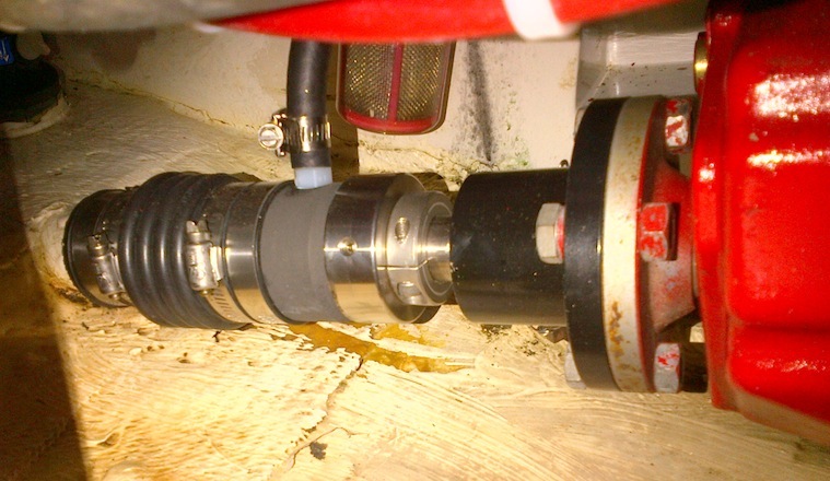

Here's a picture of my installation, and you can see the retention collar just inboard of the stainless ring.

PS: Well done installation @Meriachee . Note the difference in the bellows compression on yours versus the OP's.

Mine has the original engineering change with the installation of the breather tube. It has a neoprene one. The current versions have a stainless nipple on them, and this is an upgrade that will be undertaken when the bellows get replaced.
I went to PYI site looking for that collar.
It was not part of the PSS seal, but a way to keep you shaft/prop in your boat. @jonelli Good idea to add, $20.
https://store.pyiinc.com/collections/shaft-retention-collar/products/shaft-retention-collar
It is a split collar, for post PSS installation and a way to assure no shaft slippage of rotor.;)
