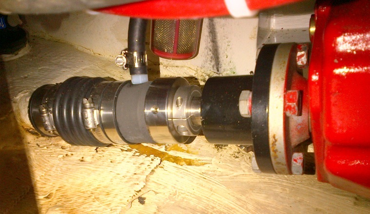

It's a split collar, so there's no real unbalanced weight. Although a hose clamp is light, it's still parasitic. I am in year 5 of the PSS, and up here, there's close to a 100 degree (C) end to end temperature swing, and thus far, no problem. Of course the thing isn't operating at -30, so I'd expect that the claims of how long it lasts are going to be impacted by that. And, as you can see in the attached shot, mine has the nylon barb.
8,404
Wow, you have less clearance than I do! That must have been fun getting that coupler off. I have less patience probably. I would go to a split coupler!
Aug 1, 2011
3,972
Funny you should say that. I claim ignorance. In all the research I did, I never saw a split coupler, until 38 seconds after the shaft and coupler were ordered.

Yeah, I know. (now) This wasn't as much of a pain as the picture would suggest, there was about an inch of free space before the bellows got compressed, and without the collar there's lots of room. I was more concerned after reading how much of a pain the cutlass bearing was to do, made a tool that was a pita, and found a backwards mounted hacksaw blade made short work of that nonsense.
