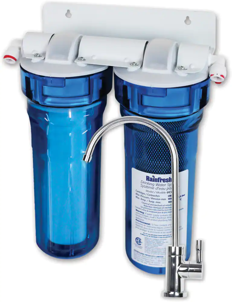

1678224409649.pngWhat I installed is a Rainfresh system that has 3-stage filter system - 5 micron (nominal) activated carbon block cartridge (62-1038) and 0.3 micron (absolute) cleanable, reusable ceramic cartridge (62-1002) with activated carbon core for the last 3 years with no problems.
