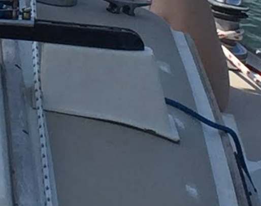

Hello,
I've got an '85 O'Day 28. Thinking of running some rigging to the cockpit (mainsheet halyard, reefing lines). Has anyone made holes and run lines through the plastic cabin top mounted traveller? Is it safe?
See attached pic.
I'm talking specifically the white piece that connects/mounts the black traveller to the cabin top. Has anyone run lines through it via drilling hole?

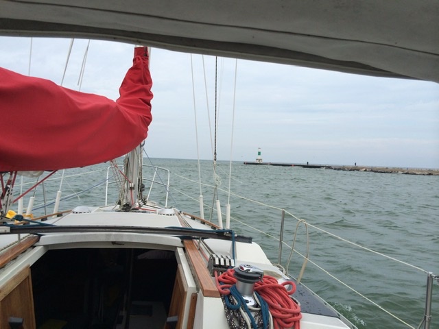

I have an O’Day 322 and my lines that run back to the cockpit run inboard of that white support And I have a 4-line rope clutch on each side...is that an option on your 28?

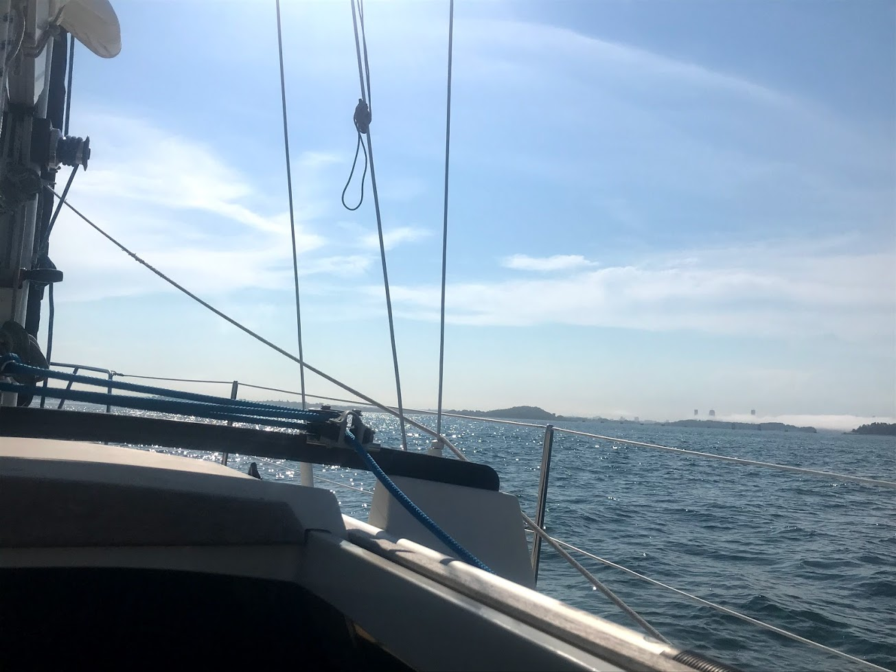

You can sort of see how mine is laid out in this photo...

Unfortunately there's not a ton of space on the outside of the riser (It's still a 28 after all) to mount lines on the deck - as seen in this photo (looking aft, pic is of port riser). The white spots are where the handrail goes, which is currently being revarnished.
jibes138 I'm having a hard time picturing your rec. You're recommending something be mounted to the riser either between it and the companionway hatch or outside it? Where I'd have the lines be run vertically on top of each other?
I feel like I should be worried about putting horizontal stress on the riser then?

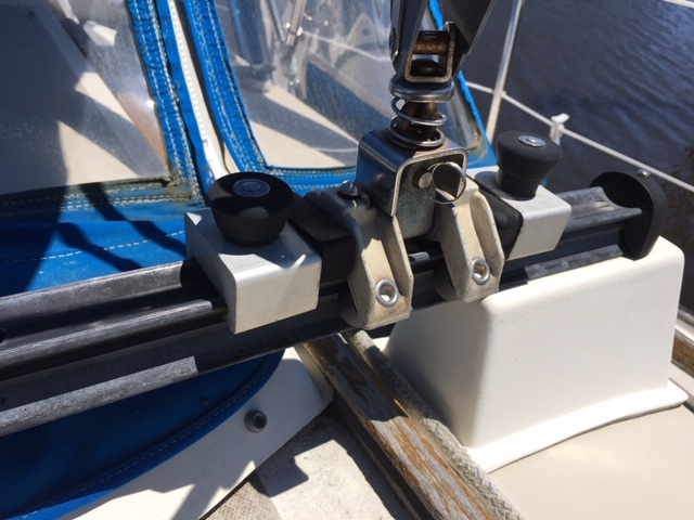

Sorry to veer off a bit, but is that the original stock main sheet track? If so, what is the traveler itself installed there? My set up is the original, totally manual, no lines, and a true PITA. See photo. Would love to use the same track with a better traveler set up like what you have.
