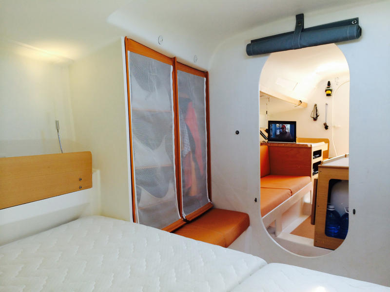

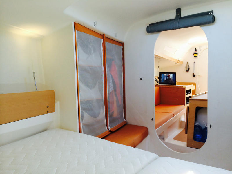

The Pogo line of yachts from Structures feature weighted curtains that roll up. The are held in place with magnets when down. Lighter and simpler than a door.

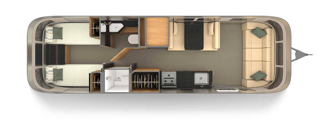

Certainly weight is a factor having a door on a boat. But I think a limited comparison between Boat and House is misplaced. I suggest a comparison of RV might be more valuable.
Attached is a 30' Airstream Trailer Floor plan. A single door that serves both head privacy and sleeping space.

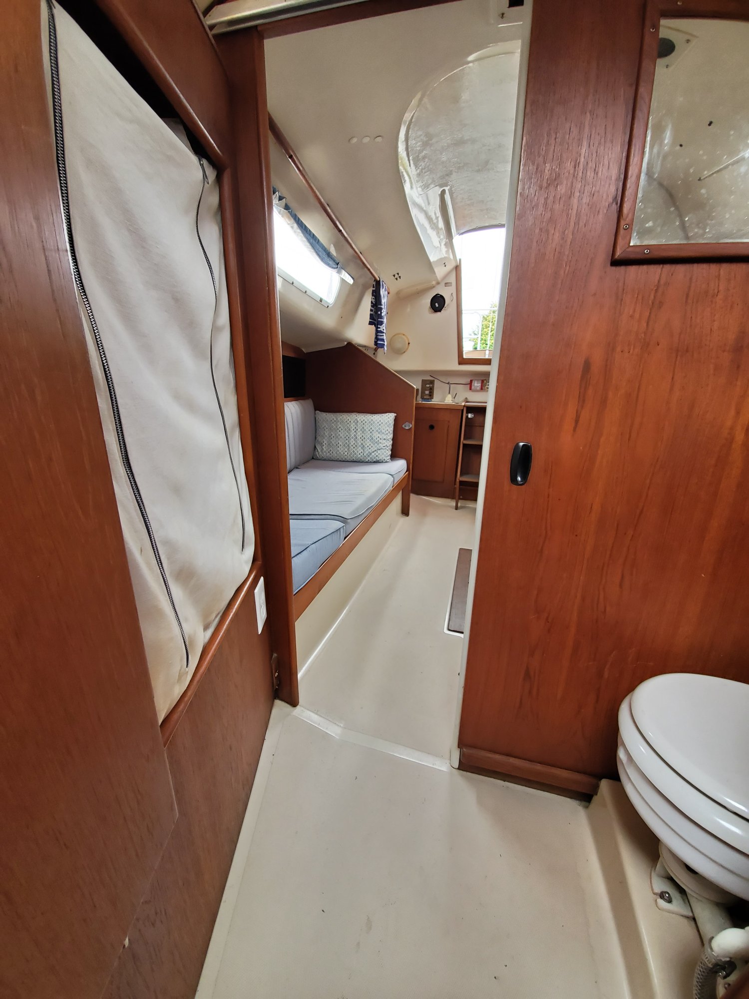

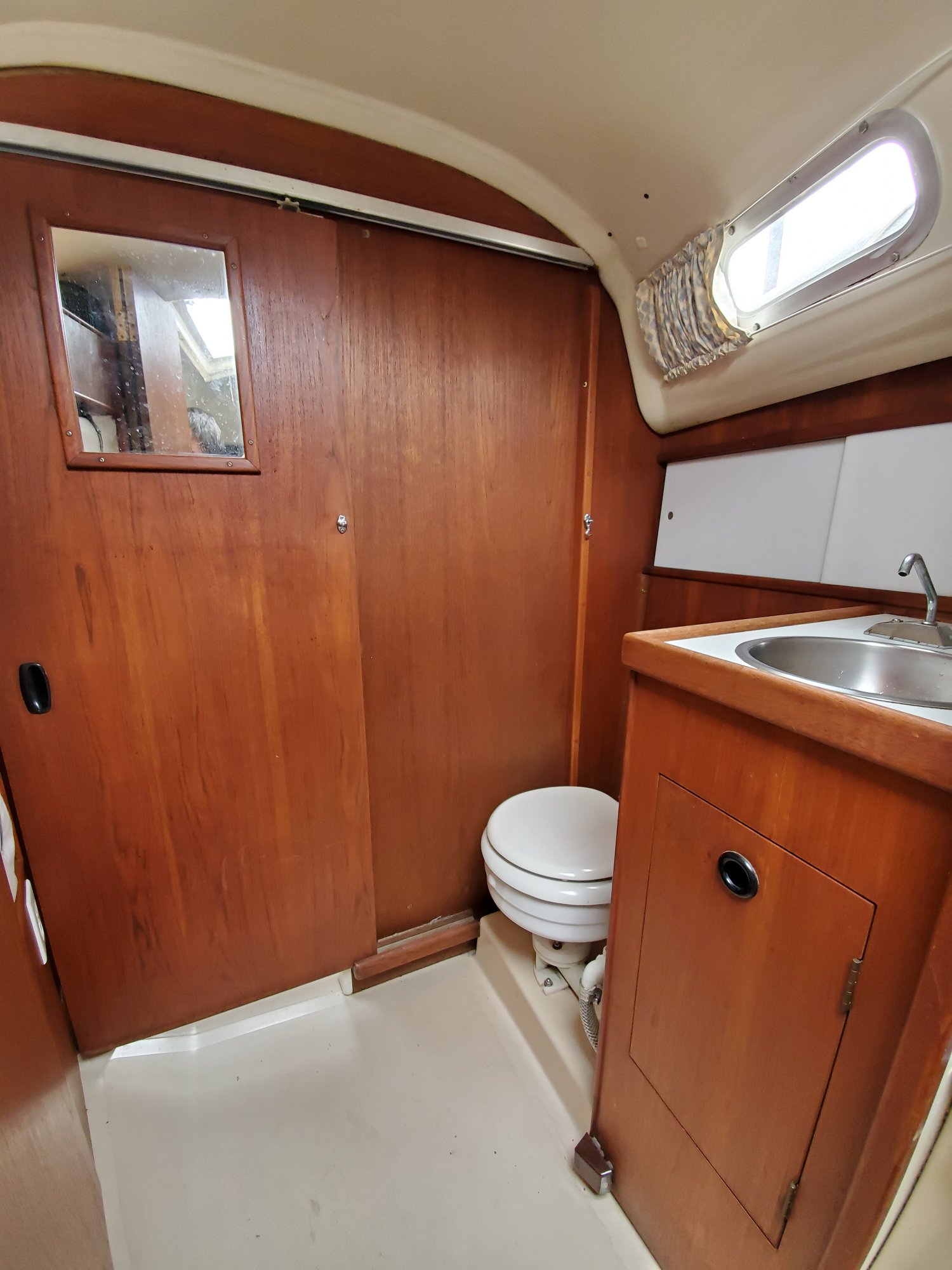

True pocket doors slide into gap in the wall to disappear when open. This is totally impractical on boats, where walls and bulkhead are only as thick and absolutely necessary. House interior walls always have minimum thickness of 4-6 inches.

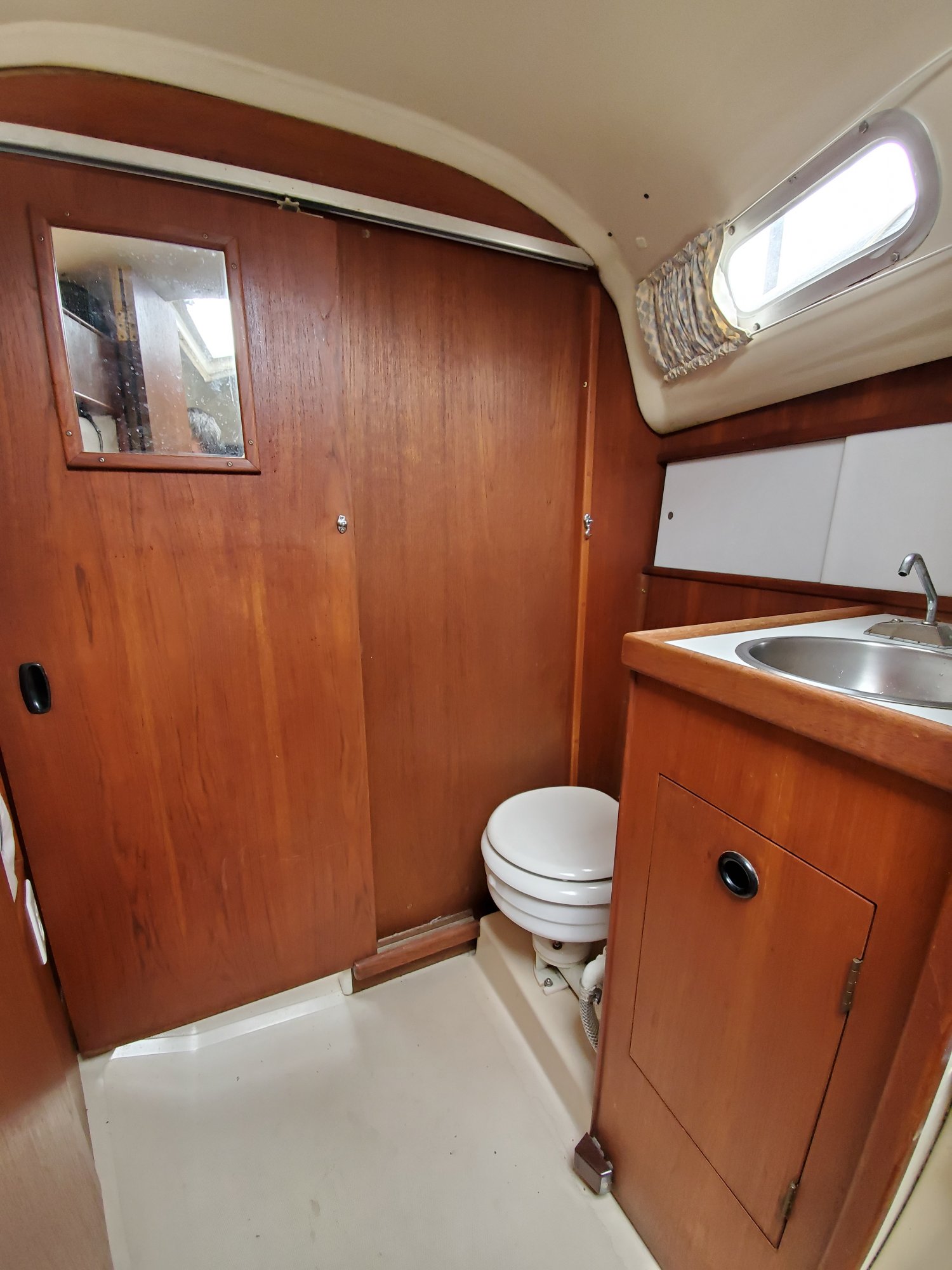

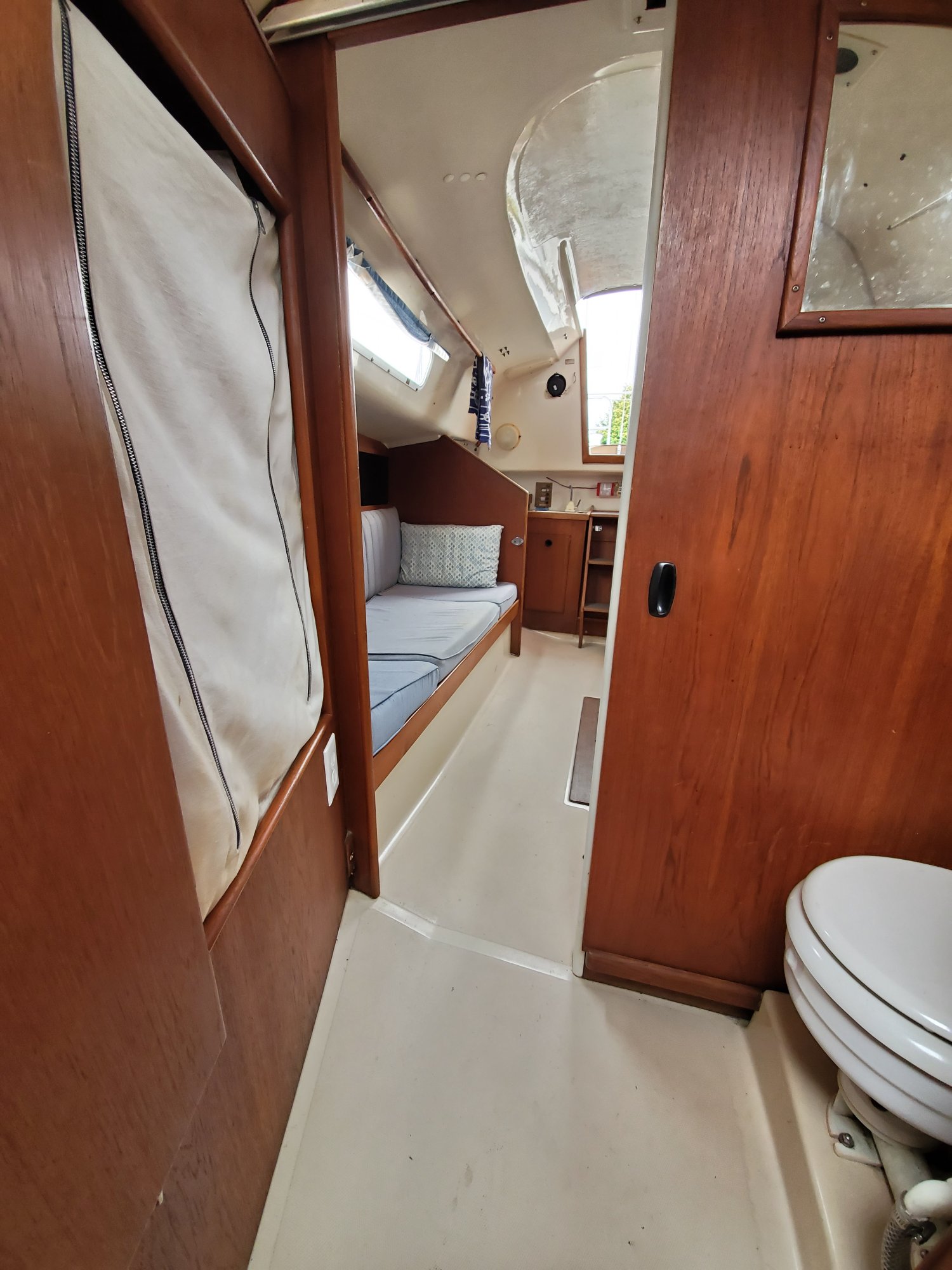

BlueJ has ’barn door’ Doors on top and bottom tracks to give the head privacy. Like a true barn door, it slides on the exterior of the bulkhead. I’m assuming this is what everyone here is meaning when they say their boat has ‘pocket’ doors.

Sounds like the best choice.
it works well. The trick is the adjacent wall must be flat and unbroken for an area (width and height) as large as the door. That’s rarely a given on a boat.
On the 260 the head spans the hull, giving plenty of room for both doors.

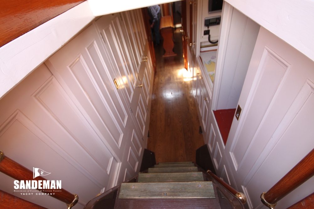

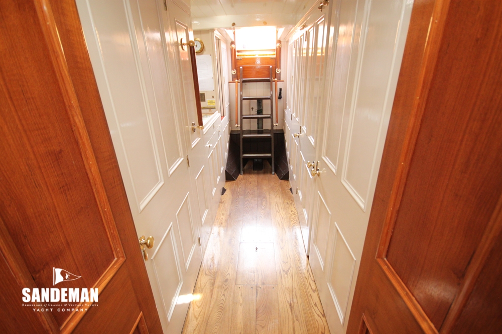

Doors, sliding, hinged, on a 52' Bristol Channel Cutter designed in 1911(re-done in 2009).
It occurs (to me) that sliding doors are handy lined up on the centerline like these that close in pullman like berth to starboard. Or the hanging locker to starboard. More workable in a seaway.
Looking aft through this passageway. I'm a door person so this turns me on. :)

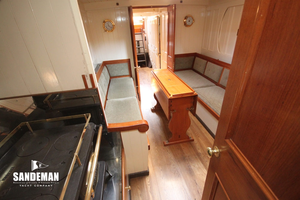

Regarding another thread on poor boat photos: This EU broker of wooden boats, Sanderman, is a guide to taking great for sale photos of a boat. Plus, our friend Iain McAllister who's done so much research and work on the Alden forum I believe does the research and text work on the descriptions.
Back to doors: This old boat has sliding doors on the pilot berths. (Old school design with sea berths and a forward galley, still good today, apparently as it's sold).

... and then you can't use that wall for a bookshelf or such:(
you can actually. Like in that picture, the exterior wall has a wide open expanse available. If the item is heavier that requires fasteners attached from the backside, it’s a simple process to remove the door and attach the fasteners and then put the door back. On the inside you can as well, it just can’t be anything heavy. Or anything that would get in the way when you close the door. So things like mirrors and hooks to hang robes or foulies are fine. Probably not a bookshelf! :)
