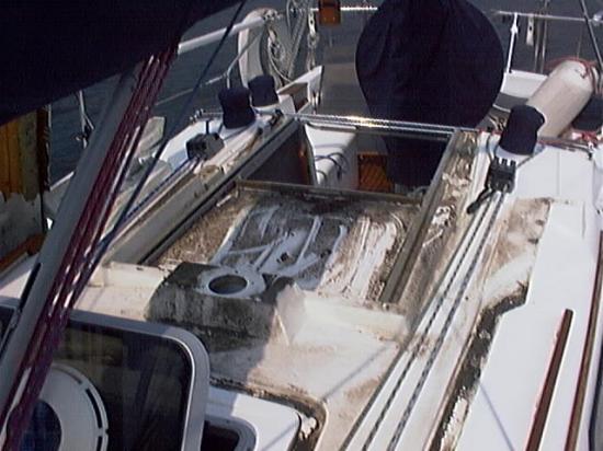

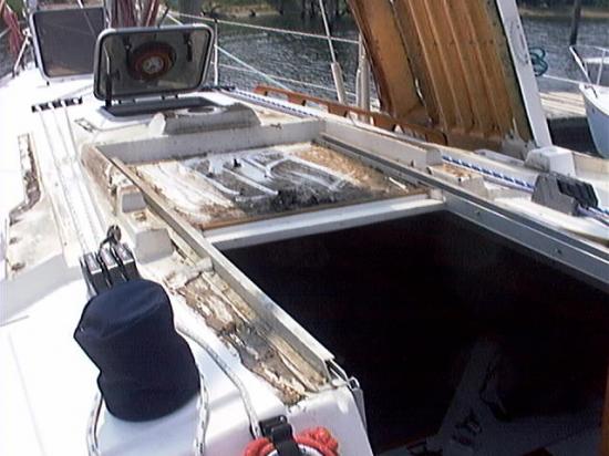

didn't now if you had these pictures.. these are of the H-31 without the sea hood on.
H31%20Companionway%20Hatch%20Cover%20Removed-2.jpg H31%20Companionway%20Hatch%20Cover%20Removed-1.jpg

I'm not on the boat, but regarding the wooden stop on the forward end of the slider - why do you think the seahood would have to come off to take off the (unbroken) stop? Isn't it screwed in from the underside (the cabin side) of the plexiglass?
I never thought of removing fiberglass to open up the aft ends of the slider tracks. I would certainly do that before going through a seahood removal. It would also effectively let the aluminum tracks become "pourover" points that shouldn't clog, like the semicircular molded-into-the-fiberglass drain points there now. You wouldn't need to take much fiberglass off in the fore-and-aft dimension. Why would the section that is removed need to be recovered at all?

10,256
The wooden stop is forward of the lip on the inner forward part of the opening.. the place where the cleaning lines are in the left picture. It hits the front edge of the lip inside the pocket, stopping rearward movement.. you can't see it unless you open the seahood.. Interesting thoughts on the aft ends of the slider covers.. without the wood stop forward, something has to stop the slider from coming out aft. You may be able to remove enough of the aft cover to allow removal of the slider, but you'd have to cover the opening maybe with a piece of teak or Starboard to stop the slider from coming out when underway.

I've run through all the previous threads on this topic, and have noted the comments about the forward ends of the aluminum channels for the slider being open, and that plugging those forward ends while the seahood is off stops some leaks. I'm not sure I understand how the plug would stop a leak. A plug would only prevent water from entering from the front of the channel (say rainwater sheeting across the coach roof). Water will still be getting in the channel from elsewhere (I know to keep the channels clean and the aft channel opening clear). Is it that the plug actually prevents water that is already in the channel from moving FORWARD, spilling into an area where it pools, and the rising pooled water comes in over the forward portion of the slider (the part that runs athwartships).
10,256
On my 34, the gap above the slider (lower aft edge of seahood) was insufficient to let the wood chock stop clear the lip in the cabin ceiling .. ya just couldn't lift the slider high enough at the forward edge to get the block clear of the lower lip. ya couldn't disengage the stop..
Again, on the 34 (I think the 31 is very similar) the boat sits slightly bow down when unloaded (in slip) .. That tilt, even though a very small amount, causes all the water that gets on the top of a closed slider to preferentially go forward into that dirty pocket in the picture.. it cannot easily get into the drain channels. The water that runs off the sides of the slider go into the channel which would be a fine drain if they were tilted toward aft. They are if folks are in the cockpit.. plugging the fronts of the channels would make the water running off the sides of the slider go into the channel under the slider in the guide and hopefully aft, depending on folks positions in the boat. In my 34, in a heavy rainstorm, both folks sitting at settee, no leaks .. but when we walk aft, ya have to be ready to catch about a pint of water that will cascade out of the aft edge of the companionway.. a small piece of line with a knot in one end can be inserted under the slide at the lip and the other end put into the sink. The water will follow the line into the sink mostly..
