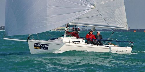

the picture above is a J boat. made by the J sail boat company. sailed all over the world. they come in many sizes. the Johnstone family builds boats. high quality, well thought out, great performance, ..... it's a sailor's sailboat. the boat pictured is a J/80.
i do need to warn you tho. once you scope out a J/80 you will fall in love. prettiest girl at the dance.
beware, the video is with olympic sailors in 30 knts of wind
Geez. Jibing in a 30-knot wind. The amazing thing is that the boat does not sink under the weight of the sailor's balls!

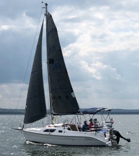

Something else you could look at would be a Hunter 26.5. I have no idea how it sails, but is a keel boat with an open transom.

that's the british olympic sailing coach and some buds. all doable.
the J80 is top quality, available in your price range and will easily sail like a family boat. google J80, you won't be bummed.
google Ascow videos, now they will flip if you don't pay attention.

I love my H26 for all the reasons you state about the amenities but it is water ballast. Hunter did make a few H270 which have the same hull and lay out as the H260 but with a fixed wing keel
