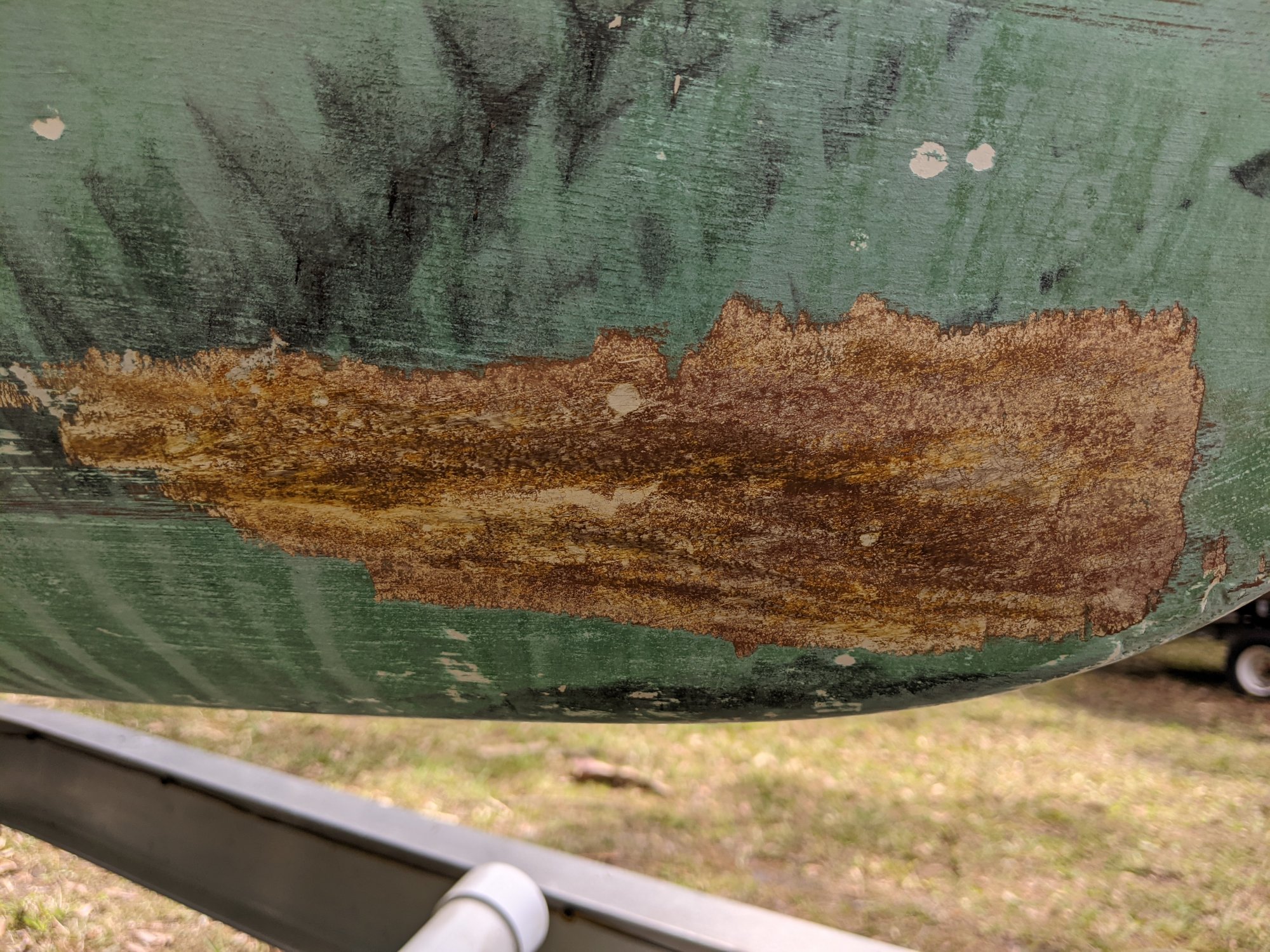

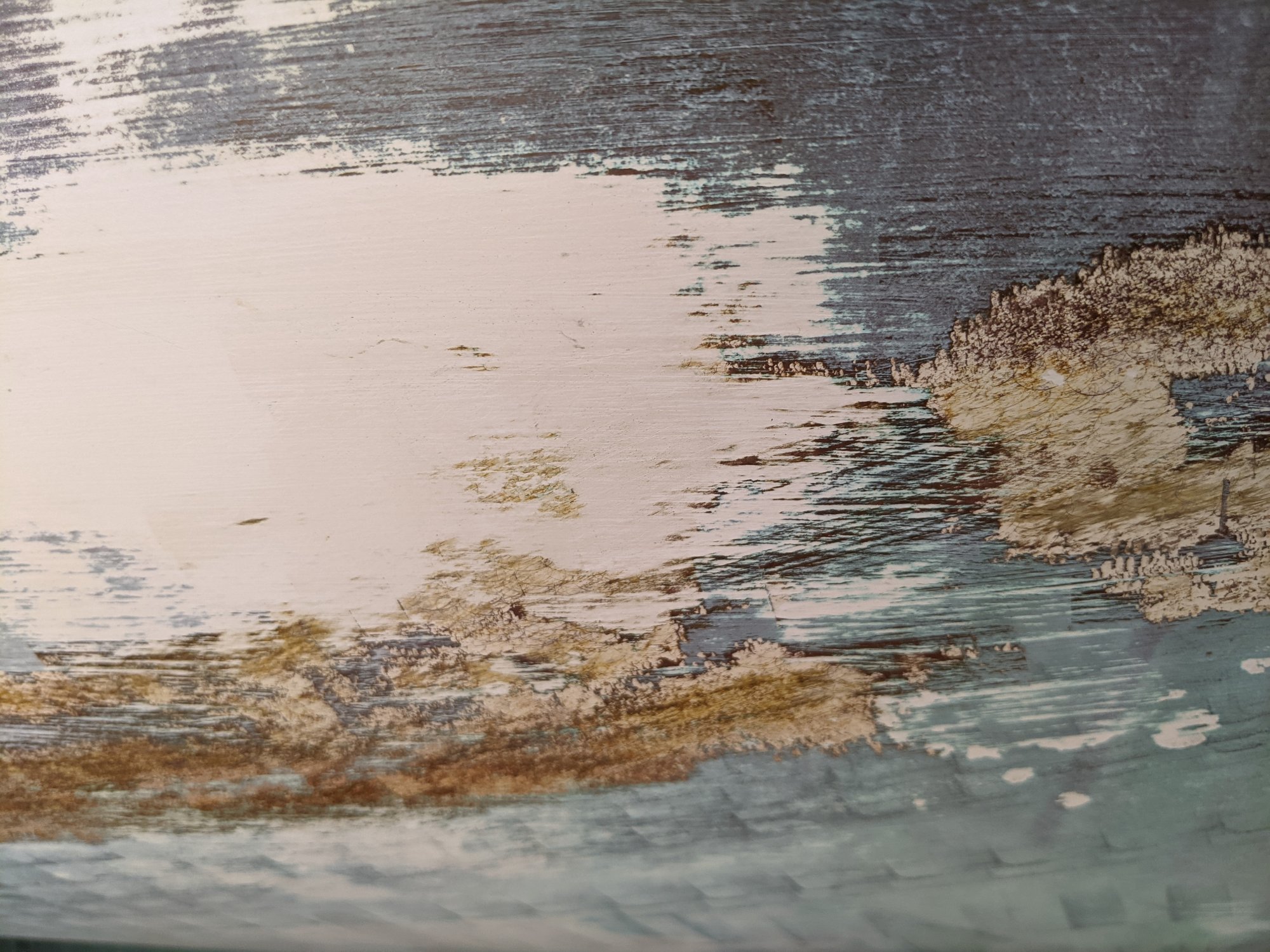

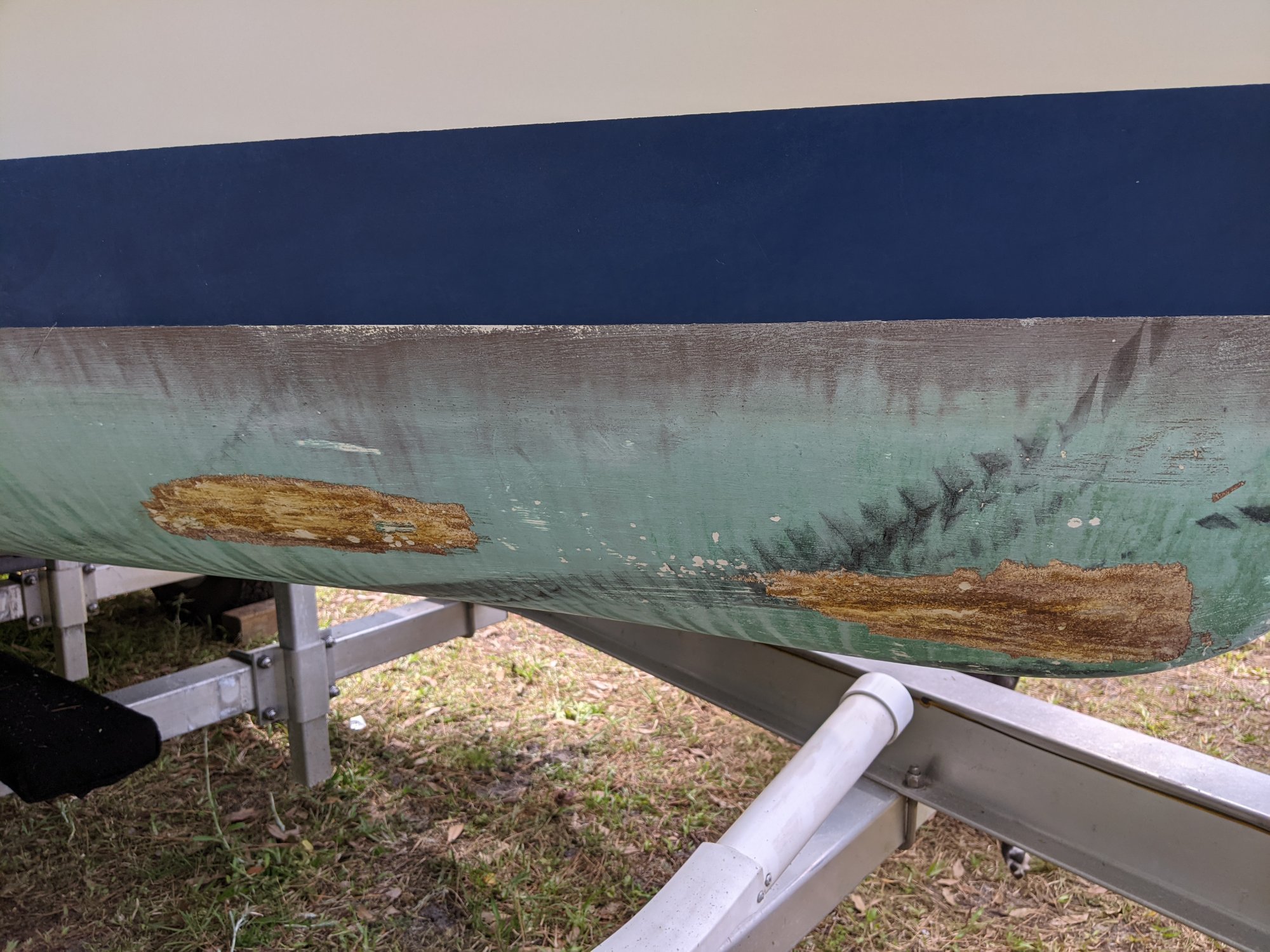

I am in the process of stripping the bottom paint off of my trailer sailor hull (Oday 192, 1988) and was planning on applying a barrier coat. Scraping the older, blue bottom paint is quite easy and I expected to see white gel coat below. However, I have encountered this brown/tan mottled layer that is very smooth and harder than the blue bottom paint. But I also see white hull in some locations (pics attached). I do not know what this mottled layer is. Would a previous primer be so smooth and hard or would this be an actual barrier coat? I would like to figure out what it is in order to determine what type of layer I should put over it, or if I should strip this layer as well. Has anyone encountered such a layer? The PO is not available for info. Thanks, Robin

There was a time when people used an epoxy tar barrier coat. This has fallen out of favor. The color would be a dark brown or black. The tar had a tendency to dry out and get very hard after many years.
Take a rag with some acetone on it and rub the area. If it is a epoxy tar barrier coat some of the tar will rub off on to the rag.
Removing it would be a good idea. And you'll be thankful that your boat is only 19 feet. Although at some time in the process you'll swear it grew in length. ;)

When we bought our H34 new in 1985 the dealer had a barrier coat applied. It is rather thin, but definitely brown. There have been the occasional blisters formed. Whenever I would find them I would clean them out dry them and fill with epoxy and bottom paint again. At the next haul the blister would come back in the same spot. So I finally gave up trying to fix them. The ones I left haven't gotten any worse than when they first showed up. Some are 20+ years old.

Thanks for the replies. I will do the acetone test to see, but it sounds like this was one of those early barrier coat attempts. It is super glossy in feel... too bad I can't rely on it. As the boat will be spending most of the time (80%?) on the trailer I am unsure what I will do for this season. I'll first strip all bottom paint to get a good look at everything. I appreciate the input.
