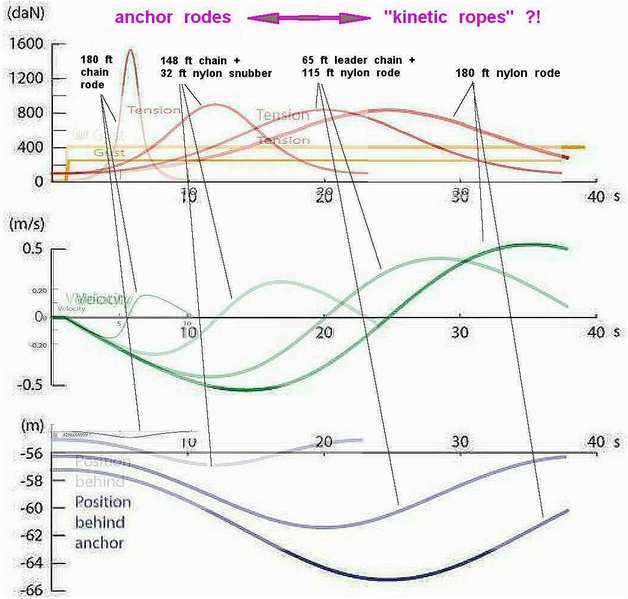

Why should sailors trust elastic nylon rodes to keep their anchors firmly set in sand or mud bottoms when offroad 4-wheeling enthusiasts use the same nylon rope as a KERR (kinetic energy recovery rope) to help yank vehicles weighing thousands of pounds out of the mud ?? This vexing paradox led me to Alain Fraysse's "tuning an anchor rode" webpages in which he analyzes the static as well as dynamic behavior of anchor rodes as a function of rode type/length/ thickness, water depth, vessel shape/size/weight and wind strength. In addition to discussing the basic laws and equations with the aid of practical examples, he provides interactive forms and Excel worksheets with which the reader can test various vessel, wind and rode parameter combinations. Among the dynamic phenomena considered are the combined effects of wind gusts and rode elasticity (particularly with regard to shockloading through surging) as well as the mechanism and effects of yawing (aka sailing at anchor). Alain purposely limits himself to wind-induced rather than wave-induced dynamic phenomena. While hinting that the latter could easily be 10 times as strong, he basically summons cruisers to avoid -- or abandon -- wave-exposed anchorages.
The dynamic examples given show a single, sustained windgust producing a 400 daN (900 lb) drag force on a 5-ton boat attached to a securely set anchor in 5 m (16 ft) of water by means of a single rode, variously consisting of 55 m (180 ft) of 8 mm (5/16") chain, 55 m of 18 mm (3/4") nylon, 20 m of chain + 35 m of nylon, and 45 m of chain + 10 m of nylon. Assuming a steady wind force of 100 daN (225 lb) before the gust, he then plots rode tension, surge velocity, distance behind anchor and degree of angulation between rode and bottom as functions of time. The Excel spreadsheets also allow variable windgust rise times, rather than a (zero-rise time) step function. Since Alain's graphs for the different rodes tend to be scaled differently, making direct visual comparison difficult, I have rescaled and combined his graphs for the 4 different rode types into a single plot (see image attached below or click on link). For the purpose of this anchor rode vs kinetic rope discussion, I have omitted the rode angulation plots.
http://terrawatch.net/images/DynamicRodeCollage.jpg
The composite plots only show the first surge event in response to the windgust. According to Alain's calculations, that first event is followed by a series of oscillatory surge events that dampen out relatively slowly. In fact, even the tension spike in the full chain is followed by a second maximum of nearly equal height and duration. To me this is counterintuitive as I can't recall ever having noticed oscillatory shockloading from our anchor chain as the result of a single, sustained gust. For the purpose of the present discussion I will just focus on the first surge event. Unsurprisingly, Alain points out that it is difficult to obtain an accurate value for the minute elasticity of anchor chain under the conditions used. Depicting the chain as completely inelastic, however, is not an option as it would produce infinitely high shockloads in the tension plot. Therefore he uses a small elastic stretch value (equivalent to about .07 % at 1,000 daN or 1/200 of that of the nylon rope).Because of the nonlinearity of the shockloading forces produced during minimally elastic collision events, as well as the lack of reliable anchor chain elasticity values, the tension plot for the full chain rode can only be a very rough estimate at best.
By way of an everyday minimally-elastic collision example: imagine dropping a small ceramic cup from your hands. On a concrete floor the outcome is likely to be very different than on a wooden floor, although the latter flexes no more than a few thousands of an inch. Yet this minute amount of elasticity ends up making a huge difference. During the inelastic collision with the concrete floor the cup's momentum (MxV; where M is mass and V is velocity) is primarily transferred into impulse (Fxt; where F is force and t is time duration); i.e. MxV = Fxt. Since the contact time is extremely short in this case (typically in the microsecond range), the shockload force F exerted by the floor is very large, thus shattering the cup. The minuscule elastic movement of a wooden floor, however, allows some of the cup's momentum to be preserved as floor momentum (with very small V but large M) while potentially extending the contact time into the millisecond range, thereby greatly diminishing the value of the shockloading force F.
If such minute amounts of elasticity (and/or pseudo-elasticity due to residual chain catenary and link misalignments) produce major reductions in shockload force it should come as no surprise that the inclusion of a 32 ft length of 3/4" thick nylon line in the 180 ft rode nearly reduces the maximum tension in the rode to that of a full nylon rode. Although even the use of as little as 10 ft of nylon "snubber" line markedly reduces the overtensioning of chain rodes in response to wind gusts, sailors often argue that the longer the elastic nylon line section, the better it will be for vessel comfort and safety. Consequently, nylon rodes with relatively short chain leaders (e.g. 20-30 ft) have become quite popular since cost and weight are low, they are easily handled and stowed and the chain leader help keeps the angle of pull on the anchor low while reducing the risk of chafing the rode on rocks or coral outcroppings.
Before deciding, however, that these are ideal anchor rodes, let's take a step back and examine the dynamic response profiles of the two most elastic rodes shown in the figure, i.e. the full nylon rode and the nylon rode with chain leader, in more detail. Compared to the minimally elastic all-chain rode the highly elastic all-nylon rode produces a 2.5x higher maximum vessel velocity (and thus maximum momentum) plus a 10x larger surge excursion (and thus mechanical energy relase). Most importantly, while calculated maximum rode tension drops by a factor of 2 (assuming the all-chain elasticity estimates were realistic), the duration of the gust-induced tension maximum becomes a factor of 10 longer, thus amplifying the impulse (F.t) delivered to anchor and vessel approximately 5-fold. As any sailor familar with the retrieval of well-imbedded anchors from sand or mud bottoms knows, rather than trying to break the anchor out suddenly with great force one learns to apply a steady pull over a period of 20-40 seconds, or so......
Clearly, the all-nylon rode in Alain's sample calculation behaves like a typical kinetic rope, first stretching to store large amounts of kinetic energy imparted to the vessel by the wind gust (in the form of potential energy) and then shortening again to release this energy by simultaneously trying to pull the vessel back and the anchor out. Moreover, the dynamic behavior of a long nylon rode with short chain leader does not appear to vary greatly from that of an all-nylon rode, other than by its ability to reduce the angle off pull on the anchor (provided the tension in the rode is not high enough to fully straighten out the rode, of course; see Alain's website for in-detail discussions).
In short, while a measured amount of elasticity in an anchor rode is a highly beneficial property, there would seem to be such a thing as too much elasticity. Based on the well-established fundamentals and applications of KERR systems there appears to be no particular reason to expect that anchors attached to highly elastic rodes with properties similar to kinetic ropes are somehow magically destined to stay firmly embedded in sand or mud rather than to be yanked out unceremoniously when winds and waves conspire to load the rode up with a dangerous amount of potential energy.....
If so, the safe solution might be to choose rode materials with lower elasticity and/or to dimension and proportion high-elasticity rode segments in such a way as to limit the maximum amount of potential energy that can be stored and released to levels that are safe for the type and size of anchor as well as the type of bottom involved.

Where I want to go with the discussion is to examine the unwanted aspects of storing lots of energy in highly elastic rodes, to the possible detriment of the anchor's ability to hold rather than to be yanked out. Sorry for not being able to make that more clear to you
You are wrong in stating that the force applied to the anchor drops off sharply right after the peak value is reached (just look at the graphs) unless the graphs calculated by Alain for highly elastic rode combinations are wrong, of course.
Although I agree with your argument that pulling the catenary out of the chain still does not lead to shock loading, I am not worried in the least about shock loading since that can be avoided with a minimum of elasticity. Instead, I am worried about using ropes that can store and release far more energy than a well-set anchor is designed to handle.

Ross, your illustration highlights the central question: is the force that starts that brick sliding back toward the door analogous to an anchor being pulled out of the seabed by stored energy in the rode?
The idea of a dynamic rode is to mitigate peak loads by storing energy to be released over time. The moment of truth, it would seem, is when a hull receives a second wave/wind force when the rode is already loaded & cannot absorb the energy of the second hit. At that moment, do you simply have a static system (like a "bar tight" chain), or is there a compounding of forces trying to dislodge that anchor?
I'm not great at physics: someone is going to have to explain to me how it can be that the energy stored in a dynamic rode can be greater than the total force pushing the hull downwind(stream), at any given moment.
Which is worse, as far as keeping your anchor bedded: sustained load over time, or peak load as a pulse?

Of course, the total energy output cannot be greater than the total energy input. The same is true for batteries.
However, kinetic ropes act as storage devices for kinetic energy in the form of potential energy just as batteries act as storage devices for electrical energy in the form of chemical energy.
As is the case with batteries, for a shorter period of time output power can be many times higher than input power. There is no great mystery here since no conservation laws are being violated.
Again, just look at Alain's graphs to see the significant force amplification.

However, I would have to see some real world data with recorded wind speed and rode tension measurement before getting too excited about the peak loadings show. The USCG stability regulations for sailboats (something I'm as intimately familiar with as anyone alive, having worked on the modifications to them for sailing school vessels) are based on similar dynamic principles. The predict that a boat hit by a gust will heel about twice as far as it's final heel angle and then come back to a steady heel angle. This is not to be confused with a gust having a higher front velocity and then dropping off as most do. The regulations envision the wind suddenly increasing and then staying at that velocity. I argued for years that sailboats do not behave this way because I had never observed anything remotely like it while sailing. Wind tunnel tests at the Wolfson Unit in England eventually proved me right.
The dynamic analysis is based on looking at the area under the graphs; not their magnitude at any point. The system does not become stable until the areas become equal. There can never be more area under the "rode" graph at any point in time than the wind gust graph. There can be more area under the "gust" graph if the system can store energy.
The problem with these dynamic calculations is that energy leaks out of the system in more ways that can be accounted for and systems are less effective at storing energy than theory predicts.
