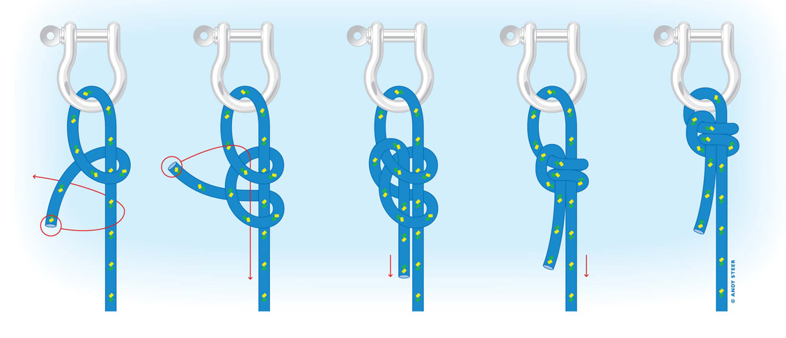

There seems to be a couple of different versions of the Halyard Hitch.
Halyard Hitch

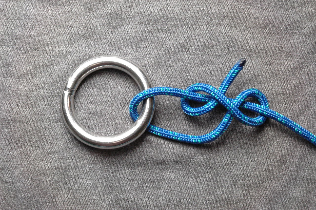

Then, there's the buntline hitch
These are knots that don't come untied easily after pressure has been placed on them.

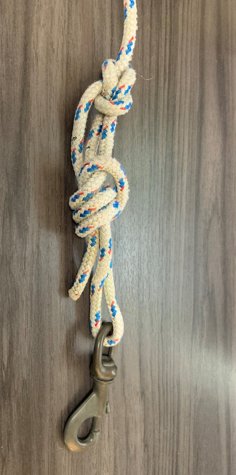

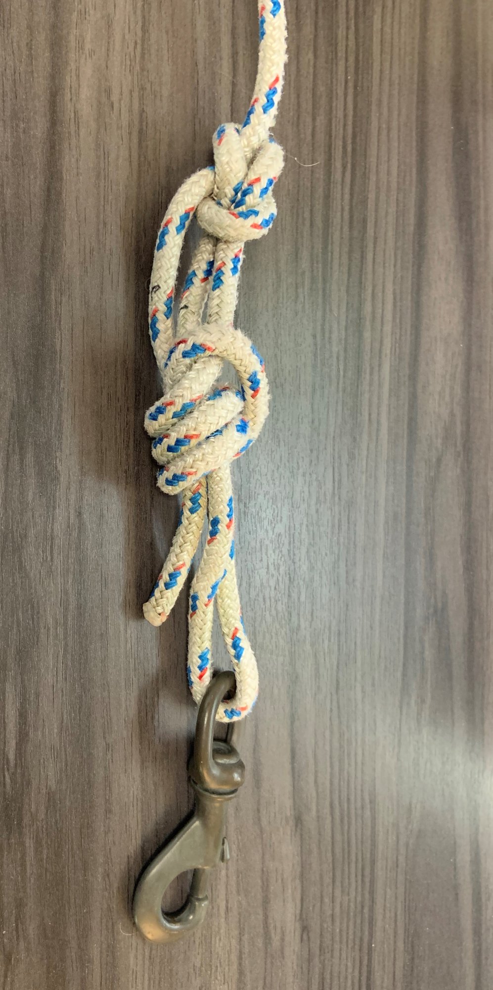

Sorry for the missing photo of the mystery knot. Here it is
The top part looks like a bowline and the bottom part, with the 3 wraps looks like a taut line hitch. Or maybe it is just wrapped like that to secure the und until needed.
Greg

Looks to me like a bowline at the top, plus a backup knot at the bottom. Usually the backup knot would be made over the standing part though, not the loop.

The bowline part is not a proper bowline, as the tail is outside the loop. A proper bowline has the tail inside the loop so it is less likely to snag the tail. The remaining part looks some extra line being "stored" by wrapping around the loop with tail lead through the wraps for security

Exactly!

We use to call them inside bowline ( right), outside bowline ( wrong) by making the round turn the wrong way you get a outside bowline. Watching the video posted above they are calling the outside bowline a “cowboy “ bowline. Never have heard of that one.

Dave identified it.
Looks typical of a sailor with too much line and not trusting the bowline to hold.
I like the halyard hitch knot for this use. Good locking knot. Reduced line usage. Easy to cut off when wanting to replace.
