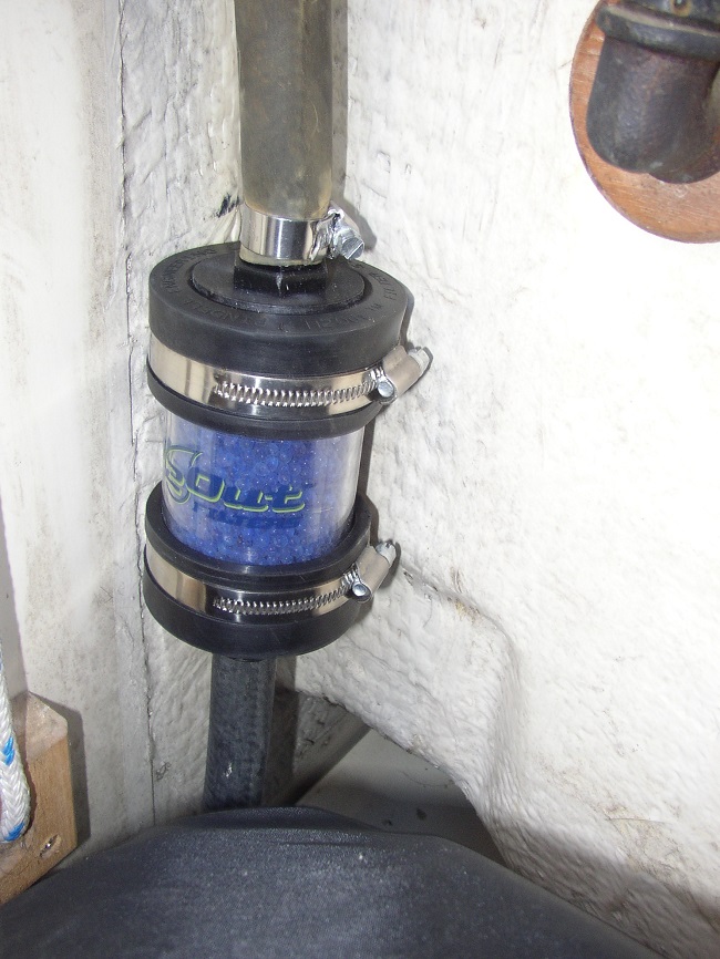

Algae probably got in there from moisture. I installed an H2Out desiccant filter to prevent moisture from getting in thru the vent. I have to rejuvenate the desiccant at least twice a season so it's working.
