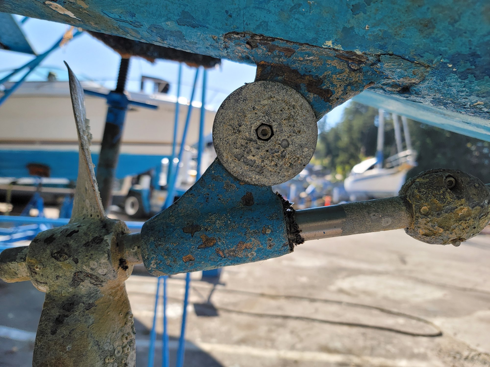

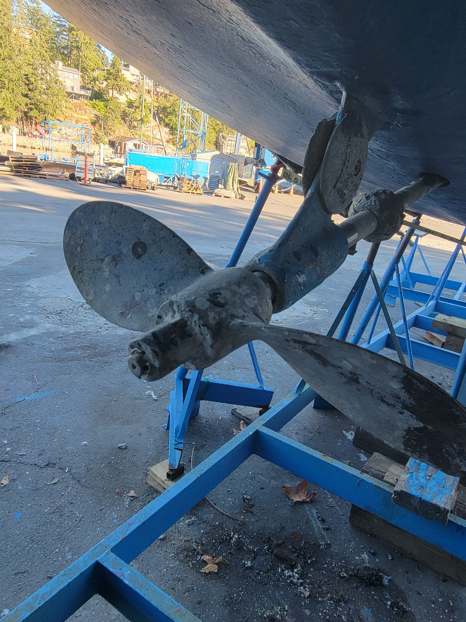

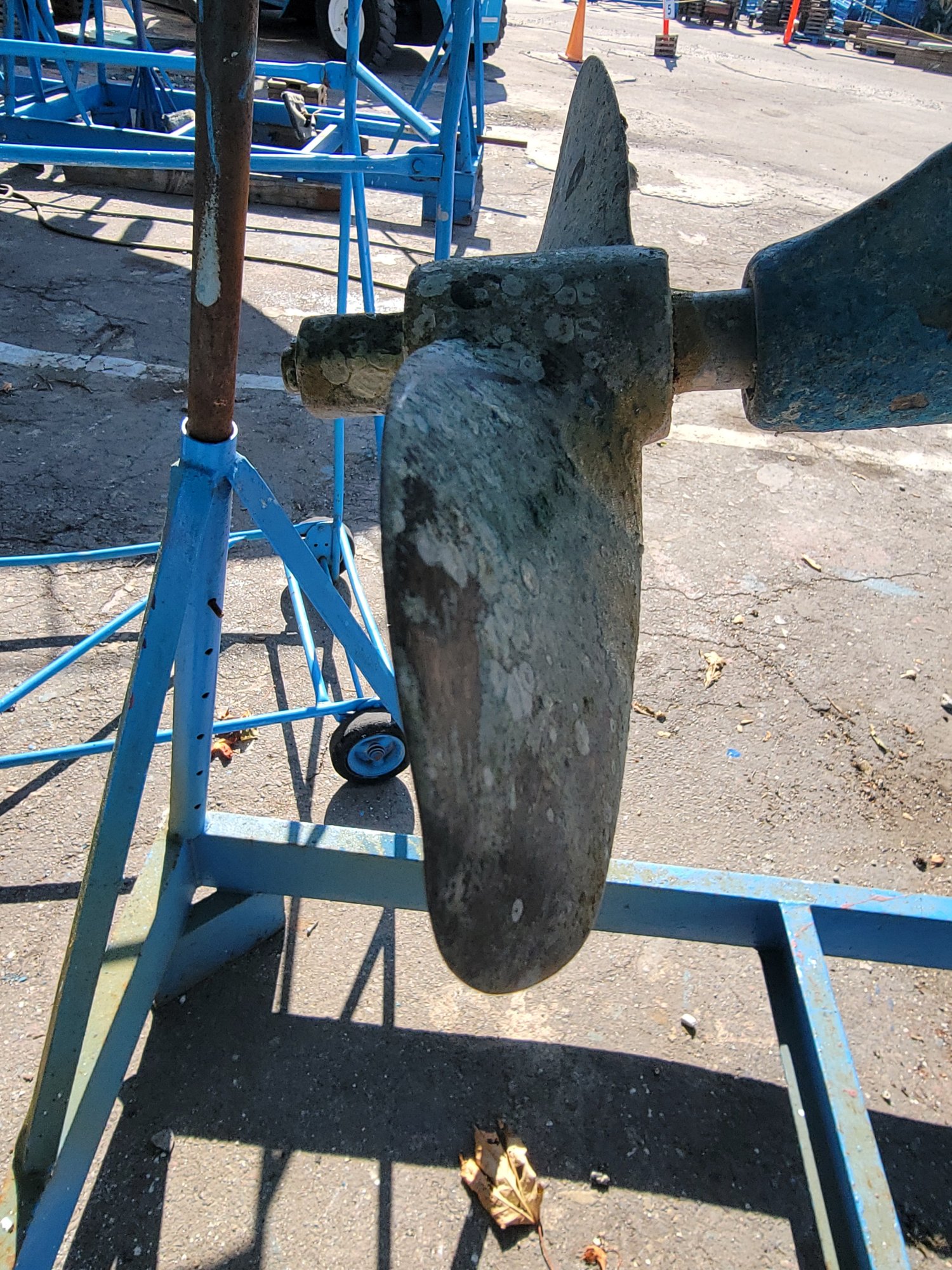

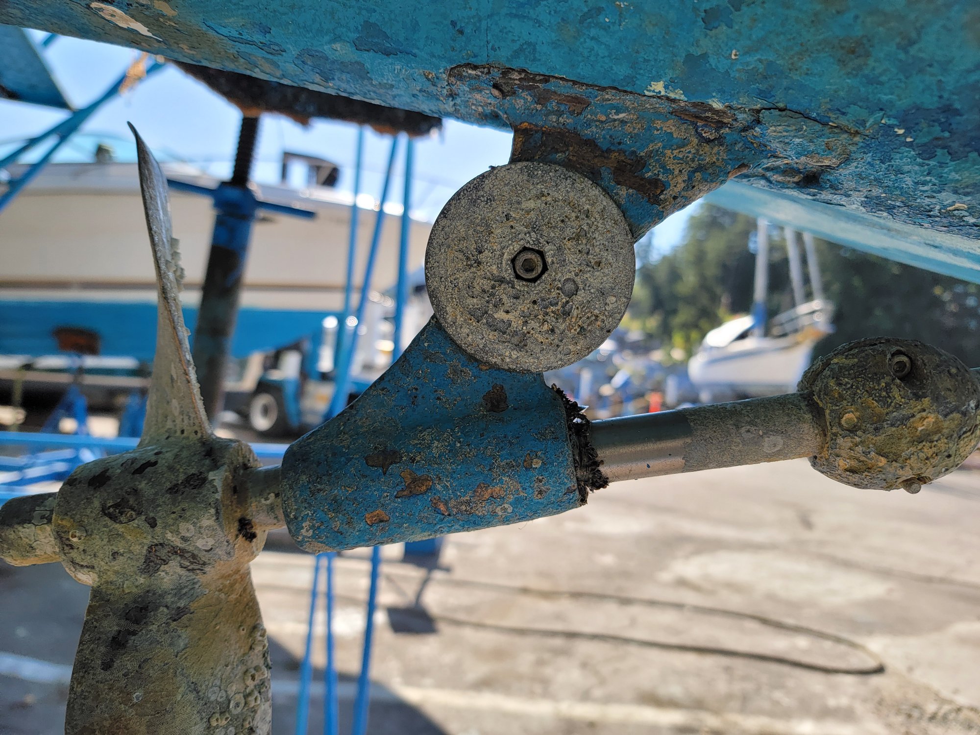

Hi, I've always felt my boat is under powered. The hull is clean and it will happily reach hull speed when under sail with 12-14kts wind but under power it struggles even at high revs. It also feels like it vibrates a lot. So im keen to hear if i should replace the prop and if so, which one?
The engine is a universal m18 (14hp). The prop is a 2 blade (dont have the measurements) and on a 7/8ths prop i believe.
Sometimes at slack and no wind and at nearly max revs (the boat doesnt have a tach but from sound, its really revving at this speed) i can get over 4knts, but if i cant plan to cruise with the current, i can only expect 3kts. Yesterday i was headed into a nominal 3kts wind and very very slight current (basically slack) and it was hard to get it above 3kts SOG- spent most the time at 2.8kts. When cruising over a longer distance, I have to use 3.8kts as my average speed and this is at almost max engine power. I should also note i regularly see similarly sized boats blow right by while i have the engine running at high revs
Its probably worth stressing that although i cant provide an exact RPM, it does sound very high and i dont believe the engine is unable to turn the prop so much as the prop isnt efficient. I do have a manual optical RPM guage (so i can install a tach once i get time!) so perhaps can confirm the max RPM
I dont know what the prop is. Ive included a picture taken last year. You'll spot one blade in a photo was omnce bent - (i did straighten this with pliers after spotting this)
Is an upgraded prop worthwhile here? If so, which one
Thanks in advance

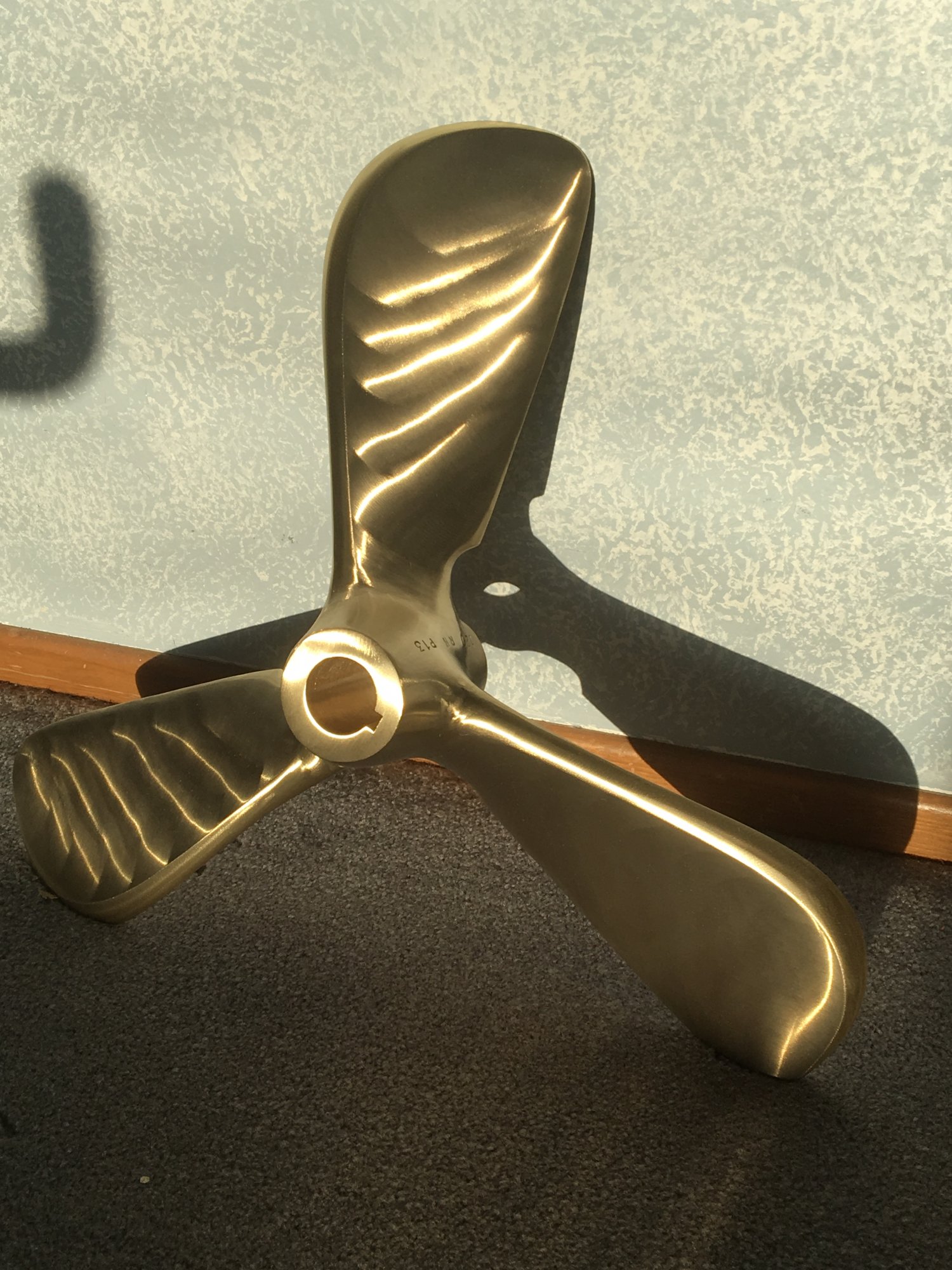

My O’Day 322 has a Yanmar 2GM20F and I was running a 14x14RH 2-blade prop. I didn’t like it either…dragged under sail, not great reverse thrust, and a bit of vibration while motoring. I could not get hull speed (6.9 knots) while motoring, but I could get 5-6 knots depending on wind and waves.
I put a 3-blade Maxprop feathering prop on her last season. Expensive prop, but I really like it. I gain a half knot of speed under sail, I have great reverse thrust, less vibration, and importantly, I can adjust both the Forward and reverse pitch. I tweaked both this spring before I launched, giving me stronger reverse and a bit more forward bite too. It allows me to really dial in the pitch I want and adjust if the engine gets weaker with age.
MaxProp can take your boat, engine and transmission info and provide you with the correct size and starting pitch, but you can dial it in after you run it for a while.

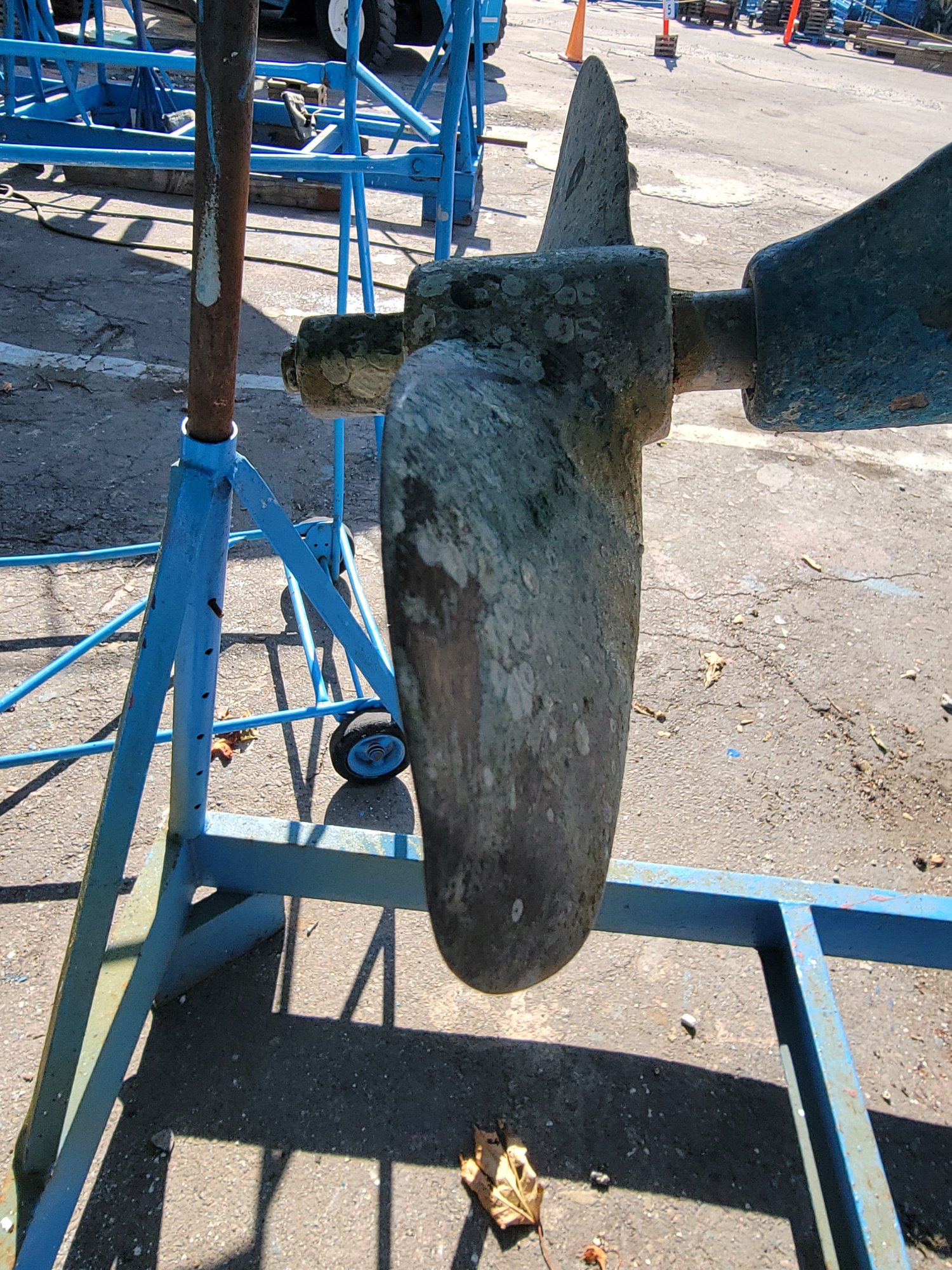

There may not be much room to enlarge the prop as tip clearance is a concern. There needs to be sufficient clearance between the prop tip and the hull to avoid turbulence that will negatively affect prop efficiency.
Even though the blade has been bent back to shape, having a good prop shop take a look at it to ensure the prop is well balanced and the shape is correct would be beneficial.
The prop's pitch may be incorrect. Give Campbell Props a call, ask them what they would recommend. You'll need the engine, transmission, and gear ratio. Compare that to the prop you now have. If you can't measure the props pitch, check on the hub it is often stamped in to the hub. There should be a label on the transmission with the gear ratio.

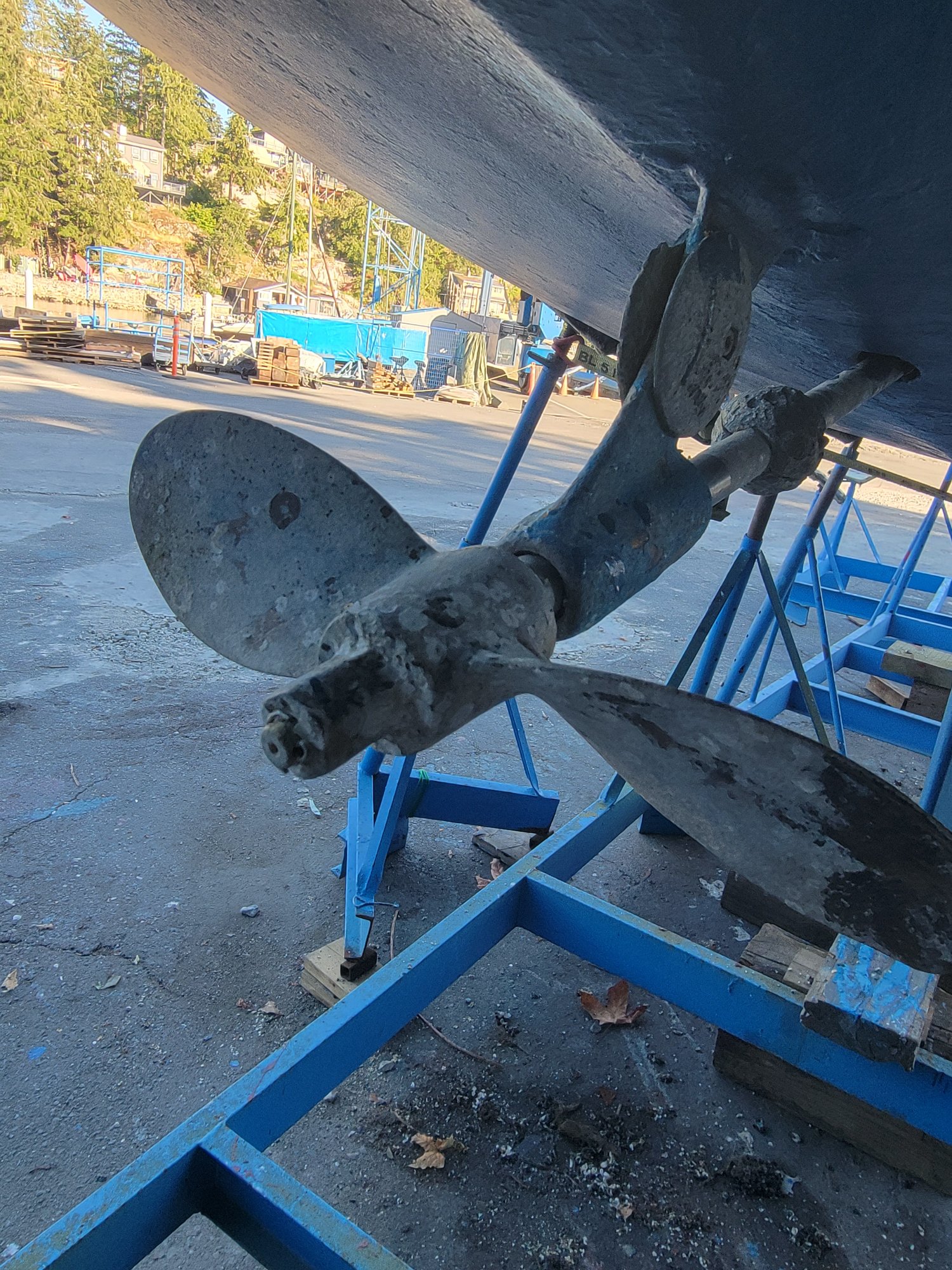

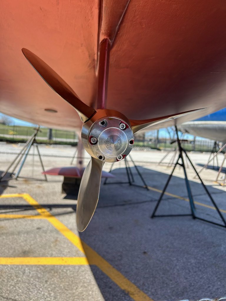

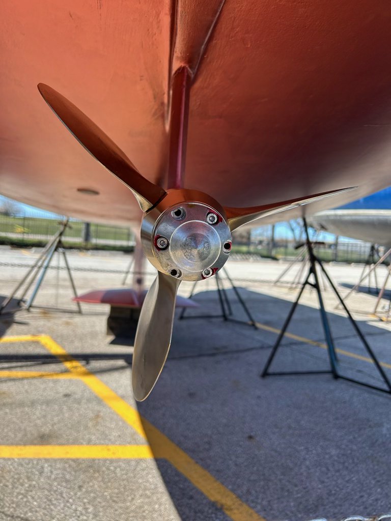

I had a mismatched prop. I could make the stern sit 8-12 inches down at a high RPM.
I changed to a CampbellSailor engineered by WestbyNorth. Now I get thrust not underperformance.
before
After
Improvement is unbelievable.

Did you straighten the prop after the pictures were taken?
Did you have the problem before the prop was bent?
Before replacing the prop I'd have a prop guy look at it for damage and/or improper repair.

Get that scroungy-looking prop off, and have a prop shop evaluate it, and straighten and balance it, as a starting point. You might just need a better three-blade "sailor" prop from any one of several vendors. As for vibration, do have the shaft trued, and eyeball the old coupler closely, also. Then align the engine - and probably replace the ancient motor mounts.

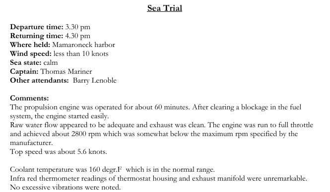

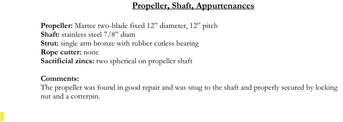

I owned a 1986 Newport 28 from 2004-2007. It had the M18 engine and I really enjoyed my time with that boat.
I just checked my survey from 2004. Here is what the surveyor found
And the sea trial
When I cruised that boat I could motor all day at 5 kts and burn very little fuel.
I bet there is something wrong with your prop.
As a quick test, run the engine at max RPM for 60 seconds. How fast can you go?
