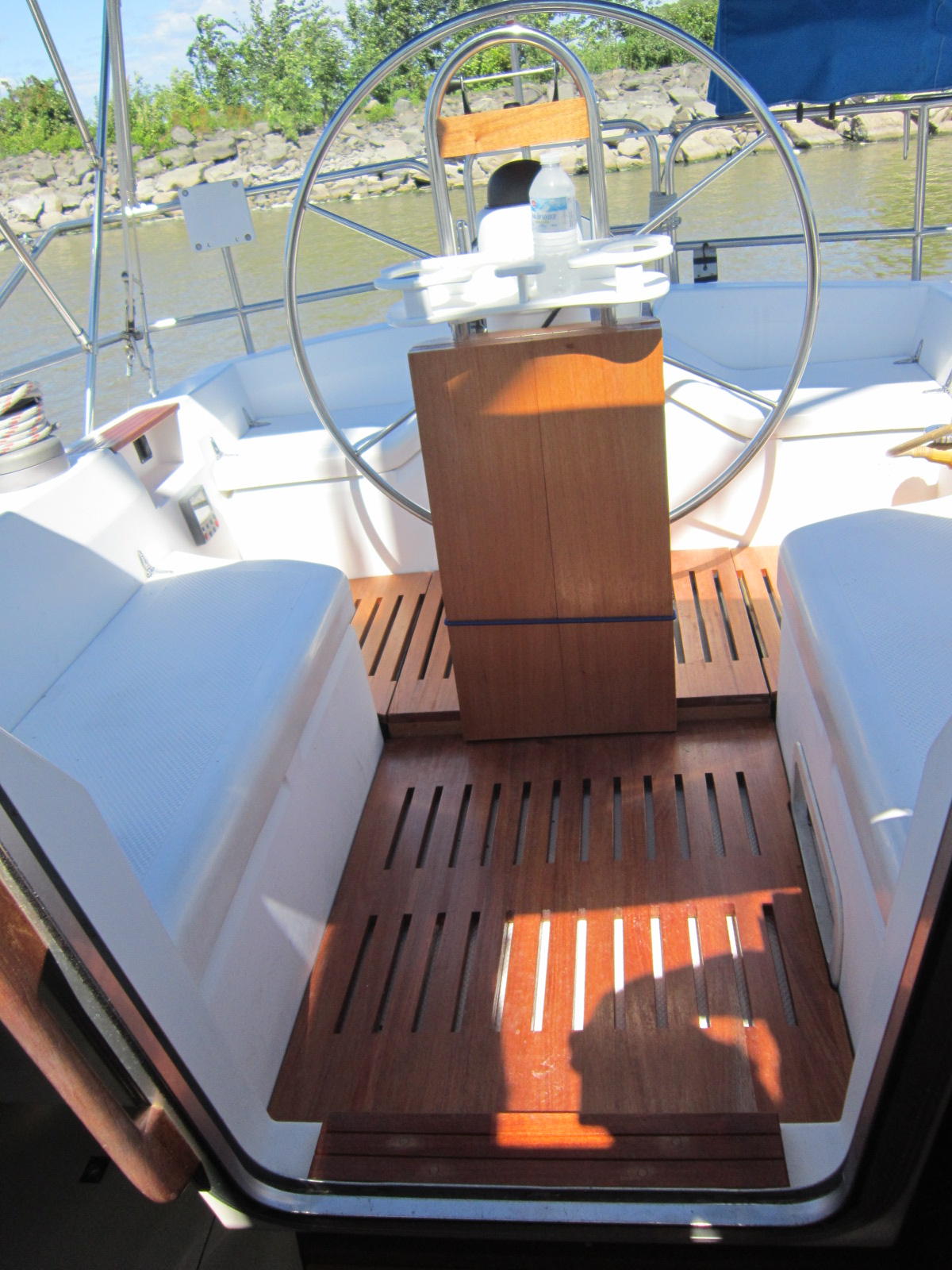

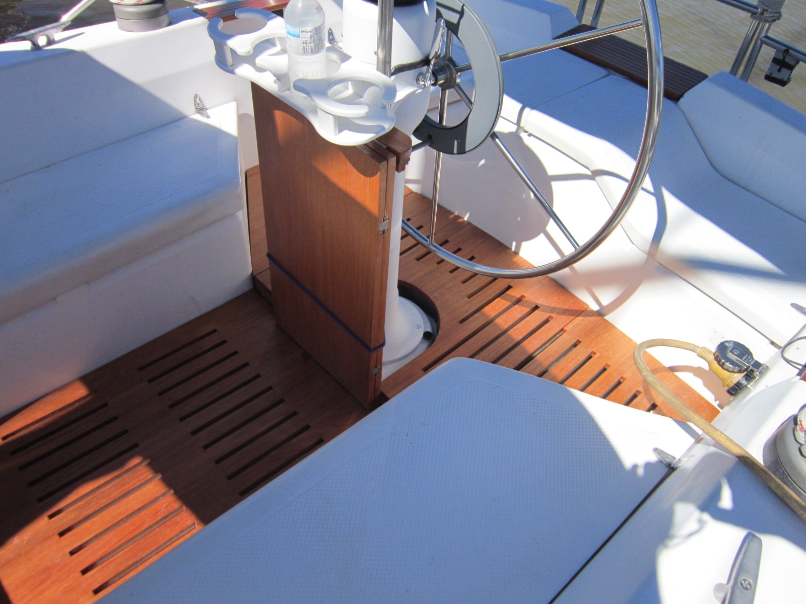

I'm 5' 6'' and I had the same problem. I need the dodger as I frequently sail down the St.Lawrence River towards the North Atlantic and or towards Labrador. So I eventually came up with a solution that works for me. Since my bimini is higher, I made a 2-step cockpit grate, with the area in front of the wheel being about 1 1/4 inch higher than cockpit floor, and the area behind the wheel being 4'' higher than cockpit floor. My 6' + friends complain a bit as they say now their heads is close to the bimini. I let them complain as it has worked wonders for me since I do not have to crouch or try to stand on my toes anymore when manoeuvering in tight quarters and needing best and easiest visibility.
