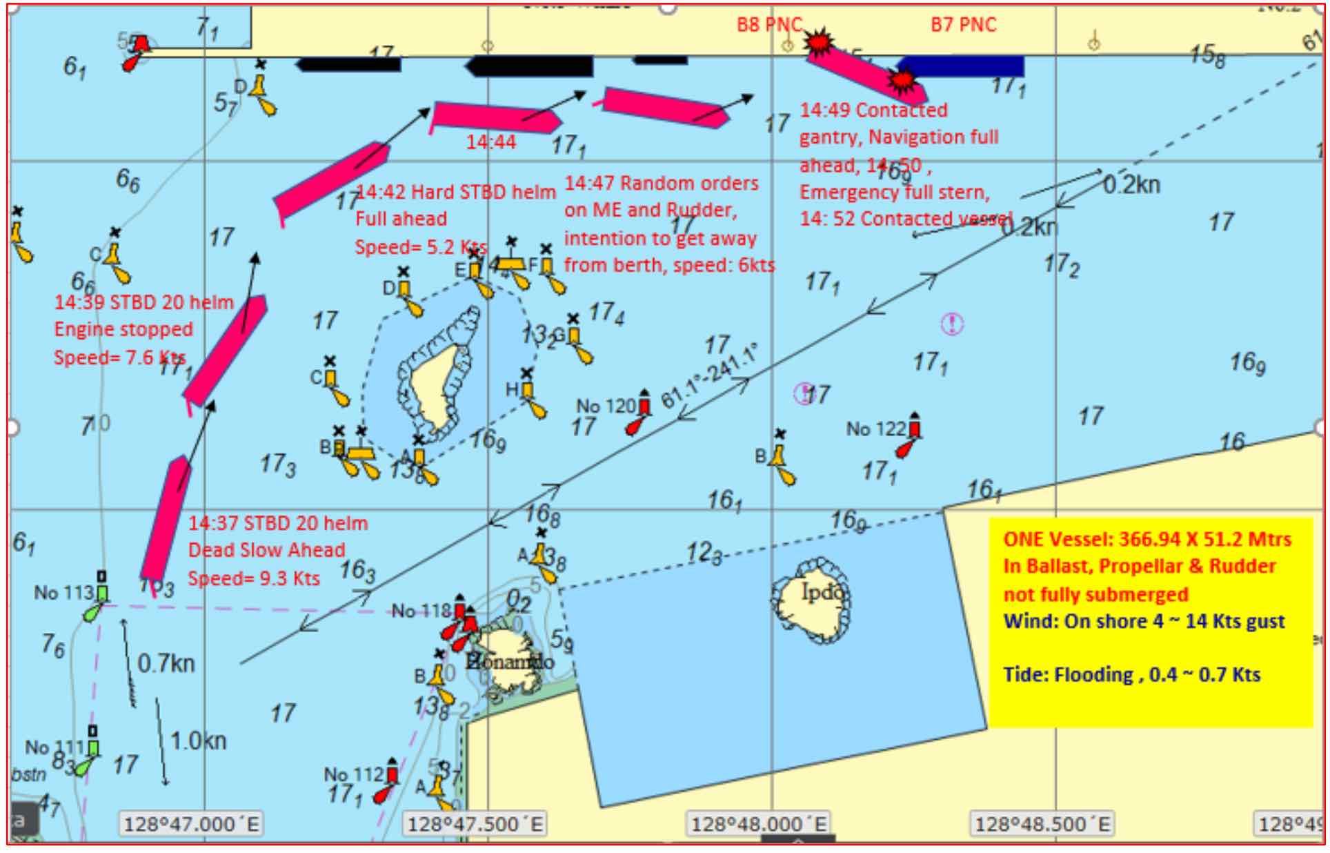

Containership Milano Bridge allided with cranes in Busan, one injured
"14:37: Commenced STBD turn, STBD 20 Helm, Dead Slow Ahead, Speed: 9.3Kts
14:39: Stopped engine, Speed: 7.6 Kts
14:40: Pilot appeared panicked, Speed 7.6 Kts, Dead slow ahead STBD 20 helm.
14:42: Pilot realizes heavy drift to port, panicked, full ahead engine, hard Stbd helm, concerned to avoid three (3) moored vessels. AFT Tug continuously pulling.
14:44: Cleared 1st moored vessel, drifting towards 2nd moored vessel, Navigation full ahead, STBD 20 helm, drifting further towards berth. FWD tug’s action not known as pilot speaking in local language. Master used BT.
14:47: Cleared 2nd moored vessel, random orders on ME and rudder, stern drifting towards port side, Speed 6 kts. 14:47: Cleared lesser beamed 3rd moored vessel.
14:49: Made hard contact with Gantry no.85 , fully collapsed on stern of ONE vessel. ME Nav full ahead, speed. 5.2 kts. FWD tug not pulling.
14:50: Emergency full stern to prevent contact with moored vessel ahead.
14:52: Hard contact with Gantry crane no. 81 by bridge wing, which was working on the moored container vessel ahead followed by slight contact with the moored vessel around Bay 02 & 06."
She was empty at the time of the accident.

It's clear to me that the pilot had far too much speed on. The aft tug was being pulled sideways because of the speed of the freighter. I think full speed ahead and 20 deg stbd rudder were ordered because the pilot decided to abort the approach - but he forgot to tell the aft tug to stop pulling. Not saying he'd have cleared the first gantry he struck!

I’d be curious to know what the speeds look like for a typical approach. Carrying 9 knots that close to the dock seems ludicrous to me, but I don’t know if that’s standard. Even the lower speeds in the 5’s after they bled off some speed still seems to violate the principle of not approaching the dock faster than you want to hit it.
After reading the account Will posted I’m not sure the approach was salvageable after 14:40 (between position 2 and 3). There was so much side slip that it might not have been possible to get back on track against an onshore wind, especially with the rudder and hull only partially submerged.

Its interesting that in the graphic Will posted all the other ships are facing the opposite direction, and you can see there appears to be deeper water to starboard. I believe who was ever trying to dock that ship wasn't coming in from the right direction to begin with, was he possibly attempting to spin 180 to dock and was pushed in by the onshore breeze? It would certainly explain the hard starboard rudder.....
That’s an interesting point. Looking again at the video it does look like we’re seeing the bow of the ship in front, and the bridge possibly on the stern of the ship behind Milano Bridge, which is consistent with Will’s picture.
Total speculation now but I wonder if Covid-19 has led to shifting of some harbor pilots or crews into situations where they have less experience. It certainly seems there were communications issues with the front tug Captain. And if a pilot were put on a ship with unfamiliar tonnage or in an unfamiliar harbor that may explain how he got into such a bad position.
