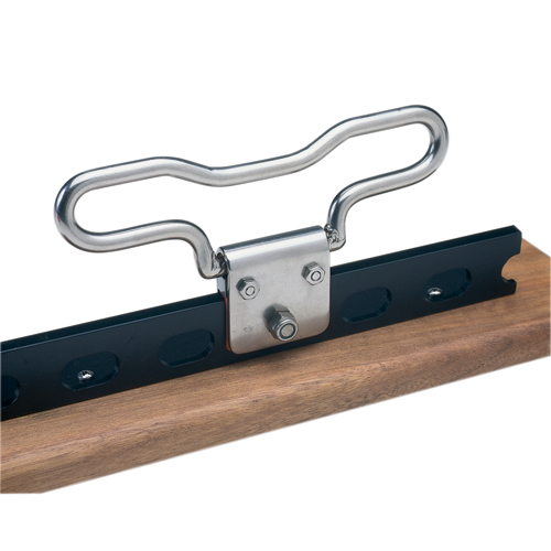

I would discourage you from using a snap shackle on your mooring lines. Besides the abrasion of metal on metal, it may be inherently dangerous to the hand when attaching and detaching. I can't see the advantage of spending $60-100 plus for a snap shackle for this application. You can buy an adjustable genoa track cleat from garhaurer for only $50 and you don't have to splice anything.
The Genoa sheets use snatch blocks, not cars. I was curious about that, especially for trimming, but the engineer in me saw no mechanical inconsistency with the shape of the rail. I honestly don't remember how it was done on my Catalina 27 because it was so long ago, but just looked at the toe rail and didn't see how a car would work anyway, so stopped questioning.
Apr 21, 2021
75
C&C 30 Harrison Township, MI

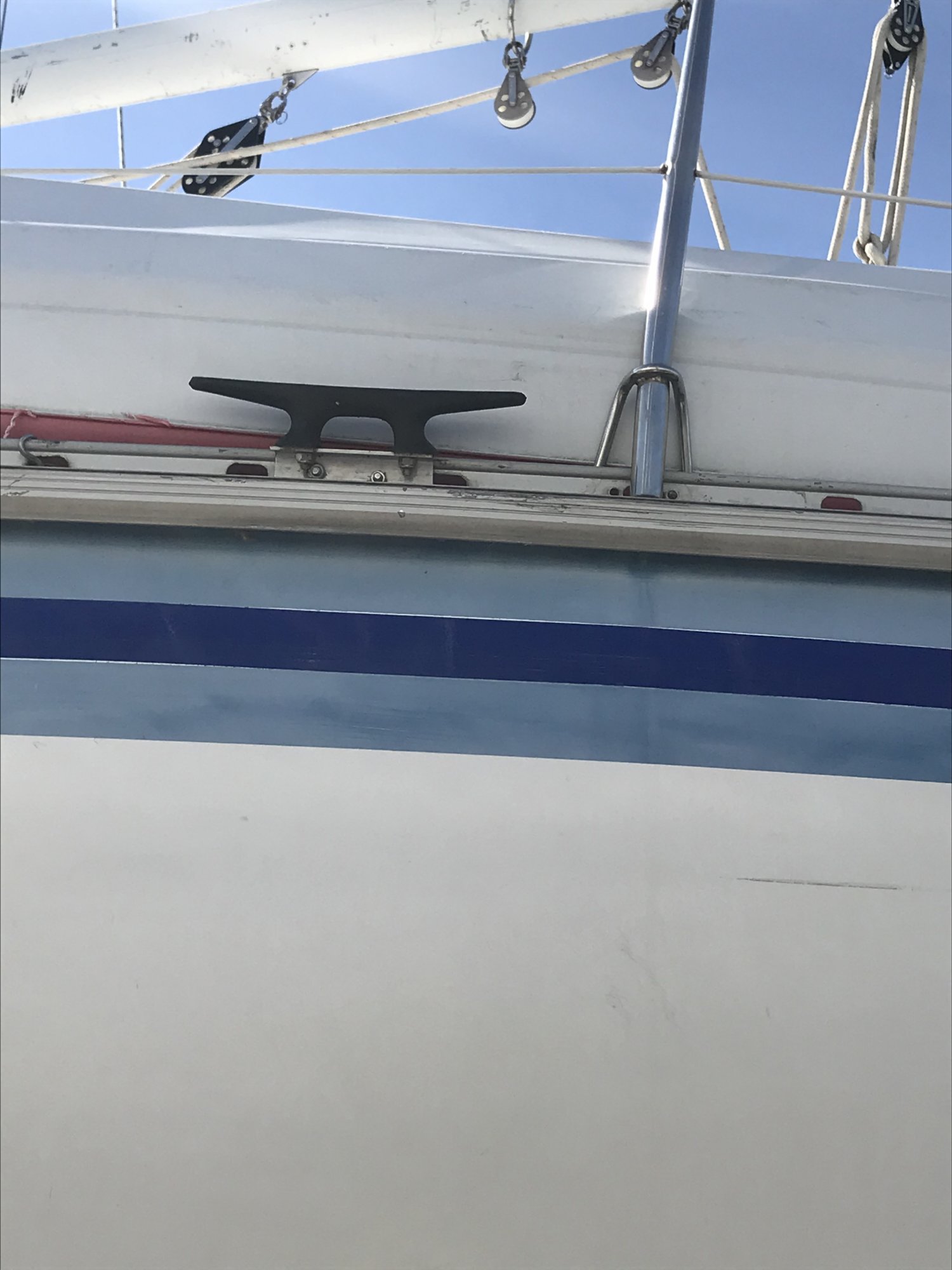

toerailcleat.jpgTwo of these (port and starboard) would set me back $200, a 2500 pound snap shackle a little more than $50.
As for risk of injury, I wouldn't be attaching or detaching under load.

Snap shackles on dock lines just don't make sense.... if they did you'd see them elsewhere. The fixation point needs to be firm and immovable, so the flexible dock line can absorb all the stress. I don't like the cleats you pictured either, but even a bolted on bow shackle or pad eye, that was fixed in place, would allow the large diameter dock line to pass smoothly through and be tied off with a traditional knot. A snap shackle at the end of a rope is going to rest in an unnatural position, and the constant flexing that dock lines exhibit 24/7 will be noisy and abrasive. A genoa lead block shackled to the toe rail has all its load going vertical... and the load, in general is consistent when the sheet is active, and non existent when the sheet is passive.
Anyway, good luck... hope it works well.
24,774

looked at the geometry and realized the stresses on the track would be closer to parallel than perpendicular, similar to the forces applied by the sheets. Heavy movement as you describe don't seem like they would change those angles more than a couple of degrees, unlike the increased stresses on mooring lines which would be appropriately cleated.
We have different water environments. My boat is in the water 365 while you, if like most in the midwest on the great lakes, take the boat up on the hard during the worst of the storms each year.
I'll grant you your geometry and that the spring lines trace a more longitudinal alignment than the bow or stern lines of most slip positions. When the boat is moving about in a winter storm, I have observed stresses on the dock lines in all directions. One winter storm with the boat tied to the slip the cleat from the dock broke free and crashed against the hull at about 2:30 in the morning. I leaped out of my bunk and was out on the dock as the gusts continued to blow through the marina. The boat action had pulled the dock cleat right through the wooden deck. Only 8 hours earlier it had appeared and felt solid.
Your toe rail and genoa tracks were not designed to sustain the type of repetitive pull tug motion through what can be a 60 to a 120 degree range by a boat in a gale condition. The backing on these metal hardware is often a SS bolt with a fender washer backing at best or a washer are worst. The repetitive action of a boat in a gale will work its best on the structure till something gives. If not the 1st storm then one sometime in the future.
I prefer to secure my boat to a cleat with strong backing plate.
Your boat, your sailing waters, your choice.
