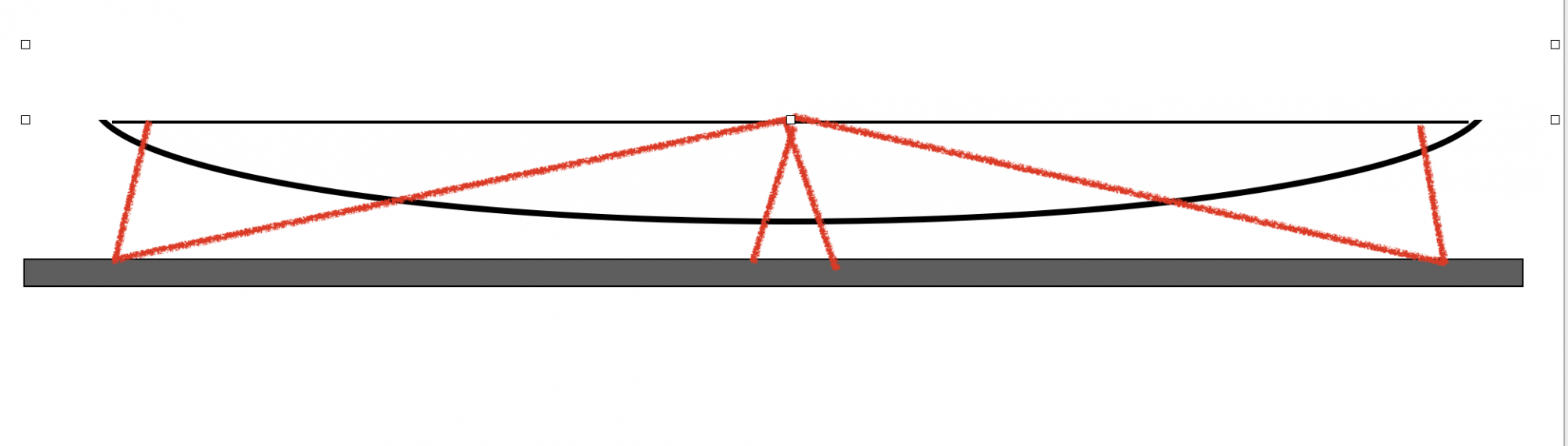

A guy was telling me about a different sort of tie that only uses two (very long) lines. Using the bow line as an example, it starts fixed to the toe rail or stanchion amidships, down to the dock then up to the bow cleat and finally back to the dock immediately below. Same thing for the stern. In this way each line fills a dual function of bow/stern line and spring line. Has anyone tried this or have an opinion on it? My first thought is it would be more difficult to adjust so the boat is sitting just right at the dock. (We like to pull our stern in for easier boarding.)
Adding to this, he suggested that the lines be tied off at the toe rail amidships and coiled/stored hanging on the lifeline when not in use. In this way, when single handing I can grab one of the lines and loop it at the dock amidships first, which will balance the boat at the dock. Then run it back to he stern or bow cleat, and back to the dock. I suppose you'd need a set of lines hanging on both port and starboard lines to allow for tying on either side. As I write this it all sounds impractical but thought I'd see if anyone else has tried.

No need to get complicated. Keep the bow and stern lines separate from the spring lines for the reason you stated. There are a couple of ways to rig springs. You can cleat them at bow and stern for running to a center cleat at the dock. Or you can use the bow and stern DOCK cleats to run to a midship cleat, or even a winch. But I see no advantage to the system you've drawn.
Our dock mates used this system. As you said, they had trouble adjusting the position of the boat. It tended to drift away from the dock, and then they had to stow a very long dock line. I installed mid ship cleats on the Genoa tracks and run spring lines forward and aft from them. We like to keep the stern close to the dock, like you do.

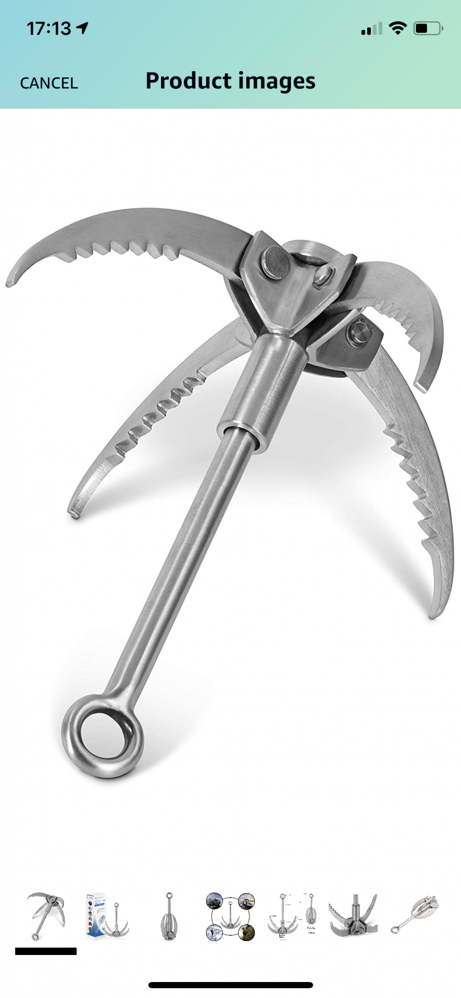

some docks only have a horizontal dock timber, especially in BC.
When I came up to the docks in Port Browning BC, the rails had an open end. I threw the line over the rail. It worked fine. When this is not possible I found this
A folding grappling hook.
Toss that sucker over the rail and you got a secure hold.
