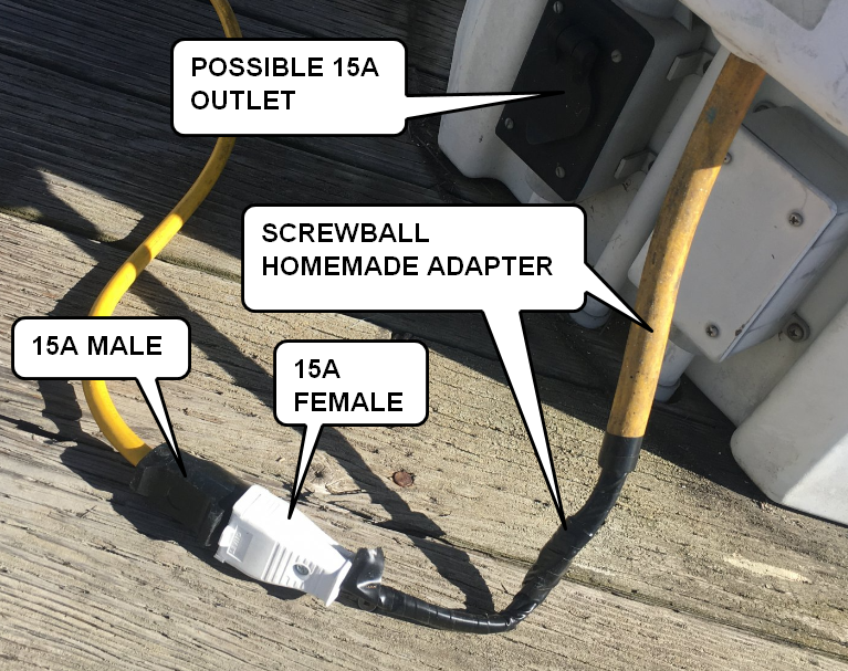

I am thinking there is a 15 Amp outlet right here
But I ain't got an extension cord that will reach from Vancouver to Chesapeake Bay, Fort Monroe :facepalm:.
Did you notice the length of the boat in the slip fed by this 15A box ? I keep meaning to look at the smaller boat slips in our marina to see what sized boxes they have.

The subject of this post seems to be about a 30A pedestal necking down to a 15A capable cord ... not good under any circumstance. :(
My picture was an edit from the original post. The black cover lower left on the pedestal.

What are you going to tell him (please post it here too)? I'm assuming your pedestals do not have 15A weather proof outlets. And don't use the words properly or meeting code unless you narrow it down. If not, you are asking him to leave and not providing services for smaller boats.
  • If you expect him to provide the fusing at the other end of the cable, define what is acceptable to you.
  • Define what type of adapter is acceptable.
Even the pretty MW adapters are not weatherproof or restrained. 15 A inlets are available, but most a re not weatherproof or restrained.

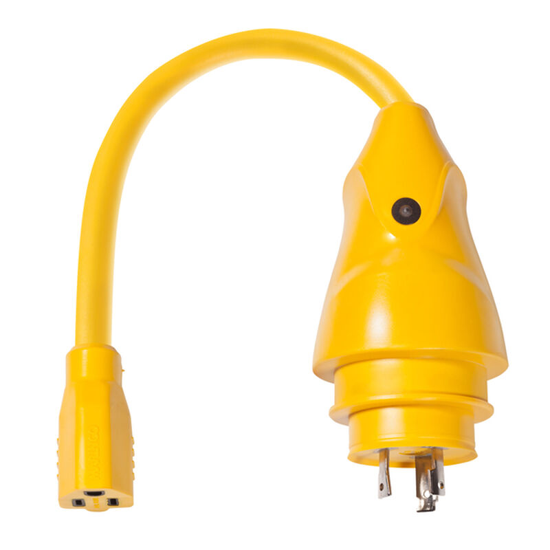

I have an adapter like this, but the other way around. Female on the big plug, male on the small end. It's great for when you're on the hard and you want to supply power to the boat just to give the batteries a charge while you're there for a few hours. To make sure they're topped off before you launch for example. You run a long (heavy duty) extention cord to the adapter and plug it into the boat (screwed in with the black outer ring). Very handy.
You're right. Didn't look that closely at the original photos. Pretty well guaranteed that's a 15A outlet under that cover. Yank the existing 15A male plug and insert into the 15A female supply socket. If the boat tries to pull more than 15A, it's SOL.

A 30 amp to 15 amp adapter is safe. Remember 30 amps at 220v is two 15 amp 120 volt circuits.
No what I see in the pics is not safe. It presents a shock hazard, especially if wet. The cord caps shown are for interior use only. A nice waterproof GFCI would be nice. Safety first.

What I find odd with this whole thread is, I am thinking there is a 15 Amp outlet right here
You know, I didn't even notice that. I know my box doesn't have it. To my knowledge there are no 15 amp outlets on the dock. I'll look at it closer next time I am down there. It may be a telephone outlet.
Anyway, a few days ago I sent an e-mail to the marina with a picture pointing it out and suggesting it may be unsafe and the adapter is gone today when I got back from a few days out.

Do I correctly understand you to say the marina removed the screwball homemade adapter ?
Did they leave the male end of the yellow extension cord laying on the dock or plug it into the possible 15A outlet which @Crusty Ol Salt had referred to ?
The screwball homemade adapter is gone and the yellow (and pink) extension cords are still there (not plugged into anything but the female side of the pink one still runs up to inside the boat).
Sounds like management didn’t put it there in the first place then. If it was their doing originally I think they’d have taken it all away at once.
