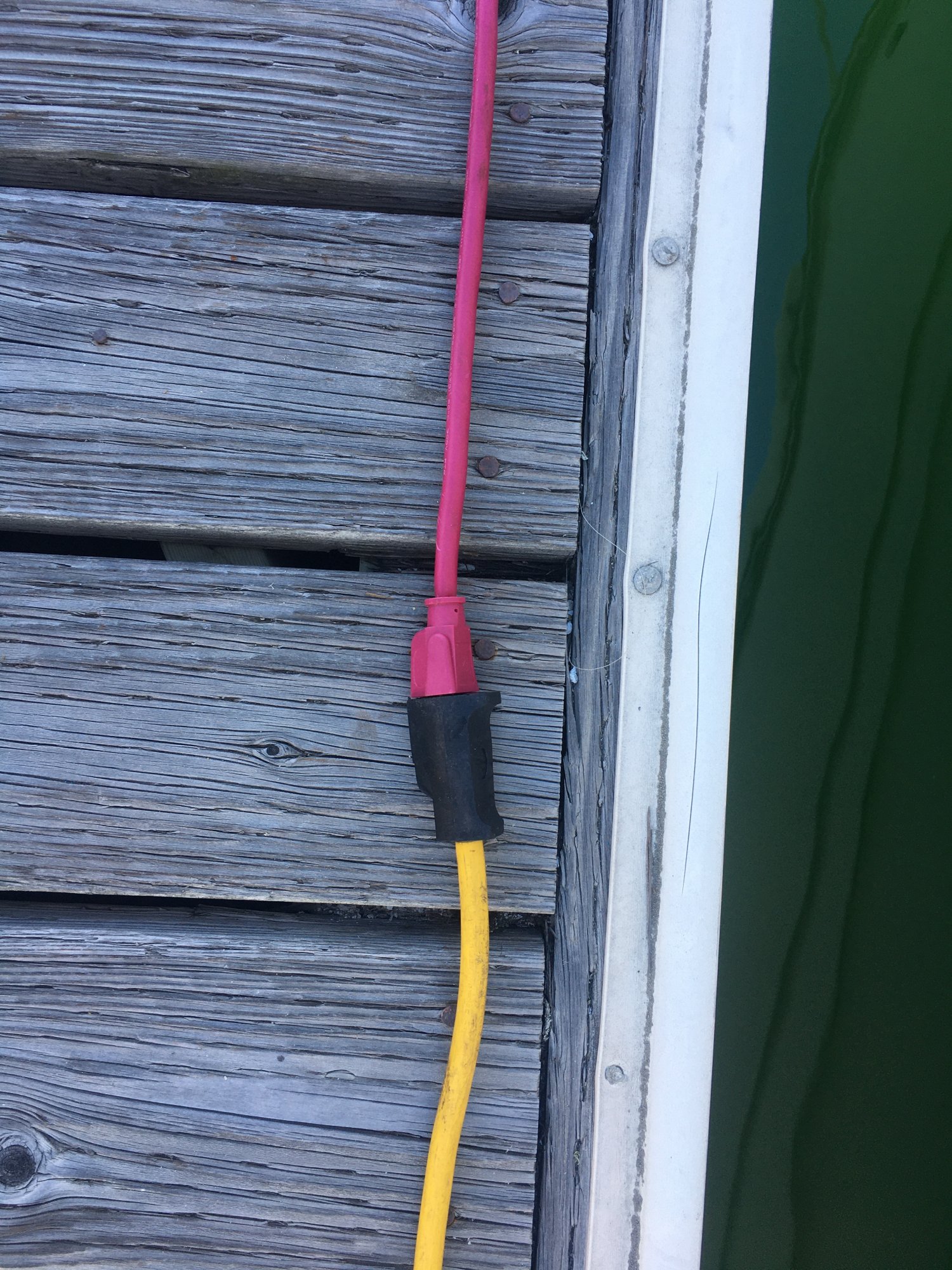

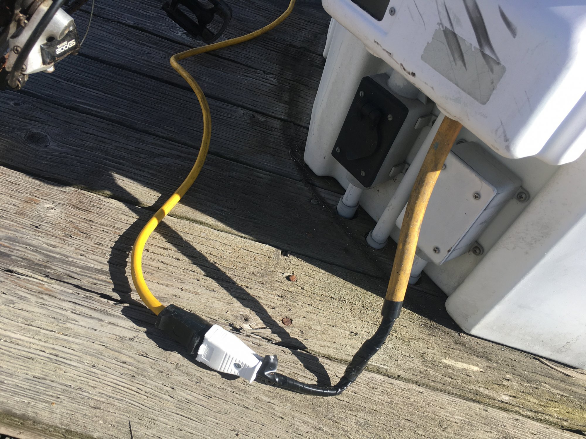

The boat in the slip next to me has been abandoned for about 3 years. Recently someone has cleaned it up a bit (which is great) but connected this shore power cord. Looks a little sketchy to me. Should I worry?

Yep. you should be concerned and express those concerns to the marina's management.
There are a bunch of faults here. The biggest is the undersized wire. The outlet is likely a 30 amp outlet protected by a 30 amp circuit breaker. The appropriate sized wire is 10 gauge which is what the wire from the pedestal looks like. The remaining extension cords appear to be pretty standard light duty cords probably 14 gauge or maybe even 16 gauge. 14 gauge wire is only rated for 15 amps. If something on his boat draws more than 15 amps the cord will be overloaded, but the circuit breaker will not interrupt the circuit until the it is drawing 30 or more amps. This will cause the cord to over heat and possible start a fire.
The plugs are not water tight and are exposed to the weather. This can cause ground faults. If the marina has any ground fault protection for the docks, the GFCIs will trip when even a little bit of moisture enters the plug. Additionally moisture can accelerate corrosion which will increase resistance in the plug potentially causing it to over heat and become a fire hazard.
California has enough problems with fires, it doesn't need a fire on the your dock. Talk to marina management.

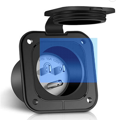

You response is technically correct... but it does not solve the problem for smaller boats with no AC system. They are NOT going to install a 30A inlet and panel just to power a battery charger, for example. There are pedestals with 15A outlets, but they are scarce. In a nutshell, the marina created the situation by supplying the wrong equipment for smaller boats. If they have an inlet, it will be this:
There are also many, many entire marinas with only 15A plugs.They don't seem to have the plug heating problems so common in marinas with 30A plugs, because they don't run heat of AC. The only load is a battery charger required to keep the sump pump running. Since the engine actually keeps the battery up, the normal current is no more than a few amps.

Hopefully they do something. What I see is a 30a shore power cord cut about 18” or so from the plug that was spliced to a 10a extension cord with a DIY repair plug on the end of that. Then wrapped in black electrical tape that is coming apart. That is then plugged into a 15a extension cord that is then plugged into a 10a extension cord. That is a fire on top of a fire waiting to happen even with a 5 amp load.
