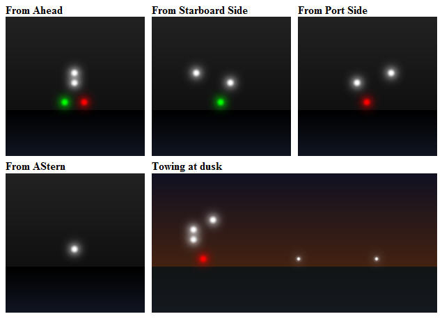

While the argument is made that somehow a masthead makes you more visible in the open ocean, I can assure you that your disembodied masthead light disappears into the coastline twinkle of lights. You fade into the mess of radio towers, building lights and anchor fields. And it is those coastal approaches that represent your best chance for collision. As Capta notes, night sailors are scanning the water ahead, not the horizon.
In a busy anchorage it also helps to augment your anchor light by switching on your deck light, and turn your deck into a well-lit reflective surface. One of these solar lanterns hung high in the cockpit will really distinguish you as an anchored boat...and not someone shoreline porch lamp.

I assume it is heresy to ask the question, but what is the downside of illuminating your masthead tri-color and your bow and stern navigation lights simultaneously during a nighttime sailing situation in a coastal area where large ships are present? If it gets noticed one way or the other, what is the harm?
12,955
It's not legal.
It will be confusing. Is it one boat with 2 sets of lights? Is there a large boat right behind a small boat?

What dlochner said. Dangerous. Most advanced certification programs make you ID light patterns based on random aspect presentations in the DARK. Cause that's how life works.

Understood that it is not legal, and I imagine that it could get the offender in trouble if it was brought to the attention of authorities. I think the confusion was part of my reason for asking ... confusion could get the watch paying closer attention until they realize it is just one boat. What difference would it make if the watch thought there might be 2 boats in the same direction if it got them to pay closer attention. What difference would it make when they realize it is just 1 boat. It shouldn't make any difference in their decision making process. The one set of signals would only mimic the other set of signals and be in very close proximity, so there would be no distinction in how boats around them should react. The lights wouldn't indicate conflicting positions. It would look like one small boat with waterline lights and another small boat with masthead lights right next to each other going in the same direction and at the same speed. Why would that make any difference when it is discovered that it is just one boat? It may be misleading, but I don't see how it could lead to a dangerous crossing. Just give me one good example where it would be dangerous ... ;) (that's a challenge)
I know it is a silly question. I rarely see lights that are that distinguished, especially when they are head on. The red and green bow lights usually bleed together, as would a masthead tri-color.

I know I'm getting myself in trouble here but in heavy fog like we get here in the PNW. I worry about two different types of folks seeing me 1) large ships with the bridge 100' off the water and 2) the pleasure craft. In our fog my mas may be in clear air but I can't tell at water level. If I only have the bow bi-color on pleasure boats Stan ashamed of seeing my light, the container ship not a chance. Conversely the container ship might see the mast head bi-color that would be totally invisible to the pleasure craft. I doubt I would be charged with a violation in that situation for having both on. As I said earlier I do what ever I think will give me the best visibility
