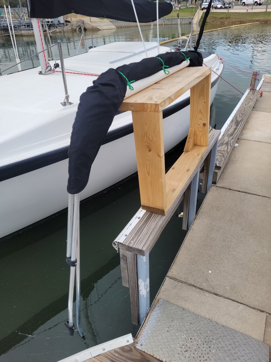

Several responses mention difficulty of storage as a reason for leaving the bimini on the boat. I rigged a storage solution from 2x6 and 2x8 lumber and a section of lightweight landscaping drain pipe to hold mine. Marina management was OK with me installing at my slip as long as I did not block the path. See attached photo.

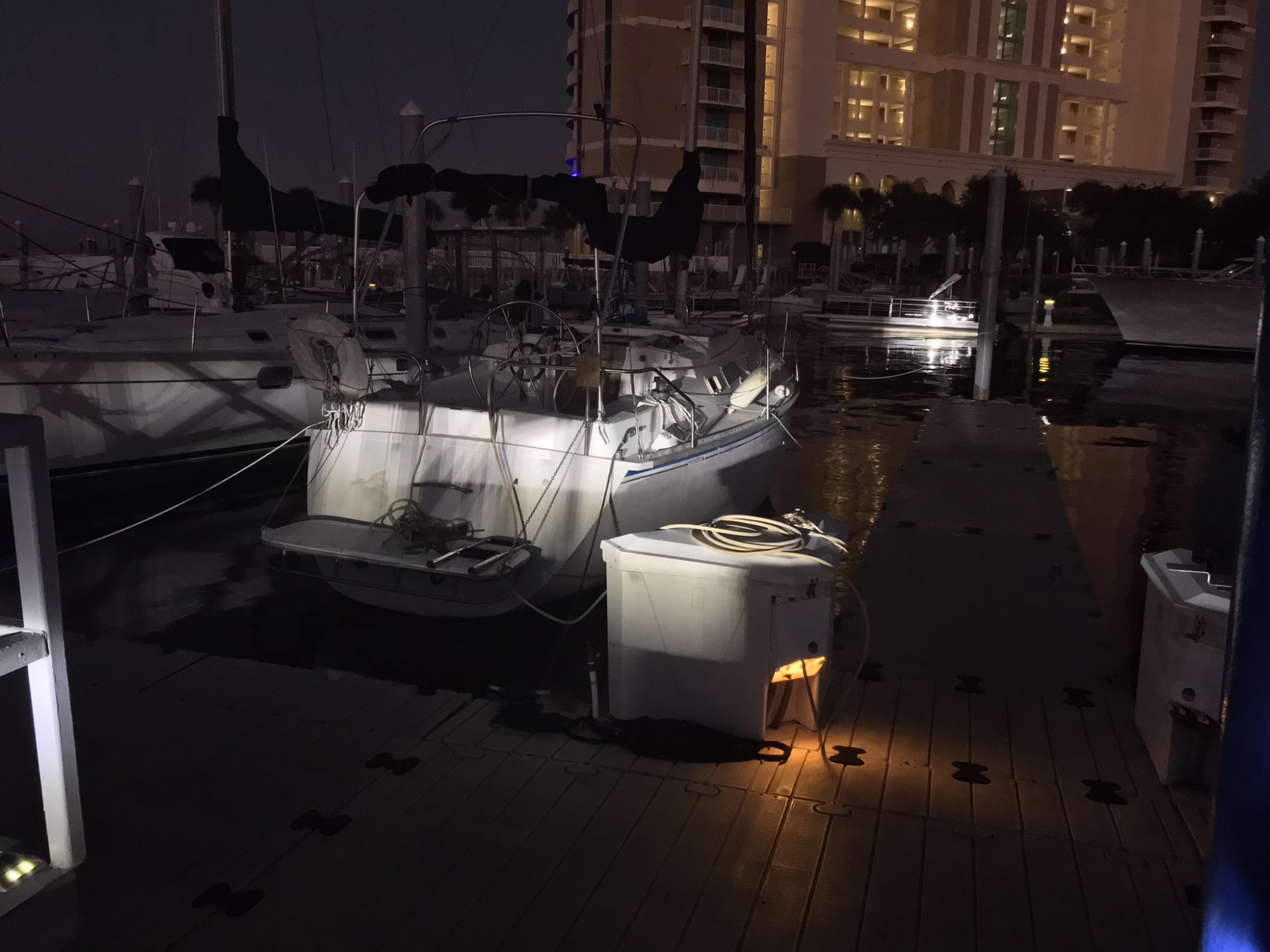

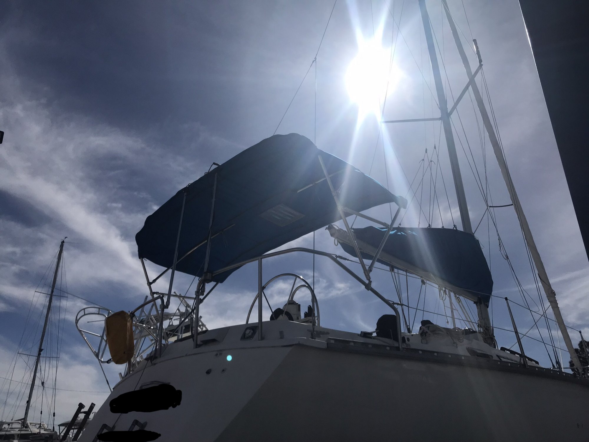

Here are some pics. The nighttime one is my boat with the Bimini up. I’ve looked around and it looks like most boats would look like this when theirs is up unless bows are removable.
The daytime pictures are of what appears to be the same boat. It doesn’t look easy to take down, but is close to what I’m looking for. Each backstay has a zipper that goes all the way to the outside to let the backstay out. Good idea. Seems like the best solution would be having those zippers going forward and having a joint at that point in the front bow. That way the whole thing can be flipped back and meet up with the rear bow.

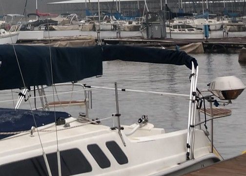

Our bimini came with the boat. We are the third owners. It is a '98 Hunter 240. We have had the boat for a year and a half. We put the bimini up three times before we figured out how it was probably made to function. In order to sail with it up we had to move the mainsheet block forward to a reefing bale. The bimini does fold up and has a zip on cover. We then Velcro strap it to the rear cockpit rails. This allows the rear elevated cockpit seats to be usable. We tend to leave it up most of the year. We are on a large lake and have shore power and water. My daughter lives on the boat several days a week.
