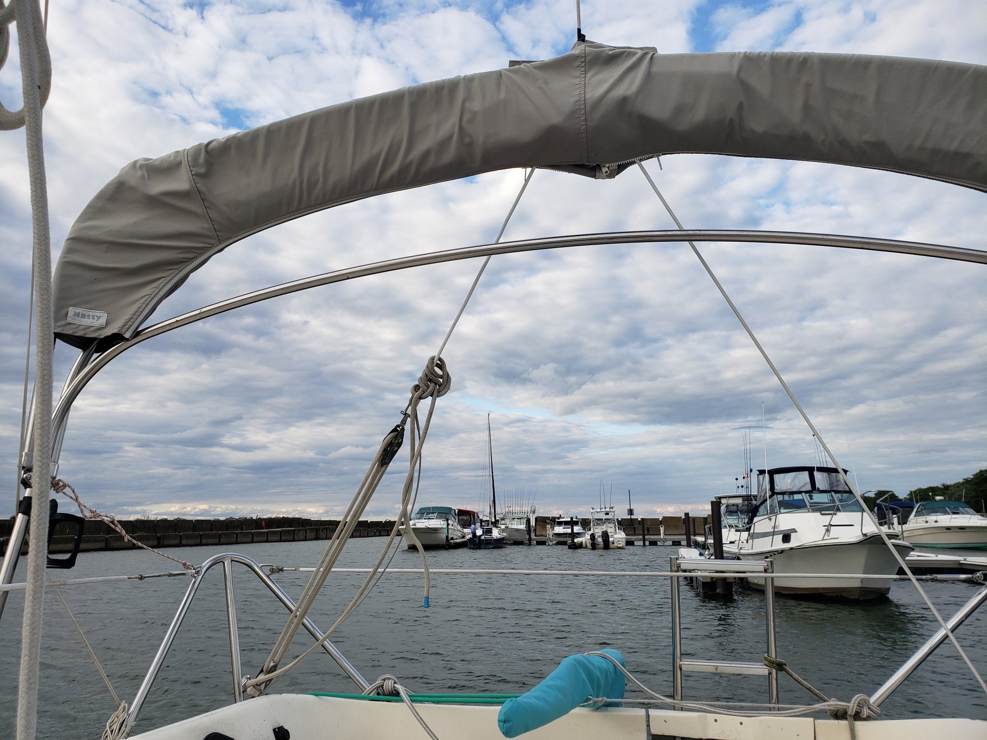

I have a cover. I put the three bows together and cover the canvas with a cover. I cover it whenever I'm not in the boat for a few days. I only have to remove it from the center bow.

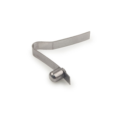

Mine has telescoping tubes. The tubes mounted on the boat are slightly smaller than the frame tubes, so the frame fits over them. When sailing, it's down all the way, at the dock or anchor, I can slide it up another 8 inches or so. Still not standing room though. It is held in the up position with clips like these.
