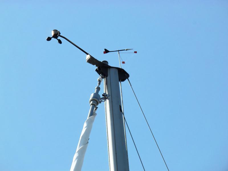

This is a photo of the top of my mast on an Oday 28. With the new Roller Furling Sail I have do I really need the Halyard Restrainer to prevent Halyard Wrap of the Forestay? I know the Sail will stretch in time and the Harken Restrainer I have in place now as seen in the photo will either need to be moved up or do I really need it considering the amount of Furling tube exposed at the top of the forestay. Any opinions?Roller Furling and Mast Head..jpg

Have you read the Harken website? IIRC, it discusses the preferred/necessary angle for the restrainer.

Yes I have checked the site. The angle of the halyard would be parallel with the forestry which is acceptable but the best is with a halyard restrained. With a distance of just under 6 inches do fuller tube shown and future stretch of the new sail I was just wondering if the restrained was necessary. if you look at the photo the halyard is almost two blocked right now. thank you for your reply.

I understand. Is that a snap shackle up there? If so, you might want to reconsider and use a D shackle, smaller and could get you more room and be more secure. Do you have any "wiggle room" at the tack?

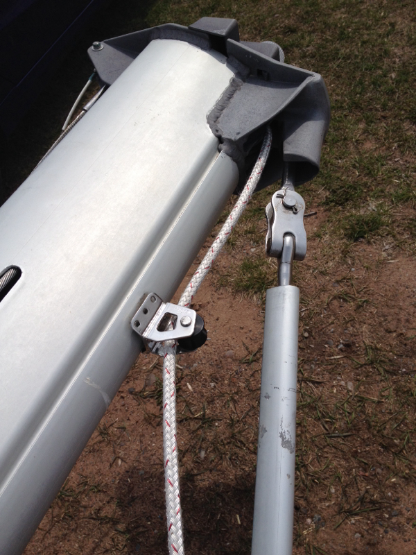

I pulled my mast and replaced all of my standing rigging when I purchased my Pearson in 2012. The rigger suggested I replace my halyard restrainer as it was very worn due to my wire jib halyard, so I did some research. I came to the conclusion that it may not be absolutely necessary, but it is designed that way for a reason. The halyard lead just didn't seem right for my roller furling without the restrainer. Just my opinion, but it doesn't seem like an expensive enough part to skimp on.

Great idea using the D Schackle. I never thought of that. It should get me 2 more inches. Thank you.
