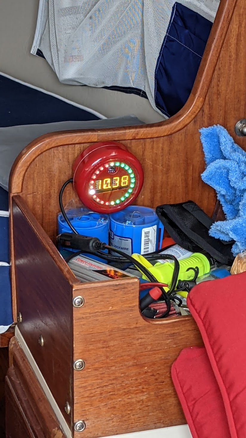

A few years back I built a wind instrument and I've been using it for years now and really appreciate its functionality.
Here is a picture of it on my Catalina 22:

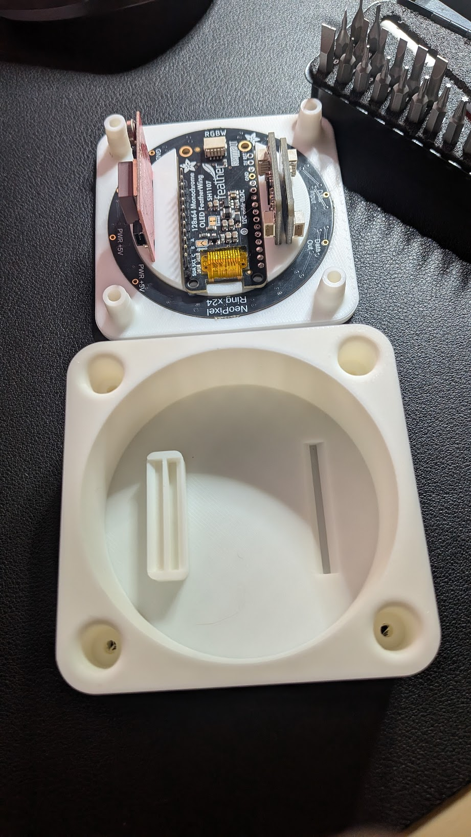

This first version was somewhat difficult to build and the software took me quite some time to get to where I was happy with it. I do have the original Arduino C++ code and I was about to try and compile it again to dig into fixing a problem with my setup when I found out that all the libraries had been updated and I remember there was an incompatibility I had to modify the libraries to make them work and it was just more hassle than it was worth.
So instead I'm deciding to do a new version of the wind instrument. This version will still be using Adafruit hardware but I'm going to redo things using an RP2040 based Adalogger rather than the M0 that was used in the first version. I'm also planning on replacing the Alphanumeric display with an OLED feather that also comes with buttons. Then I'm redesigning the case so that you can use Adafruit's breakout boards that I used in the first version with out soldering and adding connectors near as much.
I'm planning on simple instructions on how to build one but it should require fairly little soldering (if you can solder 0.1" headers that is all about all that is really required). Then you 3D print the case and heat set brass inserts into the plastic case. then the boards screw into the case and plug together... As I finish the first one I'll take pictures and show how it goes together. I hope to have the software done by this Summer but so far I have a working menu that drives the buttons and display on the OLED. Once I get more hardware I'll get the LEDs going and bring on real sensor data (right now its just random data).
Any interest in this or am I the only one? I'd say its going to cost about 300 dollars for a system including the anemometer. But I'm probably forgetting pieces... Its still cheaper than the big box marine guys who are usually well over a grand for a full system and they don't have the weather sensors.

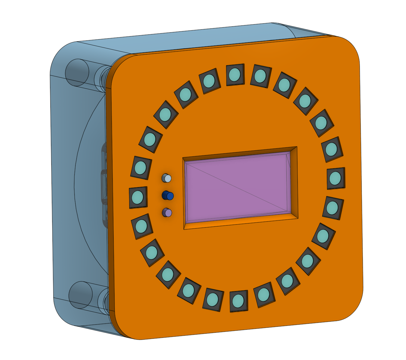

Here is a picture of what the new version is looking like at the moment in the current mechanical design:

Yea it does a lot that I've not mentioned quite yet... But that stuff is what the old instrument does and the new instrument I don't have the code done yet so I don't want to go spouting things it can do until it can do them....
But this has barometric pressure and temp sensors as well as a full 9 DOG IMU. So it can indicate heel and it can use all of its sensors to give you a compass and it can calculate true wind and show you that by subtracting out the boat's movement. It also will give you statistics at the end of your sail such as average wind speed, average wind direction, max heel angle... And then all of these stats should get written into a folder for the year and then inside of that folder will be GPX files that when opened can display a map of every trip you've taken and you can click on the track to see more information about the state of the vessel at that time.
I have it setup where you write you home slip location into the SD card in the text file and then when you leave that location it starts collecting stats and when you get back to the slip it locks things down and writes a record into a CSV file that at the moment matches the format of the manual logbook I pictured above.
The real hope and dream is that I get this thing done enough to be functional by summer... Then I'll setup the auto pilot and toodle around on the lake while I think of new features and try to implement them before I get to the other side of the lake. hehe.
Oh and yes that location inside the boat can be easily seen from the helm position through the companionway (if you helm from port). Now that I think about that I may need to add into the menu some brightness settings cause the last version of this had an ambient light sensor and it set the brightness of the display automatically based on sensed levels.
The first version used a gesture sensor that you waved your hand in front of it from top to bottom or bottom to top or left vs right... The theory was that I was going to be able to seal things and shoot the IR from that sensor through a plastic window. Turns out in the end getting that sensor to go through a window without just light piping through the plastic was near impossible. So I had to cut a hole to let the light out. Then the user Karate Kid user interface as I called it was good enough for me but flaky enough that I was the only one who could use the instrument. Thus why this version is just going back to normal buttons.
