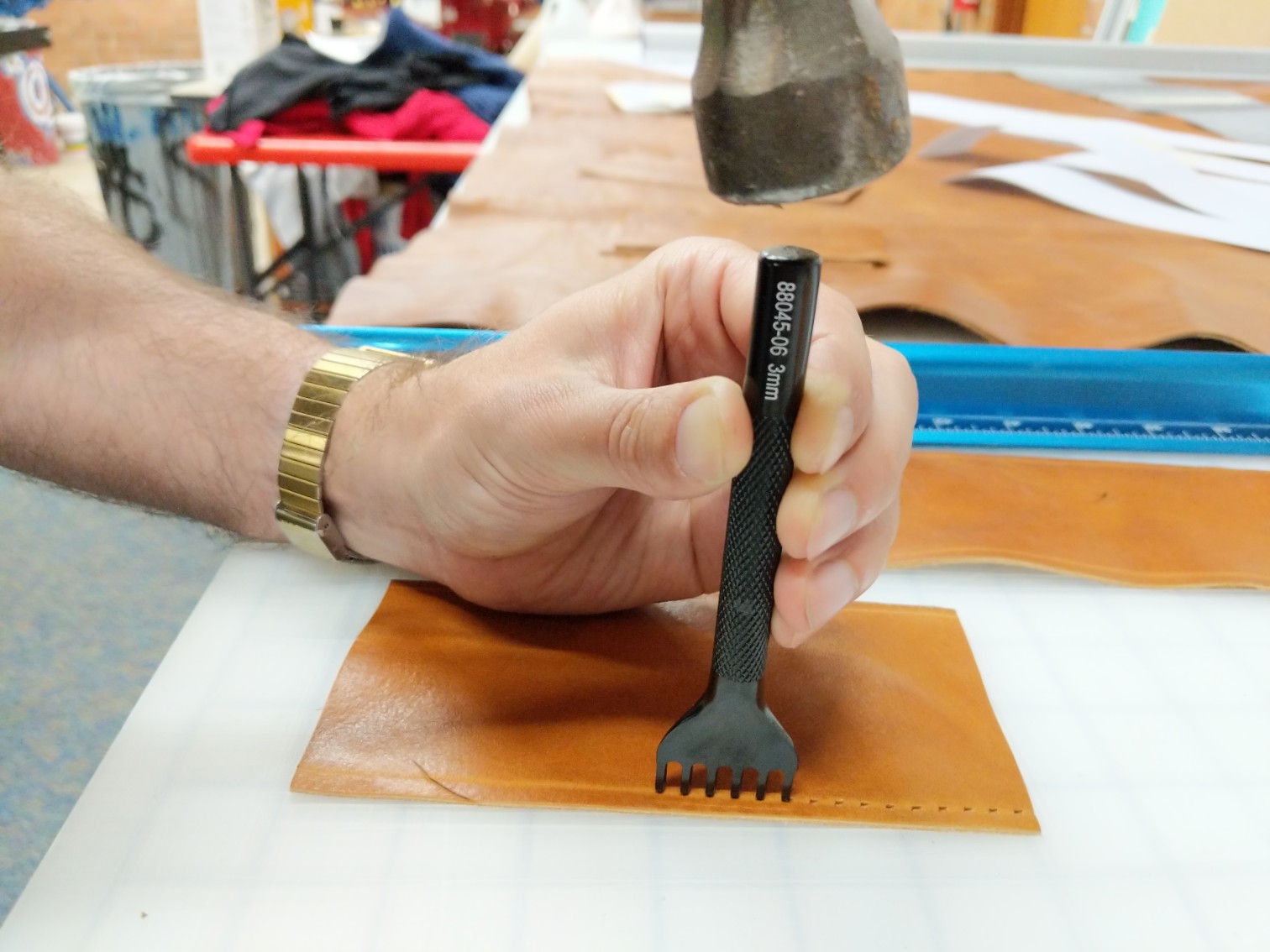

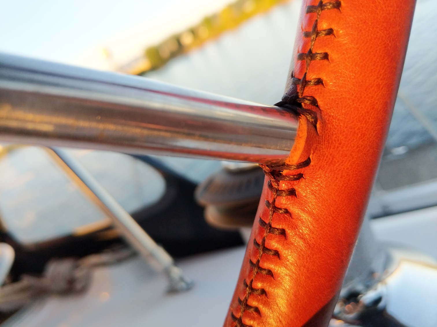

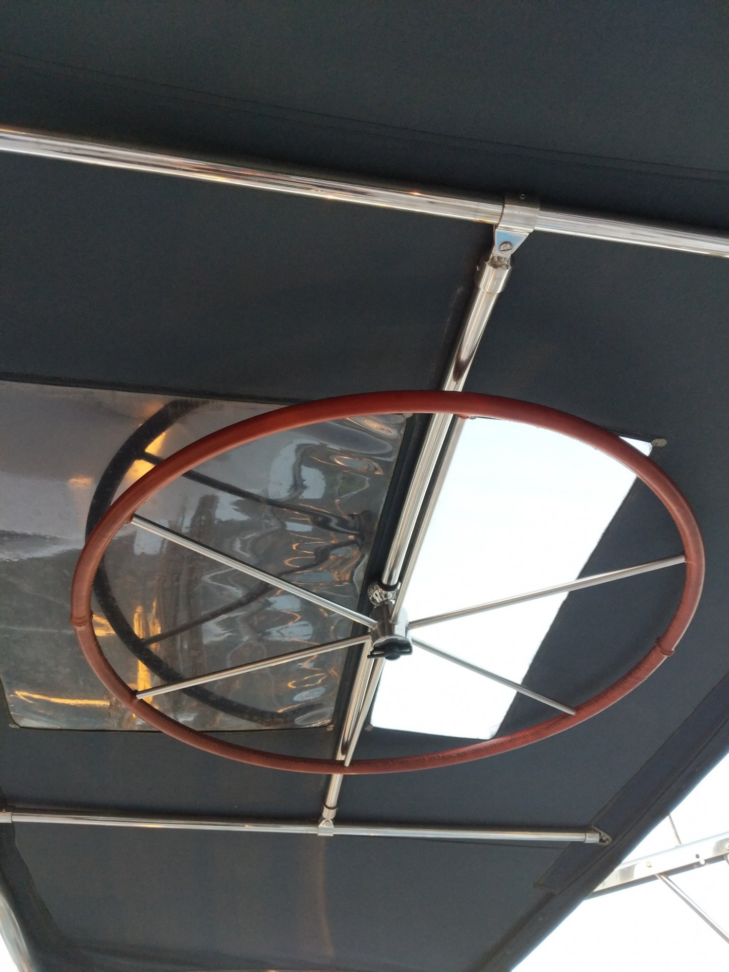

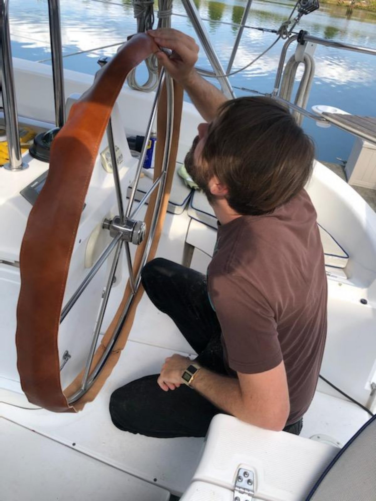

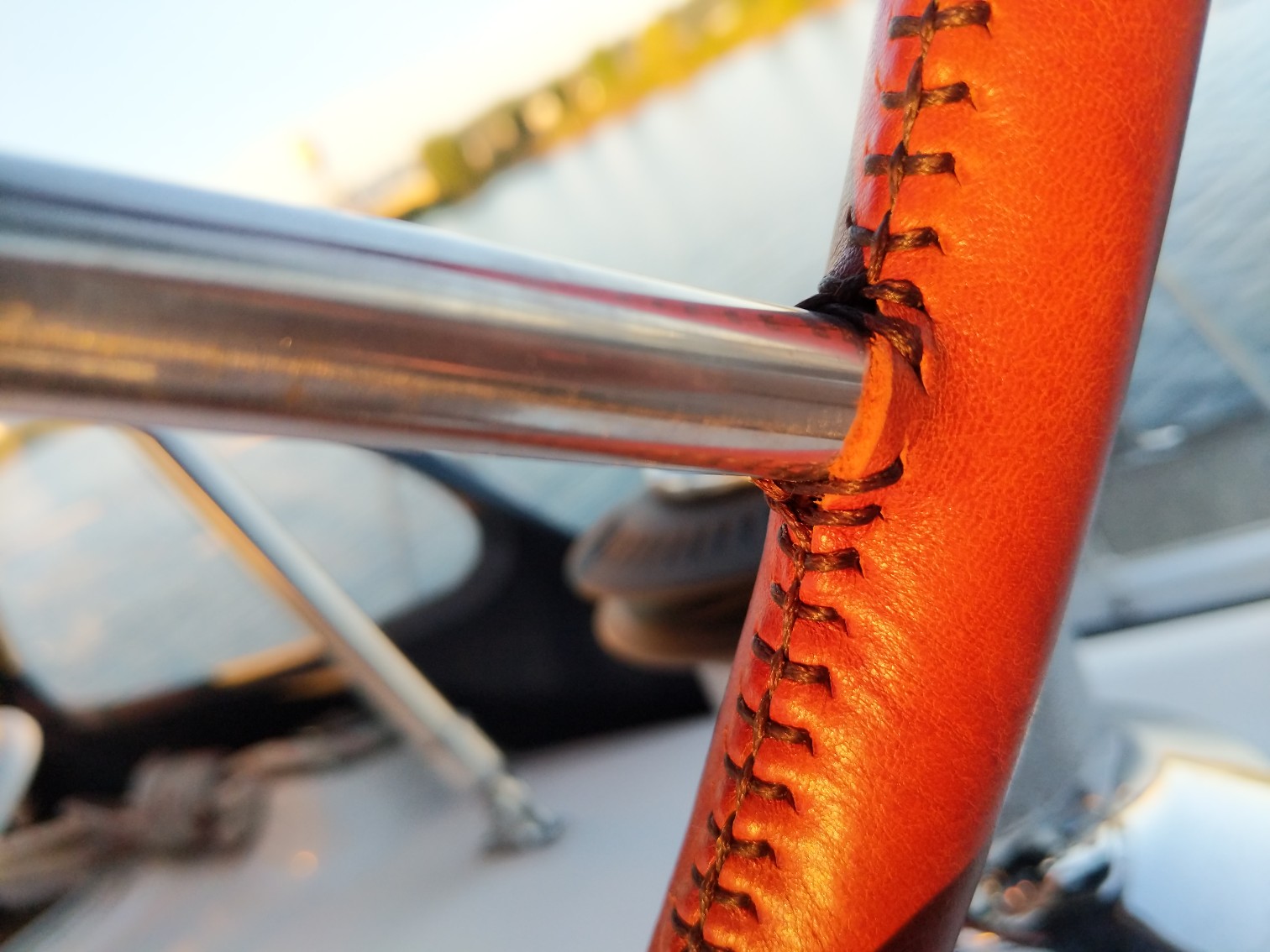

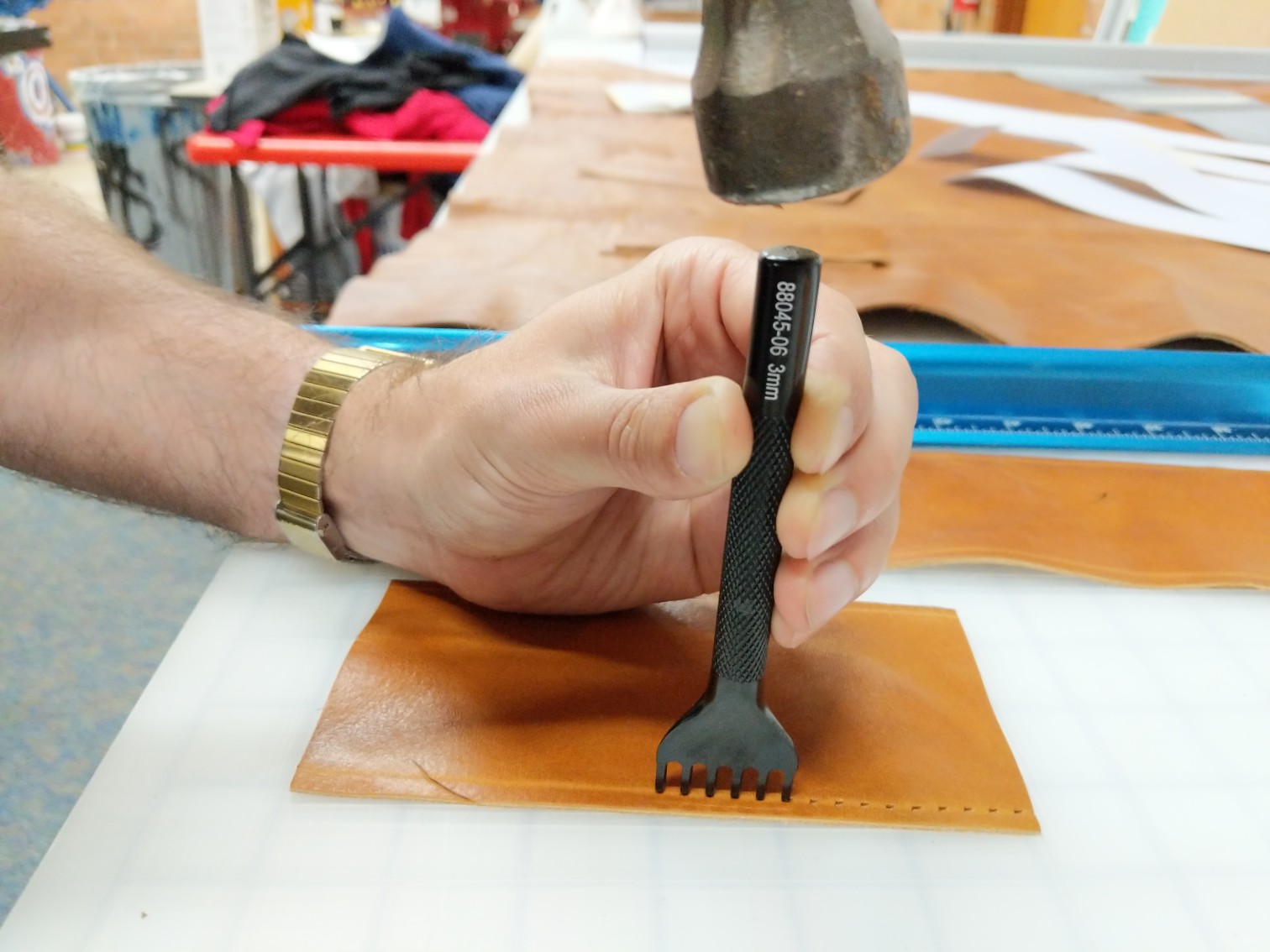

When we purchased our new to us Hunter 466, the wheel had a cover but it had some holes and was flaking off. It was navy, which I hadn't seen before and it exacerbated the worn look to it. We looked at replacing it but the kit was over $250! So we thought it would be fun to try making one ourselves. It was such a fun project! After going to a leather supply store and buying an entire hide and the tools, we did it for less than half the price and had extra for other handles and projects as well. One of the most satisfying boat projects to date. Also, we store our wheel overhead in the cockpit as we liveaboard and get on and off the boat through the sugar scoop. Keeps it protected and out of the way.

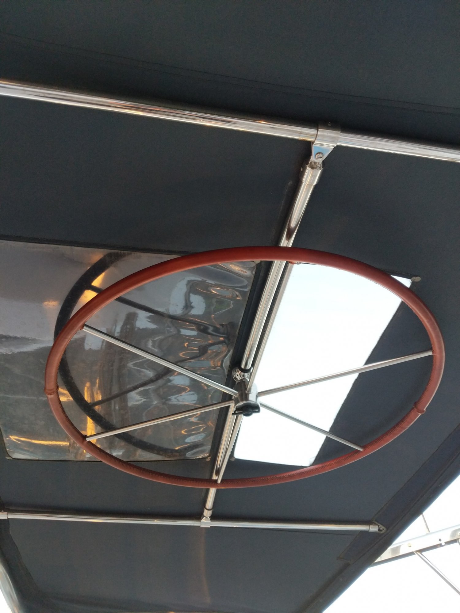

Also, what do you mean by storing the wheel overhead?

It was an Italian whole hide from Tandy Leather. Finding one big enough was difficult, we ended up taking the two biggest strips we needed out of the hide diagonally. We also did 3 other grabrails and the stainless rails on the stairs coming from the cockpit down into the boat. Being able to see and feel the hide was important. I had always wanted to do a leather project, this was a big one!
dj
Ah, now that you point that out I see, when I first looked, I didn't understand that image...

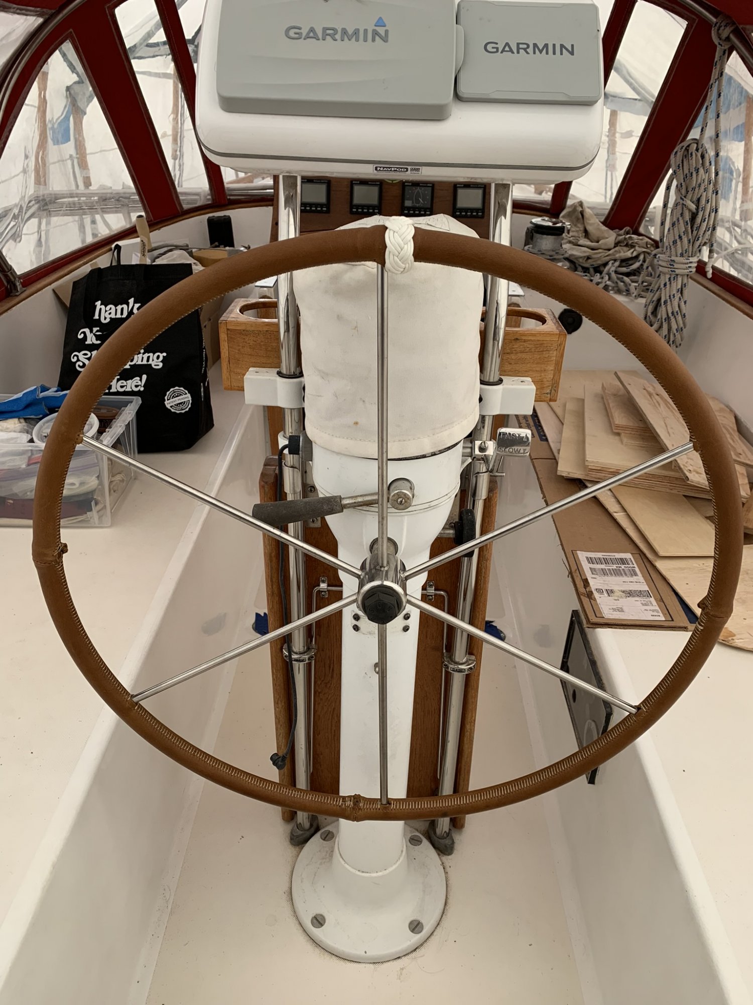

Well done. I also have a 466 and I too put a leather cover on the wheel but with a foam layer underneath. Very comfortable.

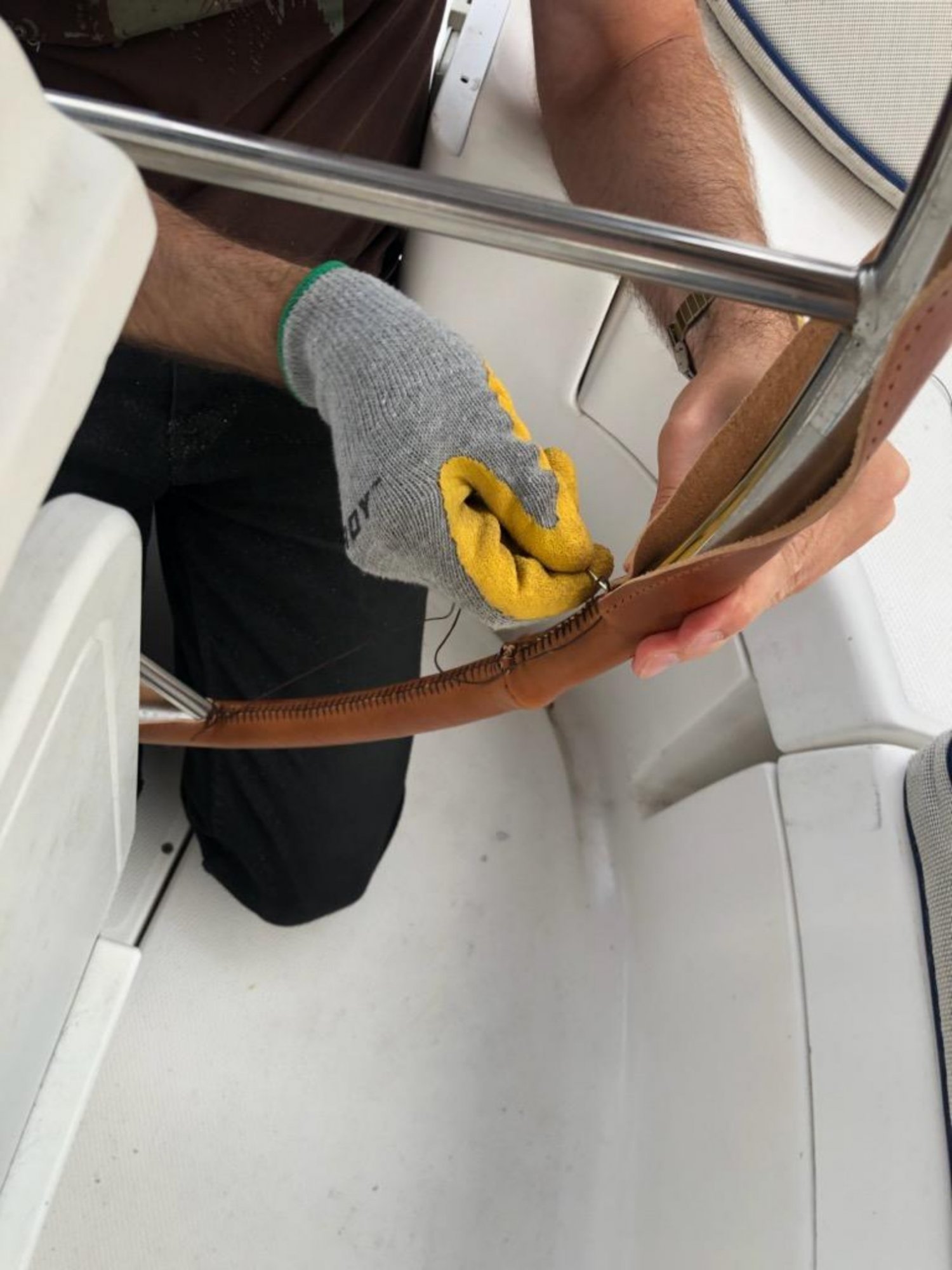

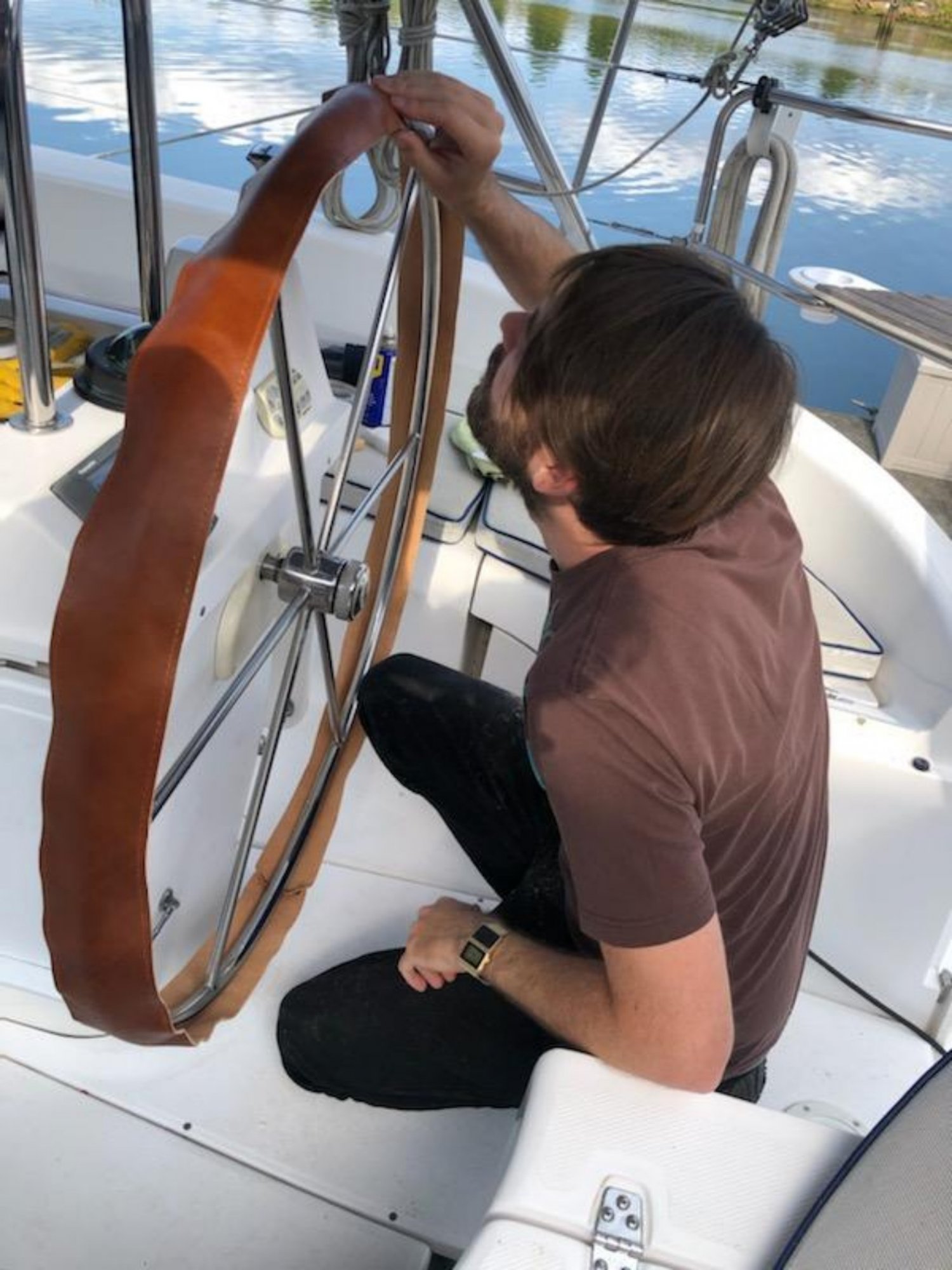

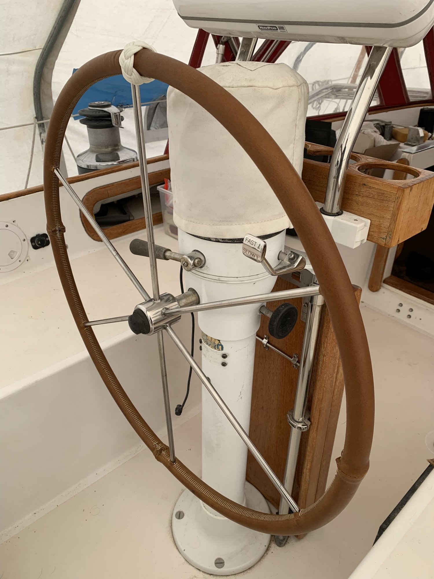

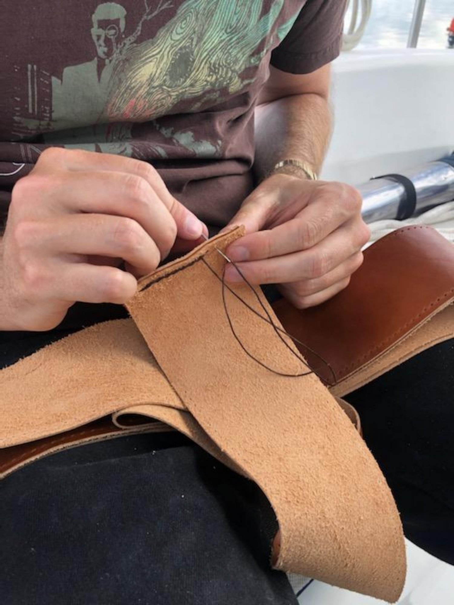

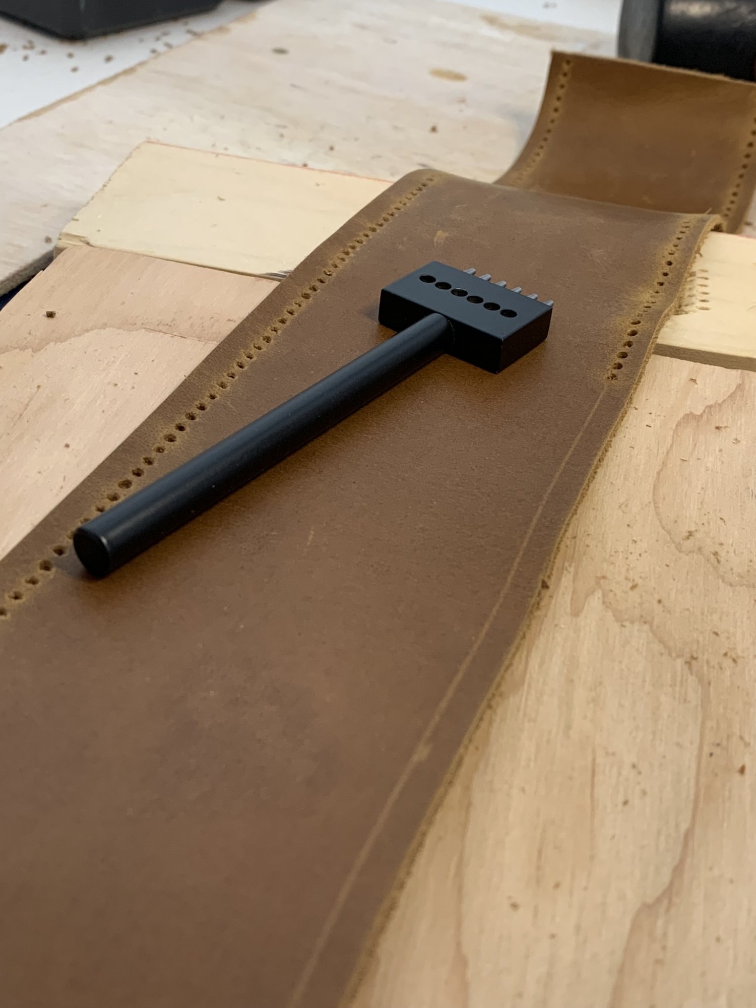

I just wanted to post a note of sincere appreciation for VisionPNW's detailed notes and pic's here! I used it as inspiration to wrap our own 28" wheel, and I'm super pleased with the results. For anyone else who's interested, I thought I'd share some of the details and learnings from my own project.
The leather hide: After reading and researching, I felt comfortable enough making a purchase online (i.e.: sight-unseen), and ended up purchasing a 12" x 24" piece of 2mm full-grain leather from RingSun Leather on Amazon, in "Bourbon Brown". I am VERY happy with the choice. It's feels like the perfect weight and color.
I applied a good leather wax sealant for waterproofing when the project was done. I believe I can simply reapply annually (or perhaps semi-annually).
KEY LEARNINGS:

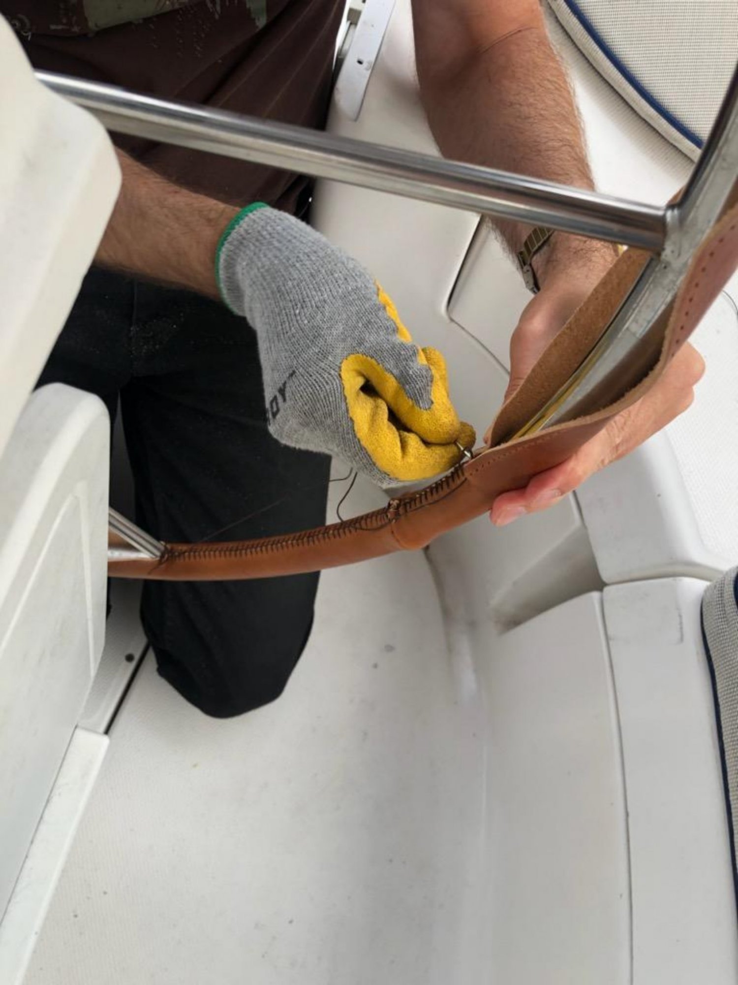

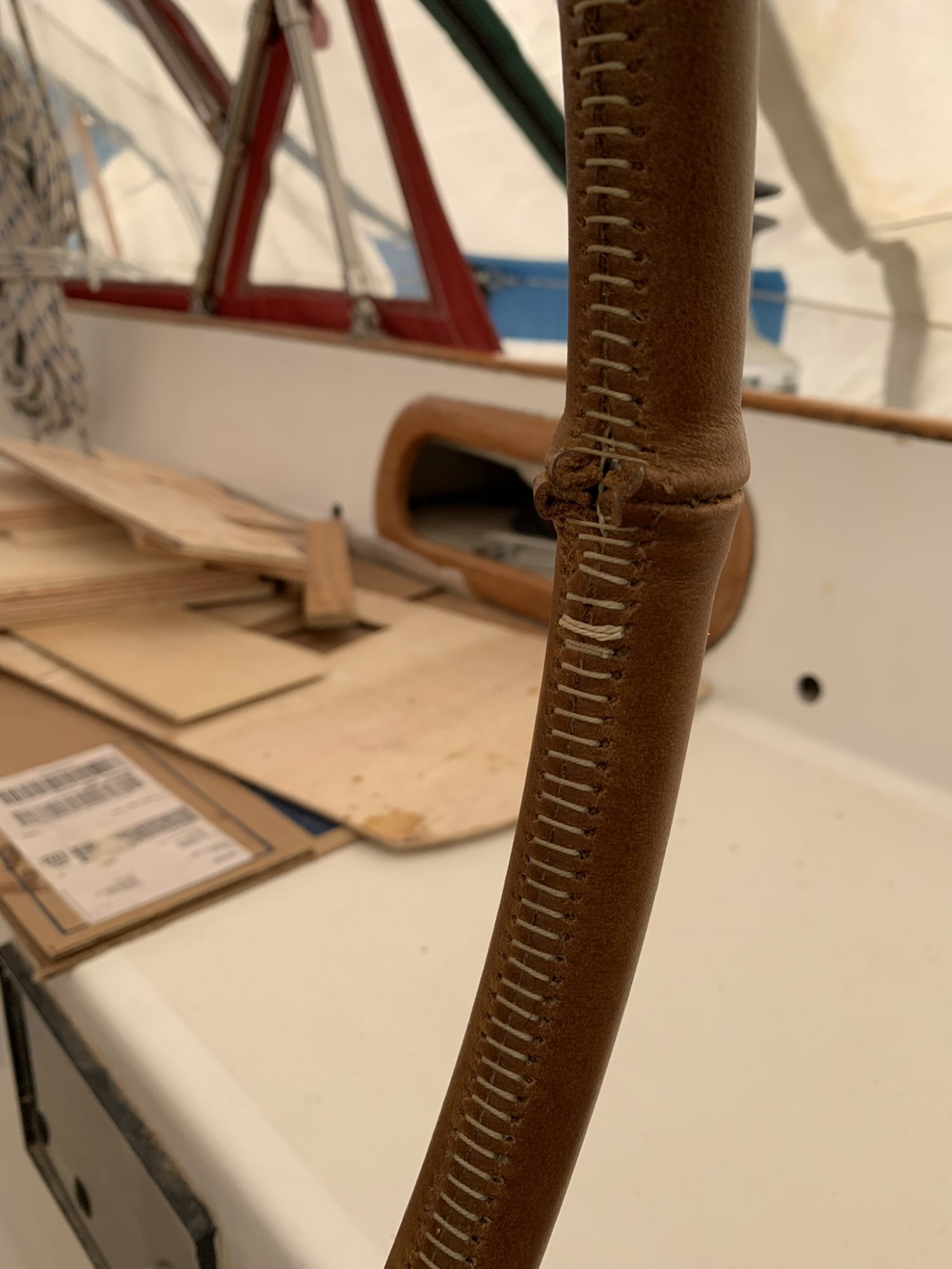

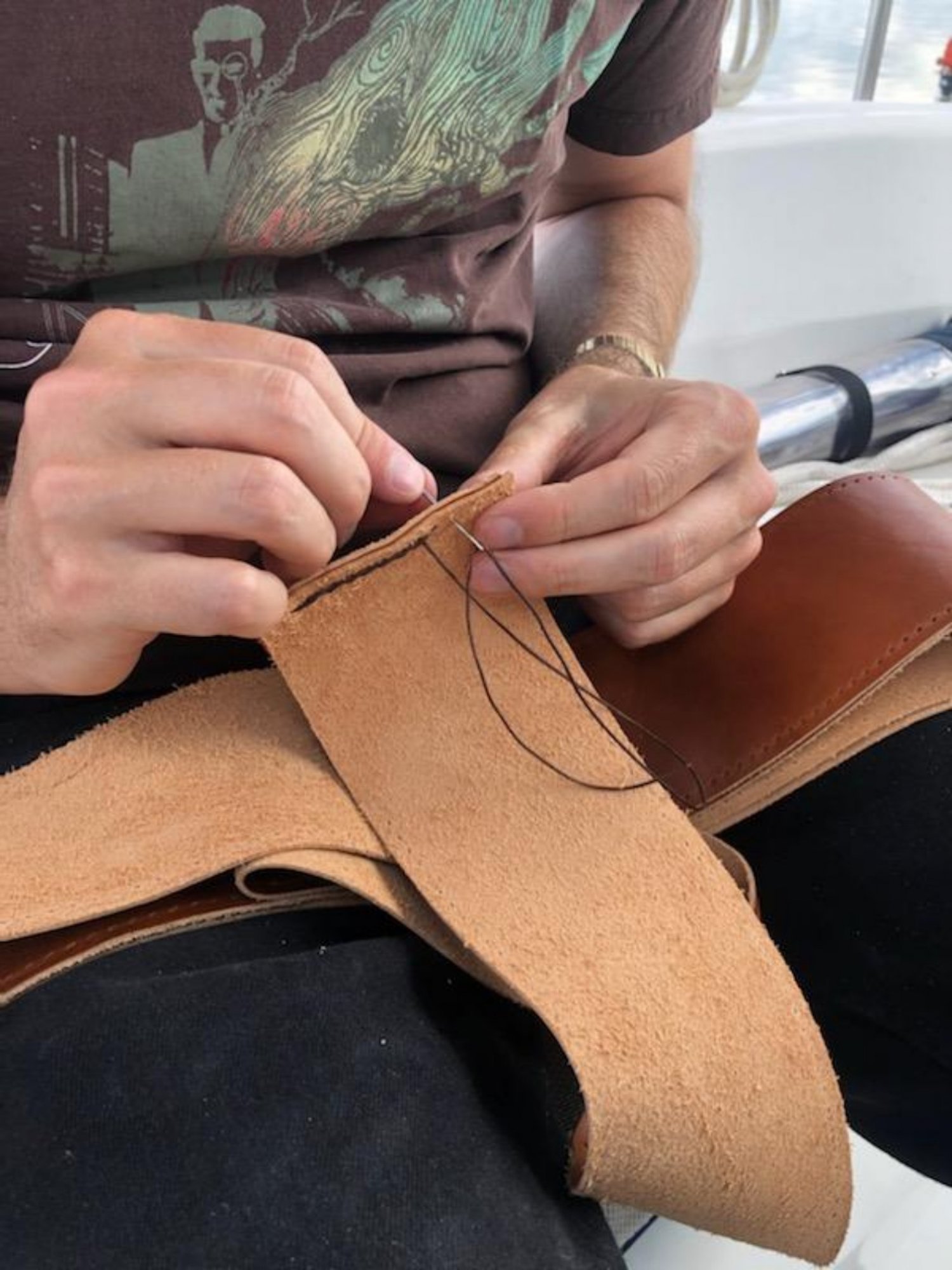

1) Because I was focused on keeping the entire project budget under $60, I purchased a piece of leather for $30 that could be cut into four 3" x 24" strips -- which could wrap our 1" tubing around its 88" circumference. Next time, I would probably splurge on a larger piece of leather, because although it wrapped perfectly around the stainless tubing, the leather was not wide enough to completely wrap the tubing at the seams (because of the added thickness of the double layers) -- and there are four seams. (See picture below).
2) Also with a larger piece of leather next time, I would wrap the wheel in foam padding prior to applying the leather.
