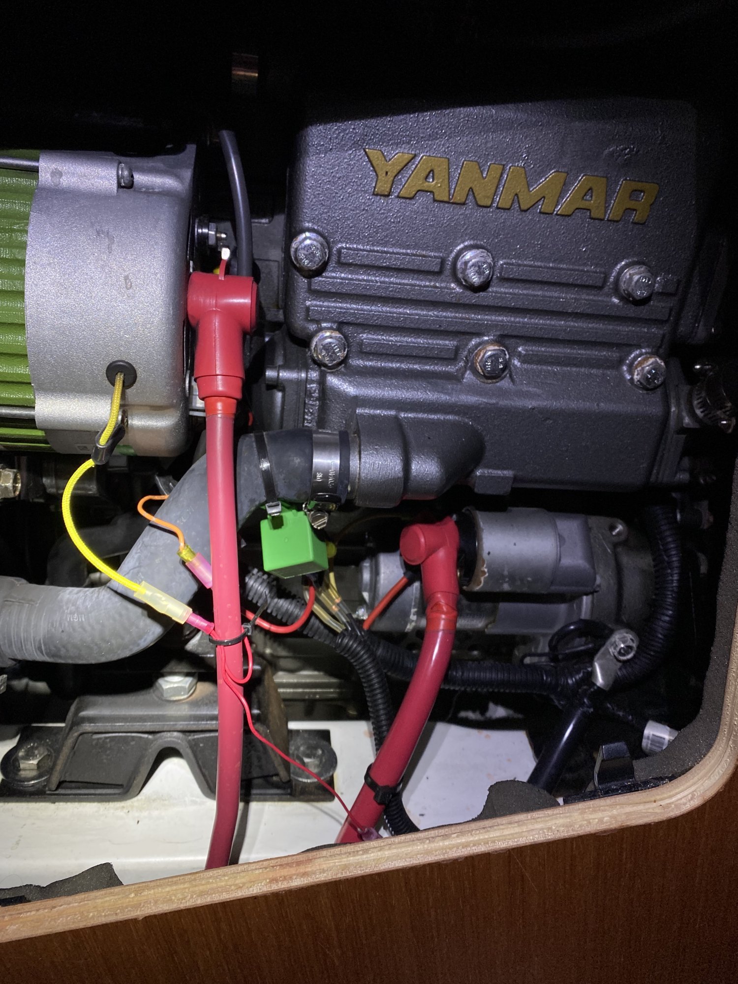

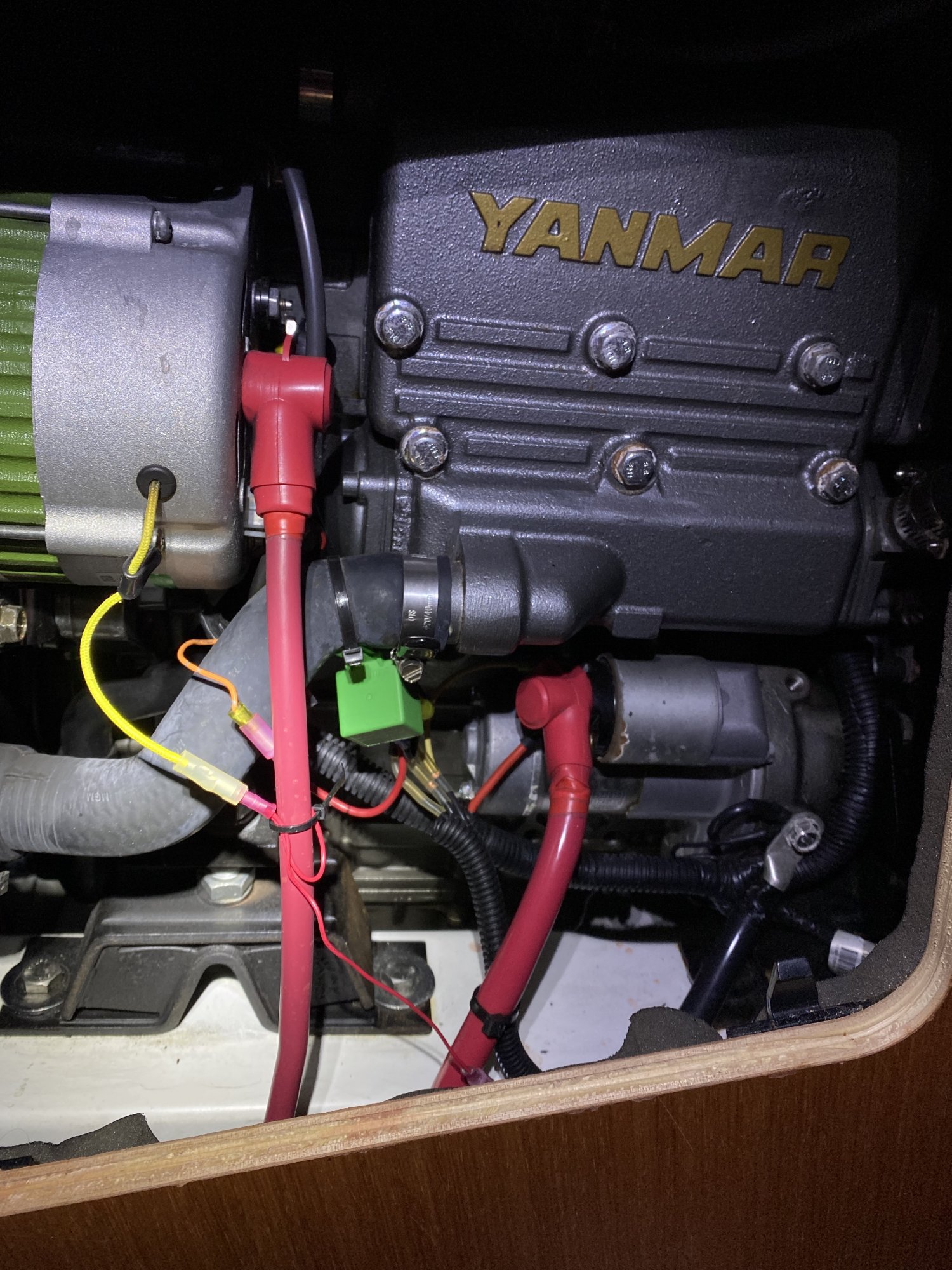

What wire should I tap for RPM?
May 17, 2004
6,117
On my Yanmar with Hitachi alternator there’s a yellow wire off the side of the alternator housing that provides the tach signal.
The signal off that wire is a square wave between 0V and alternator output. I put that through an option-isolator and count the pulses as interrupts per second with a Pico microcontroller.
Likes: jviss
