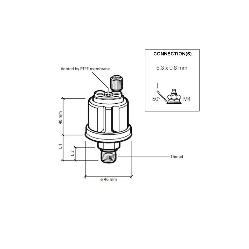

It comes with a brief manual and is pretty straight forward. The only real difficulty was getting the right dip switch setting for the ratio you need, and that . You do need to add sensors to the engine for coolant temp and oil pressure. many engines only have coolant switch and oil pressure switch to activate a buzzer. There are usually extra ports in the engine to add these but you need to understand the thread before you buy and make sure the sensor you buy has the right resistance - this was some of the negative feedback. I have the sensors I used listed below:
Temperature Sender
VDO 323-900 Temperature Sender Kit
Pressure sender
VDO Pressure sender 0-10 Bar
I bought the one we used from Aliexpress: https://www.aliexpress.us/item/3256802449243272.html currently $79.20
Likes: jviss
Temperature Sender
Pressure sender
I just ordered one of these. I had forgotten your note about sensor resistance range; the one I got is 0-190Ω. I hope it works out! The US-based eBay seller made me an offer for $75, so I couldn't resist. We'll see.
