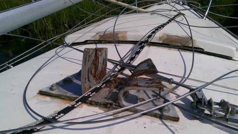

It seems I went out in a little more wind than my '76 O'Day 22 could handle, and ended up dismasted. Fortunately, with three young men on board, we were able to easily retrieve the mast out of the water, noone was hurt, and noone was in danger of much more than getting wet. We strapped the mast to the deck, dropped the anchor for an hour or so to regain composure and to ride out the wind. When the wind eased a little, we limped back to the marina. Once safely tied in my slip, I surveyed the damage. Besides my ego, the major damage includes the port chainplate ripped from the deck, and the mast step horribly mangled (see pics). The ruler is difficult to read, but the damaged area is about 3" square, and the crack is about 8" long

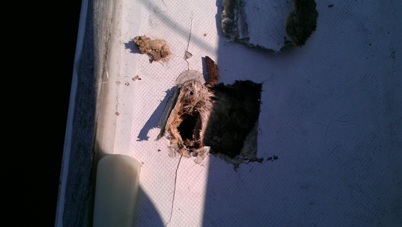

With the chainplate removed, and a piece of the deck with it, the root cause of the weakness has shown its ugly face - the wood core has practically rotted down to pulp. I am left wondering - what is the best way to repair the damage? Can it be repaired? I understand that you can cut off the top layer of fiberglass, lay new wood, and re-glass the deck. But what if the rot has spread too far? The boat is 36 years old. In theory, the rot could have spread throughout the entire deck. What do I do then? Can it be repaired in pieces? Is the boat even worth salvaging in this extreme case?

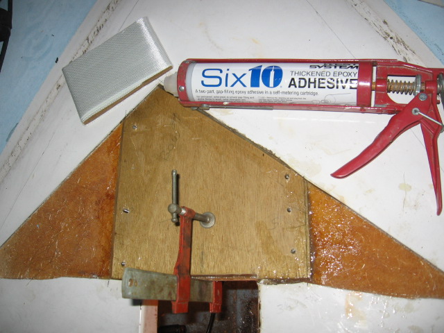

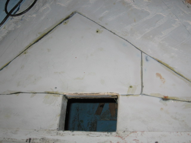

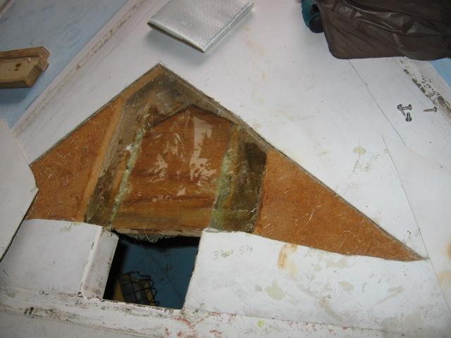

Hello Brian, Thankfully, you said no one was hurt. This situation presents a perfect opportunity to learn to repair hull damage or improve any skills you already have. It seems to be a case of "you can't make it any worse" since the boat is unusable as it is.
The small backer plates on the shroud in the last picture certainly contributed to the failure. Replacing them with much larger ones would be easy. Also, this is a good example of why regular maintenance is a very important process. Two reminders for all of us.
Using one of the Fein Multimaster knockoff tools will cut a small kerf that can be filled with epoxy and covered with paint that has had the nonskid material added to it. I'll add some pics of a deck repair we did following a dismasting that occurred before we bought our boat.

There is a reasonable chance that the rot is limited to a fairly small area. I would drill small holes from the underside (will show less) to find the extent of the rot. While you're at it, check under the mast step and at any other place that hardware penetrates the deck.
And while there's no doubt you have to make a strong repair for the chainplate, many boats sail for decades with rot in their deck cores - as your's probably has. Don't give up on the boat.

Its clear in the picture the PO of the boat did a bunch of wile e coyote quality work starting with the now bent and rusting mild steel mast step and one shroud toggle sure looks bent
It can be fixed with a bit of money and a good amount of time and i would have to think the other chainplate is sitting in rotted wood and should be addressed to avoid a repeat
