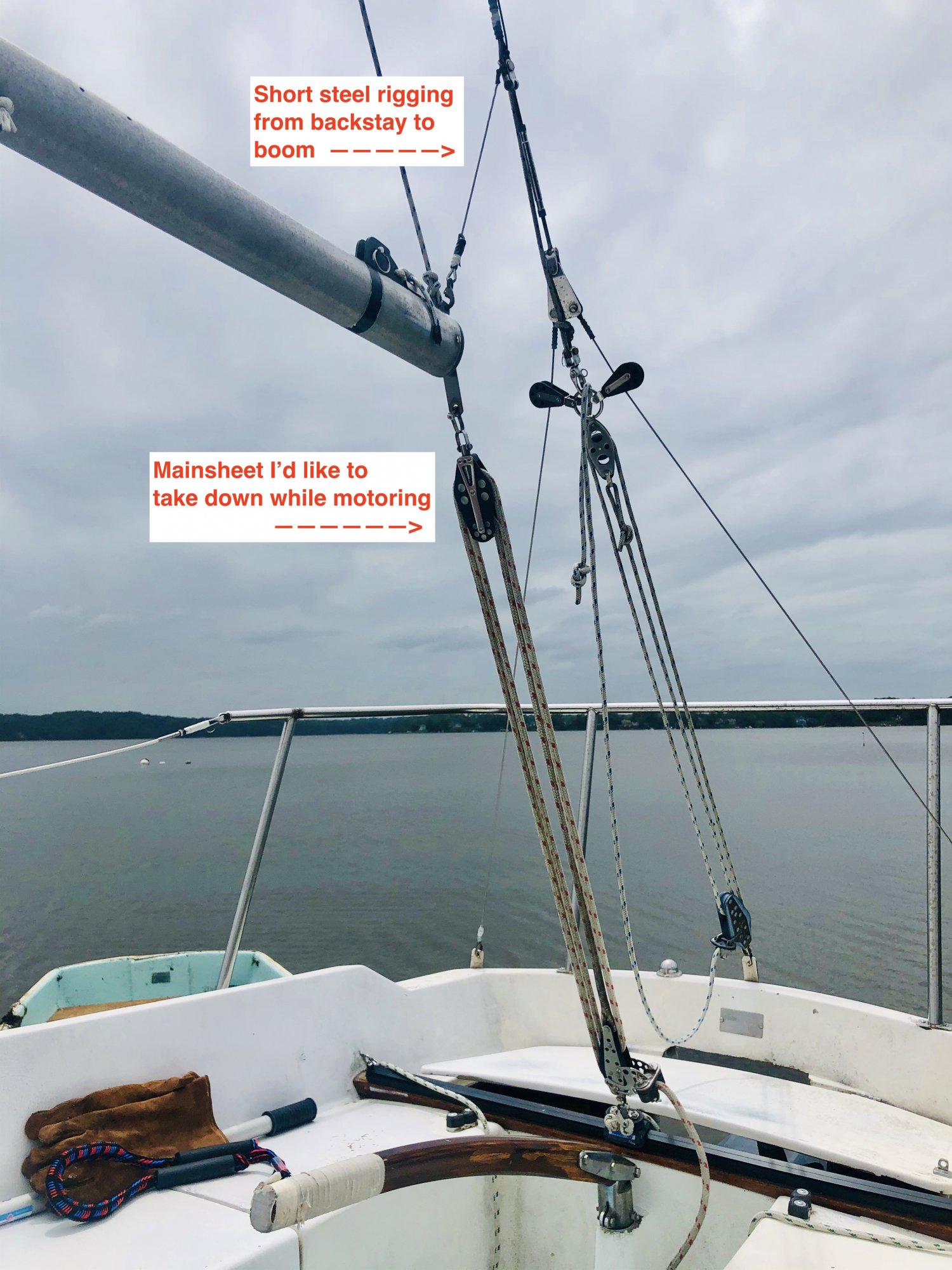

Hi all, new sailor here, so first, thank you for any insights. Taking all the help I can get and trying to learn. I acquired an old '74 Catalina 27 over the winter. Been working on her all spring and now have been out a few times with the wife and young daughter. We would like to install a Bimini on the boat to give shade in the cockpit, however at the stern side of the boat the rigging is a bit different than many other boats I've seen / been on. Please see photo.
The mainsheet on this boat connects to the boom about 2/3 of the way toward the stern side of the cockpit. So a Bimini is going to bump into that and not be able to cover the latter 1/3 of the stern. So, my question relates to using the Bimini while motoring. Would it be possible to remove/take down the mainsheet during motoring? This would allow that to clear out of the way (vertically) so that my Bimini could go further back toward the stern and cover the cockpit. Bimini would hit right at the back stays.
My thinking is I could set the Bimini up on track slides so that when sailing (mainsheet in use) I could have it at least cover the 2/3 of the cockpit up to where it would hit the mainsheet. But then if I can take the mainsheet down when motoring, I could slide the Bimini back to cover the stern final 1/3 of the cockpit, giving shade to all of the passengers (including the captain).
There IS a short steel line connected from the boom to the backstay on this boat. I assume that comes off while sailing, obviously, but I'm hoping it could keep the Boom held up and in place if I wanted and am able to take the mainsheet down during motoring, for the purpose of moving the Bimini back as described above. I'd need to figure out some kind of quick connect way to get mainsheet off easily for motoring and back on easily for sailing.
Any help would be appreciated! Many thanks
Yes. Should be easy. Just remove the top shackle that attaches the main sheet to the tang on the boom and replace it with a snap shackle.
Just be sure to get one that will take the load when sailing.
The wire from the back stay to the boom is a topping lift and should support the boom just fine. And yes, that comes off when you have the main sail up.

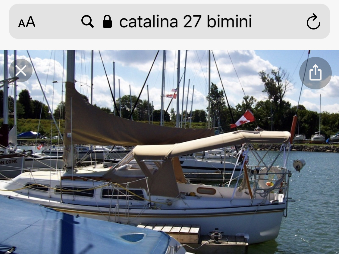

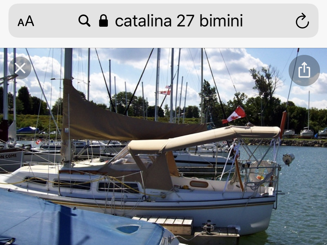

This one looks like it covers full cockpit
Hard to see where the mainsheet is here, but this setup consists of a dodger and a small , short bimini located over the aft end of the cockpit, with a connecting piece between the two. The connecting piece would be removed if sailing. I expect the bimini is as sort as it is due to the mainsheet location as with the OP boat.

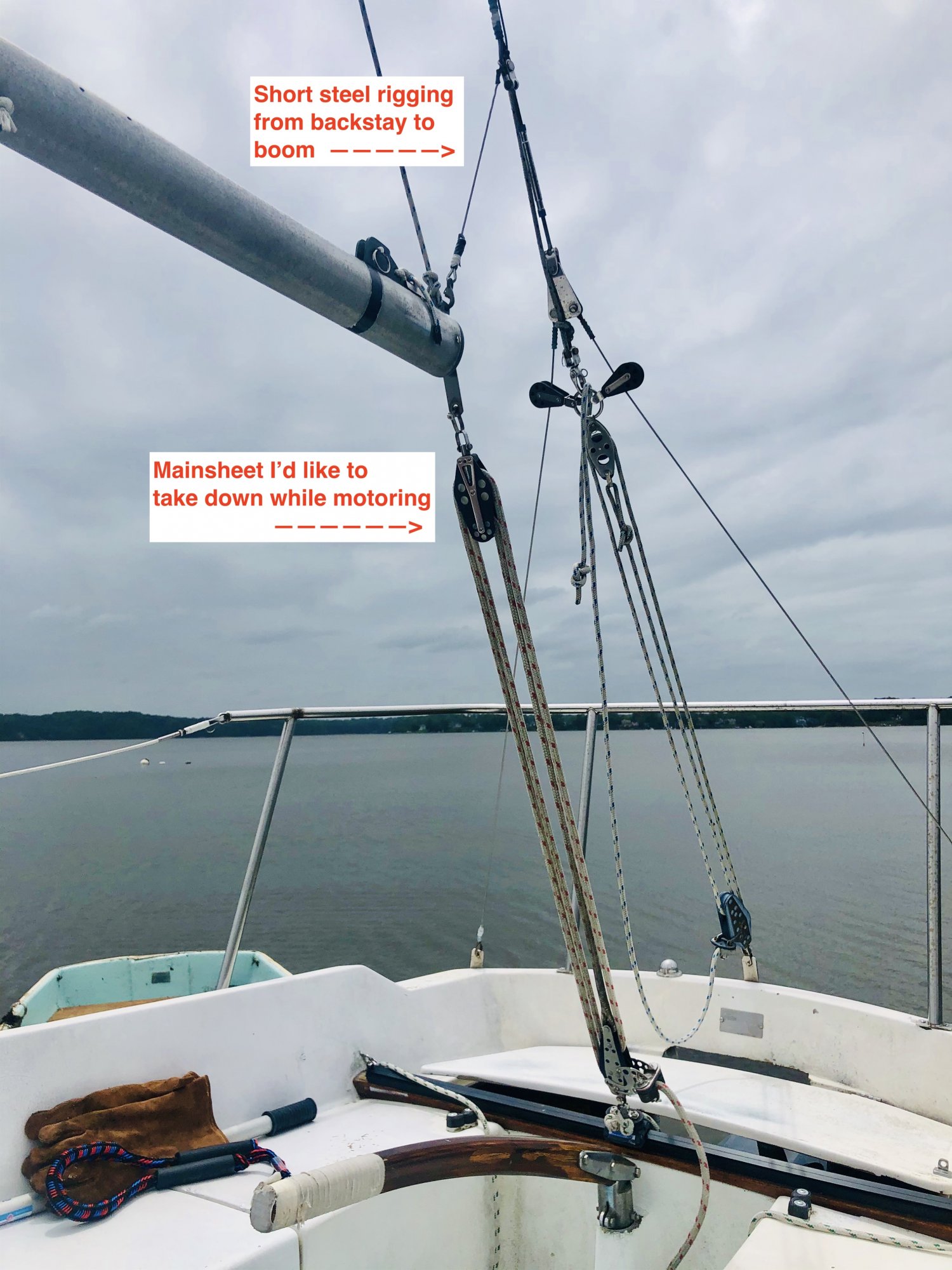

I’m not sure the cable is the topping lift as there is something else that is angled upwards towards the mast. Perhaps the wire coupled with a little tension on the mainsheet keeps the boom from flopping around.
If that is how the wire works in conjunction with the mainsheet then removing the main would defeat its purpose.
Even with the main sail down the boom is going to catch some wind when motoring. If the boom is slopping side to side because nothing is holding it still that wouldn’t be good IMHO.
How much play is there in the boom swinging with the cable attached?

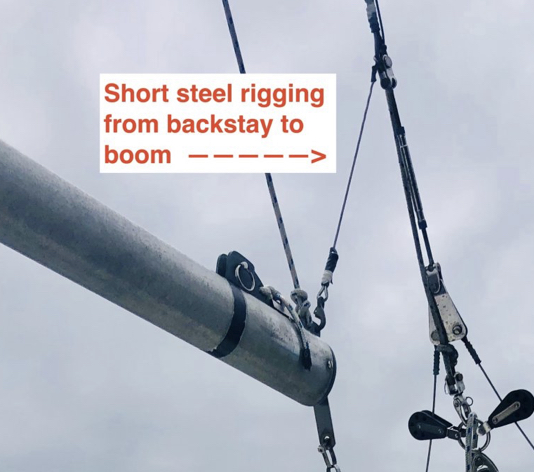

That's not a topping lift... it's the pig tail and it's only purpose is to hold up the boom when the sail is down... period. Don't use it at all if you have the sail up. The topping lift holds the back of the boom up when sailing... and it is usually adjustable …. which you'll soon learn why when you go out sailing.
As far as disconnecting the mainsheet... only with the sail down... all you need is an easier opening shackle that the screw type. You can splurge on a pricey snap shackle... or use a more reasonably priced halyard shackle... it'll have a levered, notched pin to open and close.
Okay... please don't get riled when I offer you this piece of advice.... I've owned my C27 for 21 years... and the boom connection for the mainsheet is probably one of its weak points.. in that the swinging motion can (and has, in my case) work the bolt loose in the end cap....and disconnect the mainsheet from the spar entirely.... Ooopss!!! So... what most of the other C27 guys I know do is LASH the shackle directly to the boom as a backup connection with a length of polyester webbing. In fact, you'll see many race yachts do that... just for the reason I mentioned. For that reason... I would not make the mainsheet so easily detachable on the C27.
This means that you can make the Bimini extend to just in front of the mainsheet below the boom. And if you want shade on the stern rail... add another small one, or rig an umbrella. I honestly think you'll be better off with the Bimini extending over the hatchway... like a dodger... because you'll be able to keep the interior open and shady and even drier.. I just don't think that extra 2 feet behind the boom is going to make a lot of difference... you haven't even taken the boat out yet... so how can you know what you'll need....
I was on the verge of pointing that out myself.:thumbup: But I think a topping lift is redundant if there is a pig tail. A fully-hoisted mainsail keeps the boom suspended while sailing.

Not t to be argumentative, but it is a topping lift. Although maybe useful for sail trim a topping lift doesn't need to be adjustable. A topping lift holds the end of the boom up. That is what a "pig tail" does. So a pig tail is a topping lift.
"The main purpose of the Topping Lift is to hold the boom up when the sail is not raised."
" topping lifts are primarily used to hold a boom up when the sail is lowered. "
