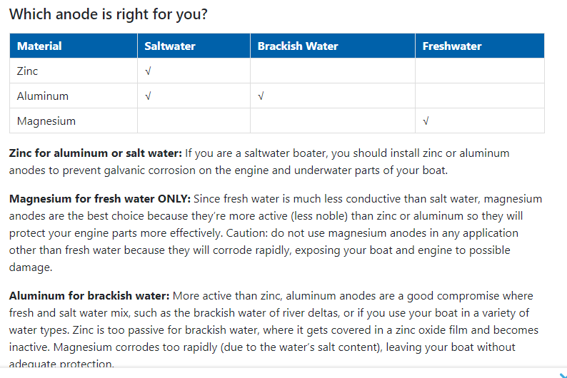

You should use magnesium based anodes for fresh water. Here's an excerpt from West Marine:
14,189
With all due respect for the WM advisor, I'll take Steve D'Antonio's advice over theirs. And it may not be as simple the water the boat is in, hull material and whether the boat has galvanic protection is also a factor. The folks over at BoatZincs.Com know corrosion and anodes. I've spoken with them a couple of times about a steel sailing vessel I've worked on. I trust their opinion and products.
