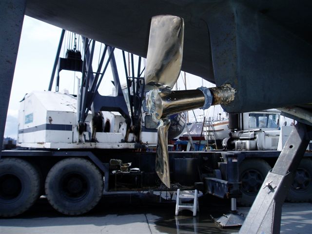

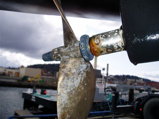

No, but I can take a picture next time I'm checking the boat at our marina
The top picture is Ron20324's boat with a Gori prop replacing the OEM.. The bottom picture is not mine, as i don't recall using both zincs at the same time. You can see the longer zinc bolts that can be bent to prevent unscrewing. The bottom pic might be the wider/not to be used zinc. The wider one will block water outflow from the cutlass bearing.

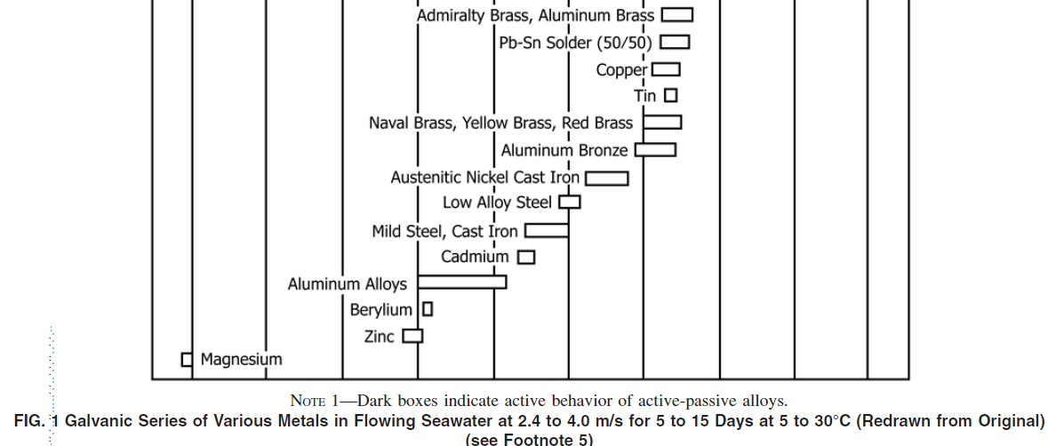

Aluminum would wear away even quicker than zinc, wouldn't it?
It's not a simple answer. However, based upon the galvanic series as published in ASTM G82, zinc will likely go before aluminum. Here's a snapshot (for more details, pick up a copy of ASTM G82):
The further left you go on this chart, the more "active" a metal is. the further right, the more "passive" the metal is. Active metals protect passive metals. so as you can see, zinc tends to be further left than aluminum alloys. things get more complicated than this however, as oxides, the corrosion product of the metals participating, enters into the equation often changing this more idealized chart - that is very much the case for the aluminum alloys...
Sacrificial anodes are produced with complex formulas that are not necessarily made from just one of the alloys listed above. Anodes that work best in fresh water are not the same alloy as anodes that work best in sea water.
Stainless steels are notable in that they have both passive and active states.
It's complicated... :cool:
